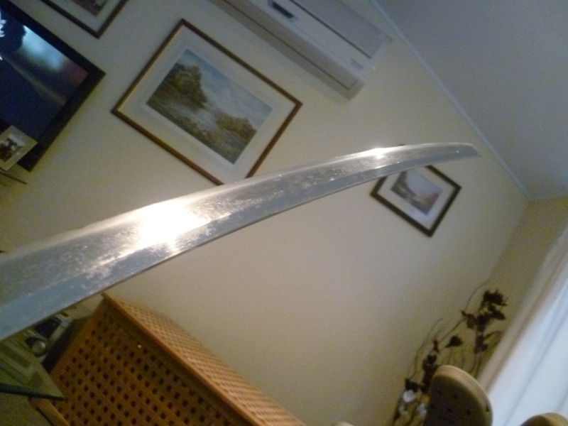

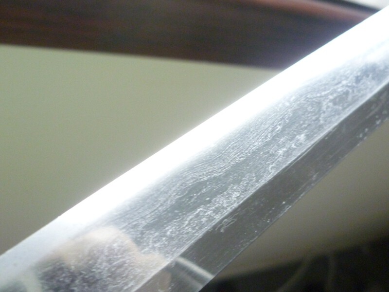

werner Posted December 1, 2010 Report Share Posted December 1, 2010 Hi Folks, Please give me your opinion on this one....got it quite cheap and could only take the tsuka off after the deal was done....close to tears after I discovered the nakago.... Sori: 17mm Nakago: 190mm Kissaki: 30mm Cutting edge: 710mm thickness at habaki: 7mm thickness at yokoto: 4.5mm width at habaki: 29mm width at yokote: 20mm total length of blade: 900mm It comes with a double habaki and doesn't look polished down - habaki sits perfectly. No flaws such as hagire etc only 1 invisible nail catcher.. May I use this opportunity to ask the following: I came across swords with 8/9/10mm thickness at the habaki....does this mean that 7mm or 6mm thick blades have been polished down or have swords been made 5/6/7mm thick? As you can see in the pics...some no-brainer took almost 35% of the patina away to fit it into cheap cheap cheap koshirae... Thanks for your opinion and feedback.. Jock Link to comment Share on other sites More sharing options...

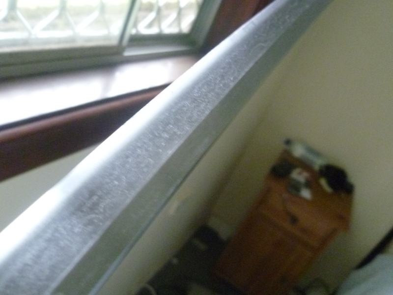

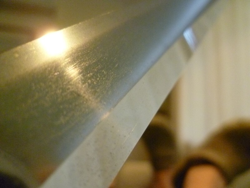

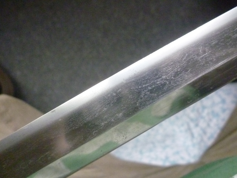

werner Posted December 1, 2010 Author Report Share Posted December 1, 2010 ...more.. Link to comment Share on other sites More sharing options...

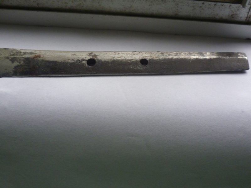

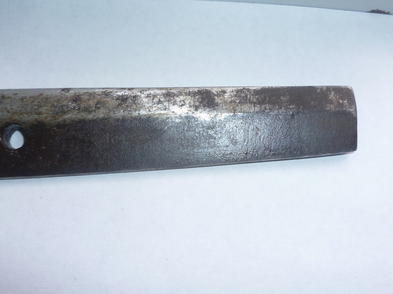

werner Posted December 1, 2010 Author Report Share Posted December 1, 2010 ...more....sorry noticed I posted the nakago pic 2x Thanks ..... Jock Link to comment Share on other sites More sharing options...
werner Posted December 1, 2010 Author Report Share Posted December 1, 2010 ... I guess filing down a nakago to fit it into cheap (or any for this matter) koshirae is the same as amputating your kids toes to fit his/her feet into cheap shoes....pictorial spoken if I may... Jock Link to comment Share on other sites More sharing options...
nagamaki - Franco Posted December 1, 2010 Report Share Posted December 1, 2010 IMHO, this sword looks to have been mistreated with acid making the nakago the least of its problems. Link to comment Share on other sites More sharing options...
Ken-Hawaii Posted December 1, 2010 Report Share Posted December 1, 2010 My guess is sandpaper, followed by file, with acid as the final insult to the blade. If you can get your money back, Jock, I suggest you do so. Link to comment Share on other sites More sharing options...
werner Posted December 1, 2010 Author Report Share Posted December 1, 2010 ...what are the effects of acid? And what makes you conclude that acid was used? Thanks for the feedback.. Jock Link to comment Share on other sites More sharing options...
drdata Posted December 2, 2010 Report Share Posted December 2, 2010 As to acid, I believe it eats aways the softer metal helping to expose the layers. Making the hada pop out. Regards Link to comment Share on other sites More sharing options...
JamesH Posted December 3, 2010 Report Share Posted December 3, 2010 The use of acid by togishi was briefly discussed a few months back with an example of a nihonto where ji-hada was brought up by acid, and then after a professional polish. The pics of the blade worked over by acid, showed obvious unnatural looking ji with excessive but bland ji-hada showing... something I did not notice on this blade. I could not find the thread for the life of me, but I also remember a quote that "many professional togishi use mild acids during the polishing process, however when it is done by a highly-skilled professional, you would never suspect that any form of acid has been used." To my knowledge, a few processes in the traditional final polishing stages are partially chemical, such as jizhuya and nugui, but I was hoping someone could elaborate on this. James Link to comment Share on other sites More sharing options...
Surfson Posted December 3, 2010 Report Share Posted December 3, 2010 Looks a bit tired too - I think I see a lot of shintetsu in a couple of the photos. Link to comment Share on other sites More sharing options...

JamesH Posted December 3, 2010 Report Share Posted December 3, 2010 Jamie, When I mentioned that are few of the final traditional polishing processes are chemical, I did not mean that chemicals were added, although nugui does in part consist of iron oxide. I cannot remember where I exactly I read it, but the whitening of the hamon during the hadori stage is not only due to very very fine 'polishing/scratching' by the hazuya stone, but also due to a chemical reaction which occurs when the uchigomori particles rub against each other and the steel.... I am not a togishi, and cannot say any of these things for certain, which is why I was hoping some of the more knowledgeable members may clear up the mist. Also with nugui, I am quite sure the darkening/blueish hue achieved is also achieved by a chemical reaction between iron oxide (+ the other ingredients) and the steel. Again perhaps a togishi might clarify exactly what happens here. James Link to comment Share on other sites More sharing options...

loui Posted December 7, 2010 Report Share Posted December 7, 2010 I'll agree that the nakago has been messed up pretty badly but it is possible to "fix" it somewhat, some reshaping and patination will help it, a mishaped nakago does not write a blade off but of course it has an effect on the value and possible attribution. The jigane looks like it has been worked over my a process that I won't elaborate on because I abhor it, not acid but used to bring out the jigane - but I could be wrong. In any event it can still be polished, best not to write something off over internet pictures, have a polisher look at it and see what he can do. Regards, Louis Link to comment Share on other sites More sharing options...

Marius Posted December 8, 2010 Report Share Posted December 8, 2010 Hi Folks, As you can see in the pics...some no-brainer took almost 35% of the patina away to fit it into cheap cheap cheap koshirae... Thanks for your opinion and feedback.. Jock, I am really sorry for you, believe me, I am. But, what on earth have you expected from a purchase of a sword in cheap koshirae, out of polish and with a tsuka that could not be removed? I know it didn't cost a lot of money, but still... Link to comment Share on other sites More sharing options...
