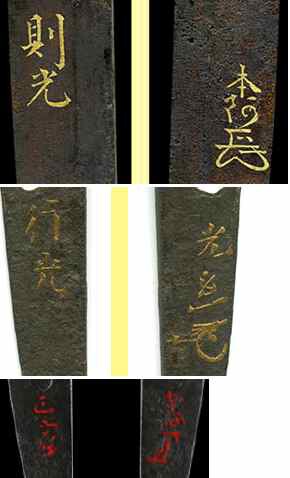

1 - HONAMI KOKAN - Kinzogan mei
2 - HONAMI KOSON - Kinpun-mei
3 - HONAMI KOYU - Shu-mei
All have been affirmed by NBTHK and given Juyo Token.
Eric
