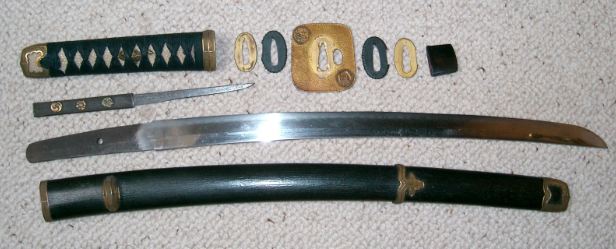

Diego, I think Guido is on the right lines for your sword, the fittings seem to be of a type quite often encountered as handachi mounts, it is a relatively simple task to acquire a pair of hangers and convert a handachi koshirae into a "tachi".  This may or may not be what has happened to your sword, you have it in hand and will be able to see much more clearly than we can from images.  I will attach a picture of one of mine to illustrate the thought.

Ok i don't think so Guido and can you explain why the ashi doesn't mach with other fittings?
Without explanation our knowledge does not advance.
The fittings are of the same generic type we find so often on late Edo period koshirae; here's a thread that discusses them: http://www.militaria.co.za/nmb/topic/12450-higo-koshirae
The ashikanagu look like they are of a different material and design. The photo is not ver clear, that's why I wrote "seem" in my original reply. You have the sword in hand, only you can tell for sure. There's nothing I can "explain", they are either a match or not.
The fittings doesn't match?
Again, better photos would be helpful. But from what I can see in the pictures, the ashikanagu are of a different design and surface pattern (ishimeji) than the other fittings (nanakoji).
No need to get defensive, Diego. As you yourself said before, no advancement in knowledge without an educated discussion. Your koshirae might not receive jūyō papers, but it's also nothing to be ashamed of. Not only have I seen much less desirable koshirae, it also was not uncommon for period koshirae to have fittings that are not perfectly matched (however, I suspect that yours is a contemporary assembly).
If I was in your shoes, I would either remove one ashikanagu; or preferably remove both, and have a kurigata installed - then it's a very decent handachi. Or you could look for obitori and a tachi-tsuba - which is more difficult, costs you more, and also might look kind of awkward.

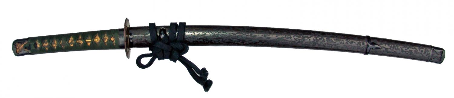

But that's just my opinion, your mileage my vary. It's worth what I charge for it. Attached are pics of both a tachi and handachi from my collection to illustrate my point. Both are not jūyō material either, but follow the (unwritten) rules of proper mountings.
Thank you for your words Guido, i was on defensive because i don't want to seem an occasional collector...i am a real estimator of these gorgeous sword. The koshirae was restored some years ago...maybe the other owner add only the ashi,i don't know, but i'm scared about removing them, i don't know how he assembled the ashi.
They are probably just held in place by friction. Anyhow, if you are going for a kurigata instead - and don't want to send the saya outside the EU (as long as it still exists) - I recommend having Zenon van Damme doing the work.

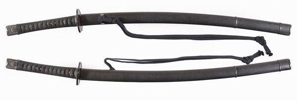

Here (better late ...) is a somewhat unusual daisho set of koshirae in handachi style.  The saya and all the metal fittings (except menuki) are wrapped in leather.  The tsuka has leather instead of same, and the tsuba are nerikawa-ish leather.  There is a lot of wear on the kashira and kojiri which has worn away the leather and you can see the underlying metal which is copper.  These came from a well-known Japanese dealer who opined "early Edo."
I'd love to know if anyone has seen similar koshirae?

They must have been made together as a pair. The construction is unusual, practical, not sumptuous but likely special-order. They show a good deal of wear as you can see in the photos. I have no idea what kind of blades they held, but likely not of the highest grade.
To me, they represent my limited understanding of the untranslatable term sabi:  old, worn, and despite this -- or because of this -- beautiful.
