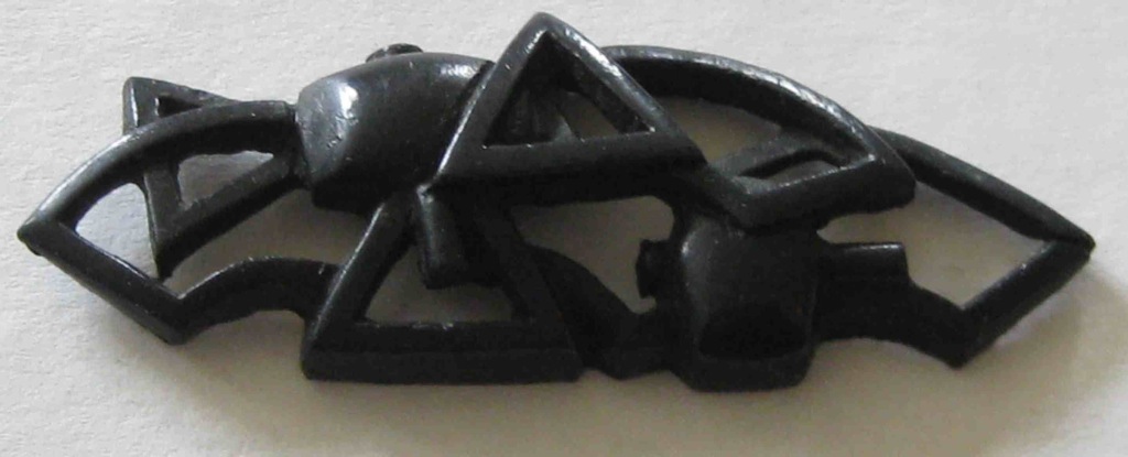

Labelled as Kakeya Rangaku -
Which I would translate as "wood-mallet rangaku" or wood-mallet and fence or a fence of wooden mallets? Not sure exactly but I like the idea of a pile of stakes and mallets as a barricade. A Rangaku btw is a type of castle defense, a barricade made by driving stakes into the bottom of a shallow moat and then tying a stout rope to them in a random pattern. Meant to trip up men and horses as they assault the castle walls.
While I appreciate Goto artistry, I have never much cared for their works mostly because of their subject choices. However when I saw this set I fell in love with it because of the unusual subject and the deep black of the shakudo. (sorry the photos do not do them justice)
I was only able to find one other depiction of this subject and it too was early Goto work. Hows this for rare?
