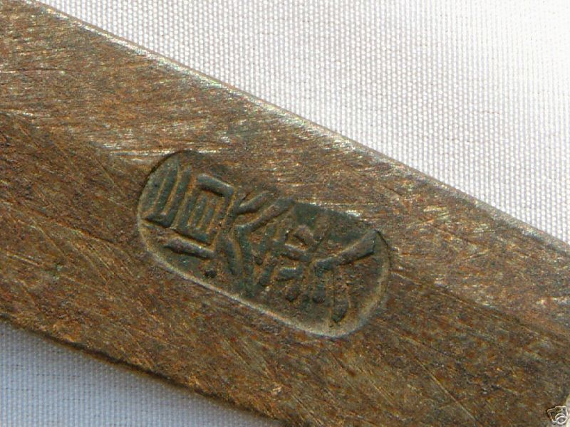

Hmmm...first time I have seen the "ren" stamp...does anyone know the significance?
Just on the Shinsa points discussed above...I have never seen an oil-tempered RJT blade either, but as Chris says, there is the possibility of one popping up. However, as my translation of the requirements of the RJT inspection system show...this should not happen...if it does then it is a fraud on the RJT rules....or a fake star stamp on a non-RJT blade.

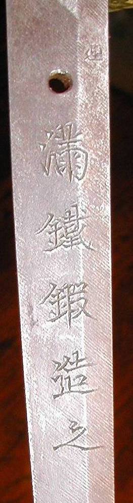

Just referring to the "Ren" stamp above...I just read on Ohmura's site about Mantetsu blades...the "ren" stamp is that of the Nanman Arsenal Dalian Factory...in Manchuria. These have no "Ko A Isshin" mei.
see http://www.k3.dion.ne.jp/~j-gunto/gunto_149.htm at very bottom of article.

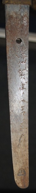

(top right) Tai(sha) stamp and appears on late war blades made by smiths associated with the Izumo Seiko steel works. Located In Shimane. The forge was located near the Izumo Taisha shrine and by 1945 the country was in dire need of divine assitance, hence the Tai or Dai stamp on some blades to involk the spirits of the Taisha.
Brian

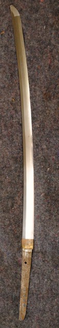

Dear NMB-ers,
To give this topic some new material for discussion....
I have found an artikel written by former chairman of the Dutch To-ken Society; Mr. Han Bing Siong.
It's mentioning a star stamped blade with the signature of;
Hizen Kuni Masatsugu
Koki Nisen Roppiaku San Nen Uzuki Kichi Jitsu
(On the Mune) Kogi
Lenght 66,1 cm
Shinogi Zukuri, ihorimune, mihaba hiroku, torii sori, chu kissaki nobiru.
Tighly forged ko-itame hada, wazukuni nagare, on omote some o-hada, ji nie, chikei, shirake, which becomes a vague bo-utsuri along a large part of the hamon.
The hamon is Sugu ko midare ko choji ha, ko ashi, some kinsuji, nioiguchi shizumu.
This blade was send to Japan for Shinsa and passed examination!!
I quote;
This smith is Taguchi Kiichi, born in 1904 and a pupil of KURIHARA AKIHIDE.
As from 1935 he worked in Karatsu in Saga-district of the former province of Hizen. He passed the army's examination for RUKIGUN JUMEI TOSHO in 1941 and was awarded a gold medal and the Minister of the Navy prize in 1939 and 1940.
After the war he participated in the swordsmith-contests of the Nippon Bijutsu Token Hozon Kyokai as from 1957 and won several prizes.
The nioiguchi shizumu is not accordance with the tradition style of the TADAYOSHI-School of Hizen. Its kitae as well is somewhat different. But as this smith was a pupil of KURIHARA AKIHIDE, he did not specialize in making swords in the TADAYOSHI-Style.
In view of the sword-characteristics as discribed above, this blade is clearly a hand forged sword. A star stamp like the one on this blade therefore does not necessarily indicate that the sword is an arsenal made sword.
A prerequisite for gendaito, however, is that the blades are both hand forged and made of tamahagane. Consequently, the question was, wether this sword was made of tamahagane from a tatara, or made of western factory made steel.
It has been pointed out by western metallurgists that western factory made steel cannot possible show any patterns after being folded many times. If so, then Japanese swords made of western steel would either only show loose patterns (due to the limited number of foldings) or justhave difficult to discern patterns.
As this sword has a tightly forged pattern in its steel, suggesting a manifold of foldings, the conclusion was that it would have been made of tamahagane.
But the question remained, why was it stamped with a star??
According to Mr. FULLER the star stamp was used on blades of unknown smiths. But this sword was forged in 1943, when this smith had allready appointed Rikugun Jumei Tosho. He therefor was no longer unknown to the authorities.
To obtain certainty for academic reasons the Netherlands Token Society sent this sword to Japan to be submitted to shinsa.
The sword passed the examination and recieved a Hozon Token Kanteisho No; 352362, dated Heisei 11-2-2.
This indicates that the sword's quatily was judged to be in accordance with the requirements for traditionally made Japanese swords. My judgement proved to be correct both as to the quality of this sword and as regards its authenticity.
In a personal communication, however, TANOBE MICIHIRO sensei affirmed to me, that the star stamp is certainly no guarantee that the sword concerned is equal in quality to the traditionally made Japanese swords. On the contrary, in general the stamp indicates that the sword concerned in one way or another may not be fully made in conformity with the traditionally prescribed procedure.
The late YOSHIKAWA KENTARO sensei informed me as well that swords with the star stampgenerally are "hantan" rather than "hontan" (Partially forged rather than truly forged) .
But of course exceptions do exist like in this case.
This whritting by Mr. Han Bing Siong can be found in;
Japanese swords in Dutch collections [page 147 56(No.326)
Rob Kauffman

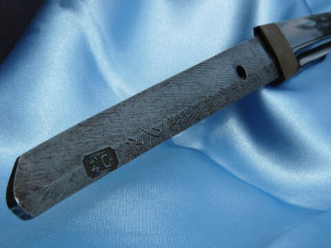

Yoshichika katana with REALLY Odd Stamp! Okay, someone explain this one to me...I recently acquired a sword made by Yoshichika, a good quality sword with a fine hamon and strong construction...Signed with a deep stamp at the tip of the nakago with what I believe is a helmet and the word WARRIOR in English!!! It resembles Pacman with a Mohawk!
What is interesting for the discussion in this thread however is the image Ford posted in the other thread :
file.php?id=24175
The comment states that the military ordered these stamps on all non traditional blades during the war.
Does any of you have that particular IJA directive or maybe a fascimile of it ?
