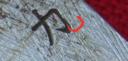

A little help on this one?
Thought I'd correct our discussion on this one. While it seemed it might be a "saka" stamp, I'm pretty sure now that it's the "Se", second inspection mark of the Kokura Arsenal
From Ohmura:
  Second Factory 廠Inspection mark Army Arsenal Kokura Second Factory inspection mark: "Se".SmartSelect_20190615-083644_Chrome.jpg

I don't recall seeing these stamps on this thread yet (if it is, please let me know and I'll delete this!)
From Alex, as seen for sale via the web, a contractor and inspector stamp on a Kokura Arsenal Type 95 gunto. As far as I can find, the contractor stamp is legit, but classed "Unknown". Any ideas on the inspector stamp? My guess is the "Ho" of Kokura 1st.
Sorry, but I have to ammend this, and it's too late to just edit the post:
Thanks to Guy over on Warrelics, the inspector stamp is simply a poorly struck "To", with the lower "legs" struck heavily, and the top half too lightly.

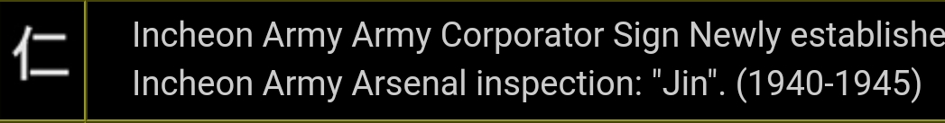

A first for me - an Incheon Army Arsenal "Jin" stamp on a Tokyo Arsenal Type 95!

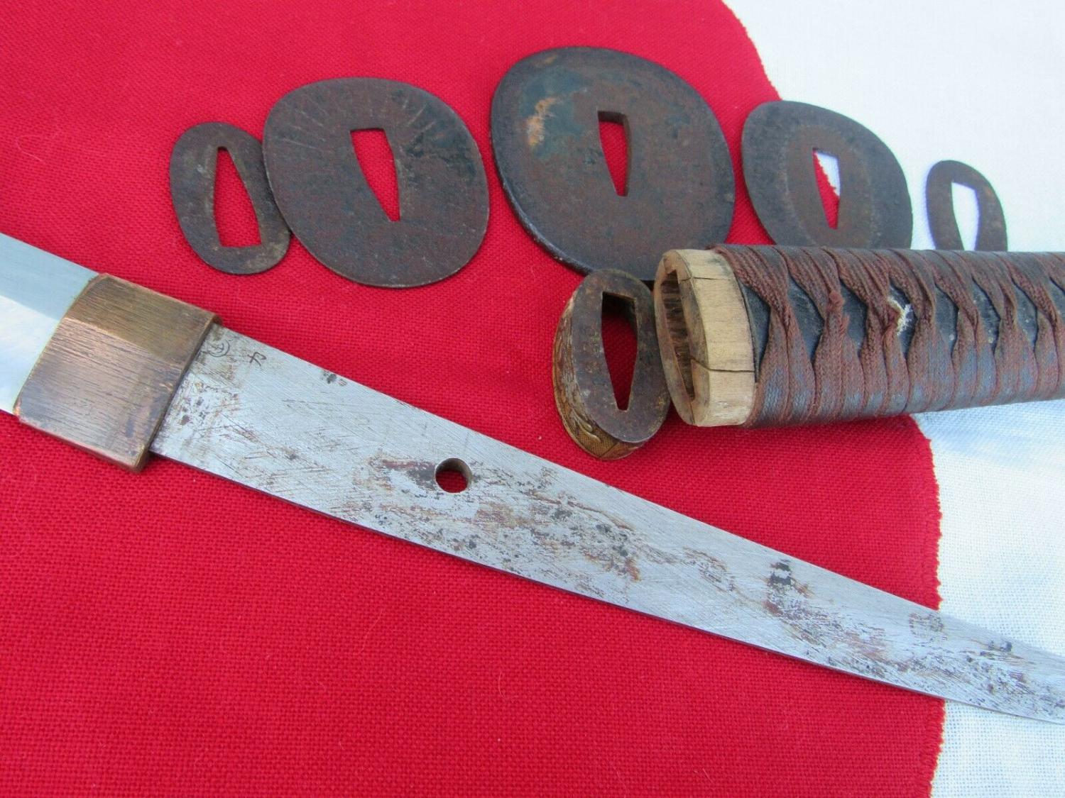

Hey Bruce , I pulled apart a 1938 '98, and found a stamp on the pierced tsuba. It is the Suya "harp" stamp. I guess this koshirae/sword came from the Suya Sword Shop?
I have never seen that before . It is a Yasukuni Shtine blade, so maybe you may know if this shop fitted out Yasukuni swords?

You tend to see the Suya stamp on many high quality Koshirae & swords, don't have the exact links but I recall seeing it on few Yasukuni and Type 94 swords over the years.
Here's one on a "Zohei-To" in early mounts typical of these swords: https://www.ebay.com...wYAAOSwBgVa9FjJ

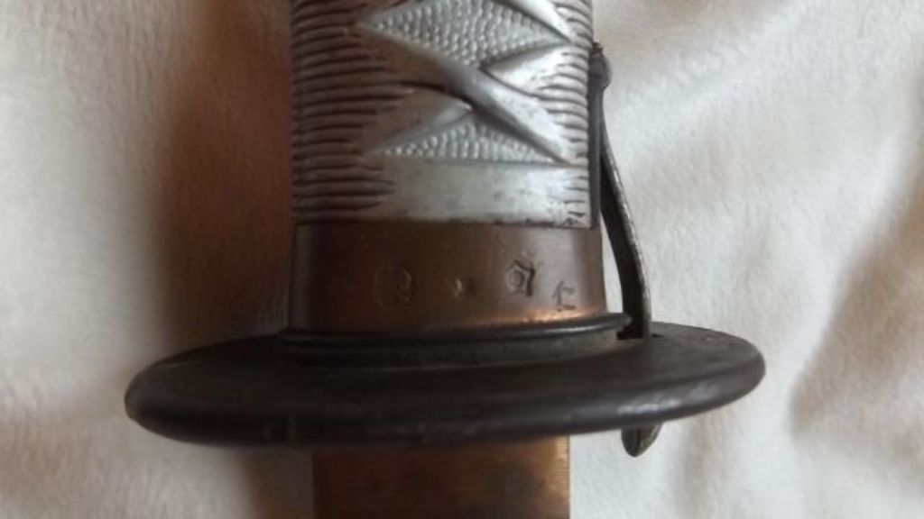

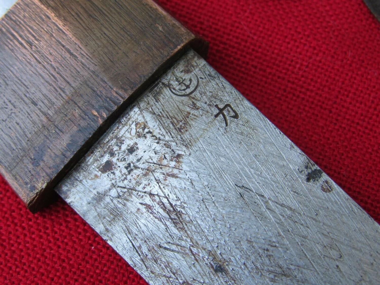

Something new coming to us from Neil (IJASWORDS): 3 stamps on the nakago mune of a Star-stamped Kanetoshi. The top, circled one is "Seki", but I can't find the other 2 anywhere.
In regards to the second kanji character 特, this is another one of those obscure Imperial Japanese Army inspection marks.  It can be used by any factory.  This inspection mark indicates special approval.
特 = TOKU
http://www.militaria...-11#entry243760

More nakago mune stamps.
Regards,
Hoanh
Another Japanese army inspection mark used by the Matsuyama Branch Office of Kokura Army Arsenal.
山 = yama
http://www.militaria...e-9#entry183735

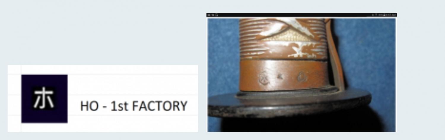

ホ = 1st Factory of Kokura Army Arsenal.
All the blades below have a second inspection mark that is the katakana character ホ HO stamped on the top of the blade tang.  This HO stamp is an inspection mark used by the 1st Factory of Kokura Army Arsenal.  Japanese army ordnance records confirm that the 1st Factory manufactured swords.  What I find interesting is that all the blades have different final inspection marks on them.  These include stamps from Kokura, Matsuyama, and Nagoya.  Could this indicate that the 1st Factory only made blades that were distributed to others for final fitting?
小 ホ = http://www.militaria...ge-1#entry57569
小 ホ = http://www.militaria...-11#entry223259
山 ホ = http://www.militaria...e-9#entry183735
名 ホ = http://www.militaria...e-8#entry143580
名 ホ = http:// www.militari...e-9#entry176662

Posted 20 September 2019 - 05:49 AM
You might as well add:
Thomas,
I don't doubt what you are saying, as you are uncovering an amazing amount of previously unknown info, critical info, to our collecting world; BUT it would be helpful to us all if you could expound, or provide some of the evidence of Kokura's 1st arsenal producing blades. We have been hearing from some pretty knowledgable people, for years, that Kokura was administrative oversight and didn't produce gunto. It would help to see some of the evidence you are reading (with English edits, like Nick Komiya does).
As a counter idea, though, I have always taken examples like you provided above, to mean that someone else made a blade, like Nagoya, and it's final inspection came by Kokura inspectors. For the first several years, Nagoya and Seki production was under Kokura supervision. It was somewhere around 1942ish that Kokura's role was decommissioned and Nagoya and Tokyo 1st took over.
