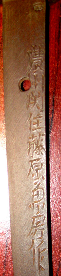

I am almost positive I have a Kanefusa 23rd blade that as it is stamped and has to be "non-traditional" however it has what I am sure is a water quenched appearance so it is must be the steel. :dunno:
I know Chris has stated and I know he is the man for these but I wish I could send this blade to him - others on the board have stated it sure as heck looks water quenched. I don't know maybe he made this one on his day off at home ! :freak:

One thing to look at is the mei-buri and the nakago finish. If the mei is poorly cut and the nakago poorly shaped and finished, it is usually not a blade made by a professionally trained smith and thus odds are it is not a traditionally made blade.
