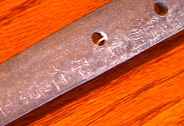

Hi guys,
I'm looking at a nice katana with good horimono but part of the inscription makes no sense to me. It tallies with the oshigata in Fujishiro 136-139 and looks pretty close to the big Kagemitsu's: KAG 54 and KAG 60, who was supposed to be good at horimono but I can't translate what looks like gatsu after osa(fu?) in the mei. The same character is there in Fujishiro for the big guys. All looks good unless it's a gimei, which it may well be, but the horimono and the mei seem to make it a pretty safe bet, sort of.
Would appreciate any opinion, as it's between this an another nice, mumei koto katana in koshirae with very similar horimono. At twice the price.
Thanks guys,
Dave
That's what one would think but I have had many Bizen Osafune blades and none of the second characters to Osafune looked like Gatsu. That part of the kanji for Osafune is usually dwarfed by the right hand side. Was this a characteristic of Kagemitsu? It's the same kanji in Koto hen for Kagemitsu.
It looks good, ironically, almost exactly the same construction as the sword I am alternating between, but if this is a genuine Bizen Kagemitsu, I would go for this.
The other is nice and the mounts complete but this is mounted as well and with a genuine Kagemitsu signature, at half the price, no comparison.
IF it is a genuine signature. I know 80% of famous signatures are supposed to e fakes, but this has the horimono Kagemitsu was famous for and the signatures look bloody close to those in Koto-Hen.
Thanks for your help. Does anybody have a genuine Kagemitsu? Seen one?
Would be greatly appreciative of any thoughts.
David.
Dear Jacques,
Are you implying that the sword should be signed tachi-mei for Bizen Kagemitsu? I have read where he predominantly signed katana mei but open to any and all.
Kagemitsu signed with a strange rendition of the second kanji in Osafune. It looks more like gatsu. This peculiarity is present both in the sword I am looking at and the genuine examples in Koto Hen.
I'm usually pretty good with spotting gimei, as I not only look at individual strokes, but also the overall feel of the mei. I stand back and see if it has the right flow. This one seems to, but I've been wrong a couple of times.
This may be an opportunity to own one of the classic Bizen masters, so I any help would be gratefully appreciated.

Hi,
I've never seen a long blade made by Kagemitsu with a katana mei and i've never read or heard he signed that way.
I've researched extensively and found no reference for a preference to signing all swords tachi-mei. I did find this:
"Bizen Kagemitsu is called Sahyohenjo in most accounts and his dated works show that he was born in the latter part of the 13th century. We have works from him dating from the Kagen era (1303) through the Kenmu era (1335). While his father and teacher, Nagamitsu, did not leave many tanto; Kagemitsu, on the other hand, has left us a great number of fine tanto that have survived through the years. He also made extraordinary tachi and katana."

i would look up the references, but from what i have seen i would expect a Bizen smith from the early 1300's to sign tachi-mei, i think katana mei from that period would be a-typical, like Aoe

I've read where Kagemitsu was something of a wag, making strange marks in his signatures and swapping signing duties with Nagamitsu. They would sign each other's swords. Under those conditions, anything is possible.
It looks to be a good sword, with good horimono, so we'll have to wait and see.

No, it's not. Jacques gave you the hint, but you wouldn't listen: KAGEMITSU never signed his blades on tachi-ura. Your "bargain" is just a waste of money. You might learn something about very poor gimei though.

I got Jacques' 'hint', which was no hint at all but a straight well-meant opinion as he saw it, but found contrary evidence, or we should say more opinion some 700 years later, in subsequent research only moments before the auction finished. I've been collecting over 25 years and been through this process many times. I have been wrong but more often right.
I have also found that swords that have gimei that are cut so well by professional mei fakers to make determination so hard, to usually be very good swords to complete the deception, so whatever it is, it is likely to be a good sword. Samurai were generally not fools. If presented with a Gremlin with a Porsche badge on it, I think most Samurai could tell, pardon the time discrepancy in the metaphor.
I have had the exact same response when I have found big names in the past and they passed shinsa.
I have found an example of a tanto Kagemitsu signed katana-mei.
If the mei-faker had honto Kagemitsu to copy from, as he obviously did to get it so close with the highly idiosyncratic 'Osa', why would he blow it by putting the signature where Kagemitsu didn't? He had either a genuine sword or a good oshigata in front of him and superior skills to cut such a close resemblance (remember it was a full-time occupation for mei-fakers). Compare the mei of the sword I just bought with those in Fujishiro. It's as close as I've seen. This was no fool if he did fake this mei. To put it on the wrong side, when we have evidence that Kagemitsu DID make many katana and tachi (the distinguishing factor ultimately the side upon which he signed), makes no sense. I know tachi generally have a distinct kissaki, buy I have found the same on kissaki on katana.
As stated, I read where Kagemitsu was a wag and all rules went out the window. I have always recognised that this may be a gimei, but as stated, more than likely still a good sword. I had a big katana signed Enbun Kanemitsu that once the gimei was removed, was such a good sword that it drew the attention of Nobuo Ogasawara - author and curator of swords at the National Museum at Ueno Park; in the probability that you don't recognise the name.
