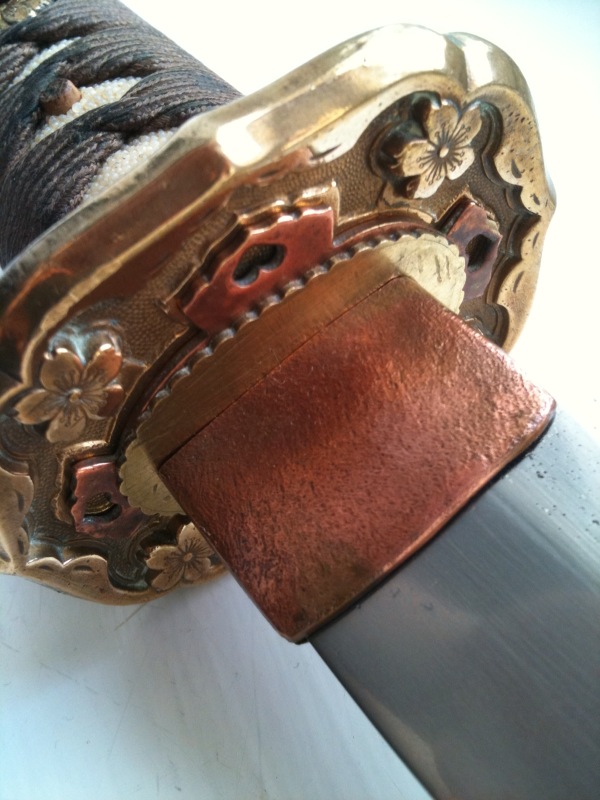

After so many years dreaming about samurai sword i finaly buy sword to me, i have heard that is nice start WWII sword and collect information about swords before buy really expensive sword.
I bought this sword in 930$ and now i whant to know whot you guys think about it, how mutch is market price of that did i pay too mutch ?

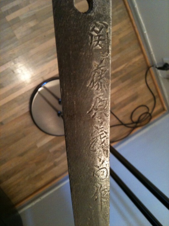

Can some one tell me about that signature?

Ville, what were you told about this sword, and do you have close up pictures of the blade.

Only what i know it is Japan officer sword Shingunto in WWII and blade is hand made, is made in 30s.
In papers is text shova blade, i have no idea what that mean. I have try to find out in internet, but even that i dont know what it mean.

The blade is signed Seki Fujiwara Yoshinao saku

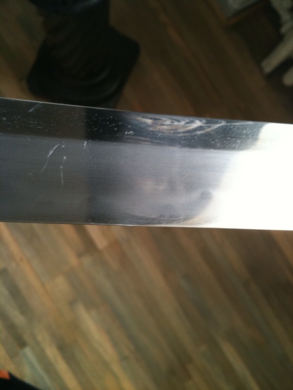

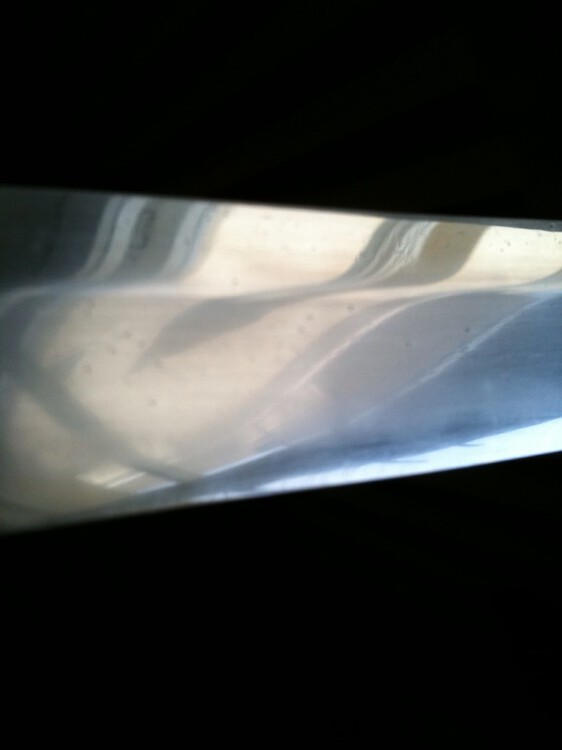

would also like to see any activity in the blade if you can photo.

i see you added pix as i was posting, the last photo shows us the most, but it would be better to not have any window glare, i use light bulbs one off to the side and one above, some time you have to tilt the blade to get the activty ....so far looks to have good work.

Thank you, now i know signature :) What you thin about price i pay ? I am sorry i have lott of questions in my new hoppy.

Do get right, blade is made smith name Fujiwara Yoshinao in city of Seki

Welcome, nice sword and priced about correct. You mentioned Finnish knives. I collect Nordic knives as well as Nihonto. I'll be asking you lots of questions about puukko. If interested, you can see some pictures of my knife collection at:

Thank also you to all info to my sword. Now i know signature and price is ok so i can start on empty table.
