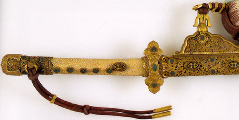

Heian Period. 11 Cent. ( this is actually a 17th cent reproduction but it'll do)

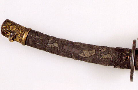

Ezo Koshirae. 15th Cent.

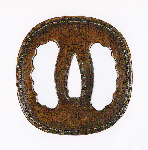

Namban. second half of the seventeenth century Circa 1675... ish!

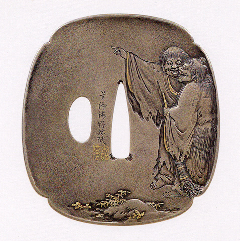

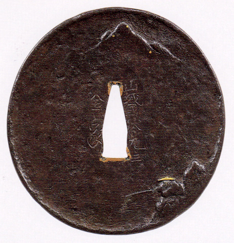

fig 0011 "mountain and fisherman...China/Daoist. this is problem for me...is it influence or "borrowing/copying".

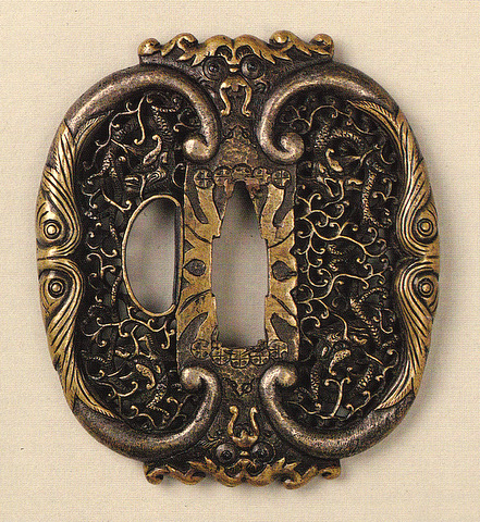

Namban 0019 "quasi-baroque Euro swordguard"...clearly evincing to me a borrowing from west...therefore, not really? "influence" but borrowing.

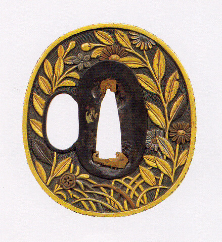

Mitsuoki otsuki jpg "bridge and moon"...the most subtly evincing of "influence" (not a blatant borrowing)...in this case, a technically correct western perspective in length/depth, breadth and height.

Firstly, may I compliment Ford on his careful selection of images for posting? Each is an ideal example of the school/period that it represents, and even I begin to see where the discussion on aesthetics is leading. But I still dislike the term ‘Japanese aesthetics’. It is the art that is Japanese; the aesthetics are personal, and mine alone, even if they have been given neat, Japanese labels.
In reply to his query regarding the dating of the two tsuba in part IV, I am somewhat surprised by the 1600-1640 period given to the Hizen tsuba. It is published on pp.46-7 of Graham Gemmell’s Tosōgu: Treasure of the Samurai, and is influenced by the Portuguese tooled leather that was indeed introduced into Japan in the seventeenth century. But I personally prefer GG’s dating of the mid-eighteenth century for the tsuba, and would like to hear Ford’s reasons for his earlier preference.
Ford obviously recognises that the dating of auriculate Namban tsuba is a hobby-horse of mine. Published on pp.50-1 of Syz’s Masterpieces from the Randolph B Caldwell Collection: Japanese Sword Fittings, this is a beautiful example of this fascinating group of tsuba, and bears the VOC logo of the Dutch East India Company. Japanese shinsa panels appear always to date these as Momoyama period, and this I take issue with.
These tsuba are said to be based upon the style of Iberian sword guards. But the swords that were introduced into Japan during the Momoyama period were rapiers, with their increasingly elaborate hilts, and the absence of any solid, discoid guard. This is evidenced by the reproduction of these curlique guards on Japanese six-fold screens of the period. The small sword, used purely for thrusting and furnished with a discoid counter-guard, had gradually evolved as a replacement for the rapier by the third decade of the seventeenth century. It is probably this later counter-guard, consisting of simple elliptical plates or of two conjoined shells, that influenced the development of the auriculate guard.
Two additional features on these guards add to the doubts regarding their Momoyama dating:
• The presence of a diminutive, kebori VOC logo on the seppadai of some of these guards suggests that many of them were made by the Dutch East India Company. While this company had a presence in Japan from the early seventeenth century, its exclusive trading rights were not established until 1639, in the early Edo period.
• Many of these guards demonstrate a decorative feature identified as ‘swan-neck drawer handles’. It is not certain whether these are derived from European swan-neck furniture handles, or are a later, abstract interpretation of the mokkō design. But these handles do not feature in Western brass trade catalogues until the 1730-80s — well into the late Edo period.
I thus conclude that the auriculate sub-section of Namban guards should be dated as of the Edo rather than the Momoyama period.
John L.
