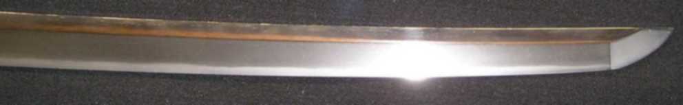

Ah yes, I see. Is the Tsuruginoya example in hadori polish? It may be that style that makes the nioi line seem wider than it is to me. The example I posted has a sashikomi polish and clearly shows the small width (hoso?) of the mainly suguha (with ko-notare) hamon. Another example of why it is better to study nihonto with your own eyes rather than somebody else's camera via the 'net.

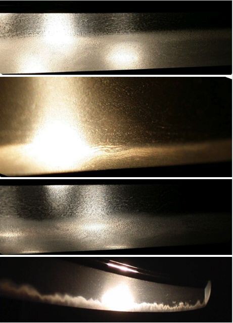

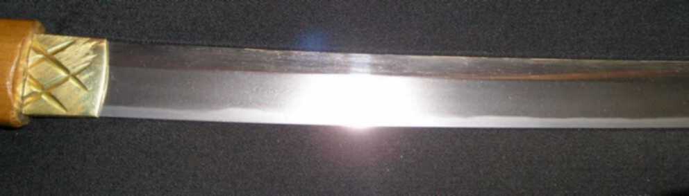

In an attempt to atone for my earlier error please see attached two rather poor photographs of a narrow suguha on a mumei Tadayoshi blade. There has been some debate between various appraisal bodies as to which generation this is. The workmanship suggests the shodai the shape the 4th generation. As can be seen it is not a pure suguha which is more indicative of the 1st than later generations. It also exhibits the "frayed" effect I described earlier with ko-nie falling through the nioi- guchi

Thanks for taking the time to help out Eric and Paul, much appreciated. You can also see the 'hotsure' (frayed edge) on the example I posted. I'd love to see the nie characteristics (location, size, density etc) and any hataraki (especially if it is a papered Shodai Tadayoshi) but I know that's asking quite a bit.
