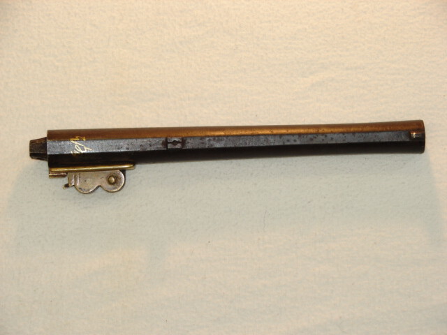

Could I prevail upon our Kanji experts to translate the signature on a Tanegashima barrel. There is also an interesting Mon or possibly script saying on the top of the barrel. I can not find it in my book on Mon, so I assume it is a saying. Anyway in a couple of weeks once the pistol is restored I shall post photos of the completed project. It is a beauty ! Thank you, ... Ron Watson

Off the top of my head the mei begins OSHU KUNITOMO... The rest would take getting the books out and I'm sure someone else will have read it by then...
The small script to the left of the mei looks it could be a number '22 dai' ??? (One of my teppo is numbered '21' on the bbl, breechplug, lock and stock).
The gold inlaid kanji is beautifully rendered.
Regards,
BaZZa.

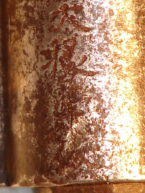

Here's a slightly different angle of the signature. I do not do digital photography, ... I rely on my son's expertise and I won't see him again for a couple of weeks. The last kanji appears poorly engraved, ... or more likely has suffered a slight ding. I appreciate your help and above all patience. Regards, ... Ron Watson

After DAIJO. as you note, the characters are hard to read. I get a feeling of NAGA about the first one, but the second may well await the expertise of your son to take a high resolution closeup.

In my records here I can find two Mei starting with 江州住 Kunitomo Tanba Daijo.
Both continue with the character Tachibana 橘; one finishes with Munetoshi 宗俊 and the other with Yasutoshi 康俊.
A good-looking barrel.
The marks on the left will be the maker's number and his own cross mark, I guess. The number is sometimes repeated on the panlid and inside the stock.

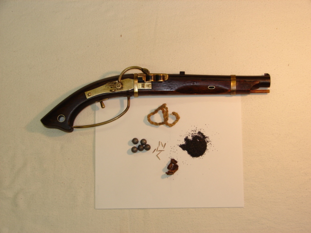

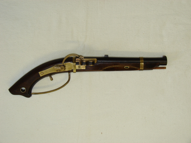

A couple of weeks ago members of the forum translated most of the Kanji ..... excepting the last two characters. I promised to try and get a better photo of these. See attached photos. I don't know if they are much better, as this area of the barrel has been slightly bruised ...
perhaps to the point of making the last two letters un-deciferable. Anyways they are posted. If any one can figure them out, ... you guys will. I also promised to show a photo of the pistol once I had completed restoration. See attached. A couple of interesting features will be noted. Whom ever ordered this pistol pulled out all the stops as far as extras. Note in front of the lock there is a tiny storage box with sliding door built into the box. This box was for the storage of tiny bamboo pins which held the match secure in the serpentine ( hammer ).
The match had a habit of blowing out of the serpentine on firing, and the bamboo pin helped secure the match to the serpentine. Spare pins were stored in the little built in box. I have read about this feature, but I have never seen a tanegashima equipped with one, and I have examined many of these firearms. Another feature is not as rare, but not common and that is a silver inlaid bead on the front sight for better sighting. The large brass lined hole in the grip is not likely for the extra match length as found on many tanegashima muskets but rather a primitive laynard ring ( allows a cord to be attached to the pistol and in turn attached to the obi to prevent loss in the heat of action ). The oval opening lined in brass towards the forend of the stock are normally found on musket type tanegashima of large caliber and thought to have been a way of attaching a strap to help hold down the recoil upon firing. In this case being a pistol, ... purely decorative ! Interestingly the pistol was still loaded upon my receipt. I removed by gun worm a couple of wads above the powder charge. The wadding appears to be made out of the inner part of " cattail reed head ", .... although I cannot be certain. Below this was 40 grains of Black Powder as good as the day it was loaded ( amazing in itself ). No ball was present, and it is my supposition that this was done on purpose. When brought into action it would have been a simple matter of dropping a ball down the barrel with a wad on top. If it had contained a ball, riding horseback for instance would soon have shaken it loose from its seated position and perhaps to the point of it falling out of the barrel altogether which would be rather embarrassing .... ie. shooting a blank load when your life depended upon your pistol. The one photo posted shows the pistol with a match, powder charge, wadding, balls, and in the middle the tiny bamboo pins. Only the pwder charge and wads are original to the pistol as found. Pistol is .50 caliber ( 3 monme ). Round with a flat top. The muzzle is swamped. Barrel length is 9 3/4 inches, overall length of pistol is 17 1/4 inches. It is in perfect working order. Thank you for your effort in helping me with the mei. I hope the new photos will be a help. ... Ron Watson

Note the lock plate shape, the use of a brass band instead of mekugi pins, the elongated teardrop trigger, and unusually large trigger guard, and consider Mino Seki-ryu and Yonezawa guns when categorizing your pistol.
http://www.xn--u9j370humdba539qcybpym.j ... /minou.jpg
http://www.xn--u9j370humdba539qcybpym.j ... nezawa.jpg
The bamboo serpentine pins and box are a fascinating feature which I have never seen before, but which would be extremely useful. Now I can see another reason for the holes in the serpentine pinch leaves.
The oval lanyard 'udenuki no kan' hole in the stock indicates by conventional wisdom that this is a cavalry pistol (bajo-zutsu) which once dropped from horseback would be impossible to retrieve without a cord. (As distinct from a regular carrying pistol, or tan-zutsu.) But I have seen mixed examples, so there seem to be just as many exceptions to this rule of thumb.
As Lorenzo said above, a closeup picture of the box functions would be very interesting.
In reply to Lorenzo, ... sadly photos of the built-in bamboo pin box will have to wait a couple of weeks. I rely on others to do my photography ( my son ).
In reply to Piers, ... I note the similarities between the Mino Seki-ryu and the Yonezawa schools. I lean towards the Yonezawa mainly because of the lock plate shape. The pistol seems to incorporate features from both schools. It was certainly not above the Edo Period Gunsmiths to, ... " beg, borrow or steal " ideas from other areas and smiths. The built in bamboo pin box was a design nightmare. The sliding door mechanism is well designed but too elaborate. The tolerances are unbelievable, ... perhaps a thousandth of an inch for some of the mechanism ( hidden behind the lock plate ). I know because I had to figure the bloody thing out in order to restore it. Attributing some of these guns to a specific school is difficult, ... but at least one does not worry too much about " gimei ", ... unlike the swords !

This kind of pistol is called a Hitori-aki (opening by itself) in that, depression of the trigger automatically opens the pan lid. On horseback you cannot reach out over your right hand to open the lid, so the process is made easier by the concealed spring...

(It was your e-mail that got me back-tracking this thing down and only just now this evening did I find this gun, so similar to yours that it may well be the same smith! The faint strokes seem to match...)
国友丹波橘宗俊 Kunitomo Tamba Tachibana Soshun (?)
If this name is correct, it may interest you to know that there is a gun recorded by this Kunitomo Tamba Nidai smith with the date 元和五年 Genna (or Genwa) 5.
