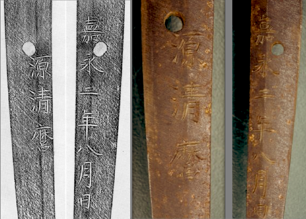

BRUNROX Posted January 28, 2010 Report Share Posted January 28, 2010 Greetings all, I have been drooling for about a week now on this beauty for sale by Komonjo... http://cgi.ebay.com/J471-Japanese-Samur ... 2558703aeb The little I have read rates Kiyomaro as a Top-Rated smith. I have also read some past threads on NMB about his works and style of Mei. After some research I was able to come to the conclusion that this sword is 99% correct. Just for the sake of discussion, what is your opinion ? I have dealt with Mike in the past and he allways deals with top notch merchandise. I just might jump on this one. Regards, Mario P. Link to comment Share on other sites More sharing options...

Ted Tenold Posted January 29, 2010 Report Share Posted January 29, 2010 Mario, I wish I had a dollar for every one of the times folks have asked me privately about Komonjo auctions. Having said that, and in consideration that this seller is pretty visable to a community of knowledgable folks that just *love* to buy genuine works at low relative prices, do you really believe that you can buy a genuine Kiyomaro from an often discussed dealer on the world's largest buying venue,..... for a song? Link to comment Share on other sites More sharing options...
Grey Doffin Posted January 29, 2010 Report Share Posted January 29, 2010 Mario, A reasonable price for a 73 cm katana by Kiyomaro, if the mei is correct, would be something like $200,000 - $300,000. No knowledgeable seller will let one go for less than 8K. This would be a great sword for someone who wants a big name to brag about and isn't concerned that it probably isn't real. Grey Link to comment Share on other sites More sharing options...
estcrh Posted January 29, 2010 Report Share Posted January 29, 2010 "If the question concerns the authenticity of the signature, then the answer is "Who knows?" Unless you witness the sword being made and the signature inscribed, no one can tell with absolute certainty that the signature is genuine. But, fortunately, there are people who spend years studying swords, and they offer their opinions in the form of kanteisho (evaluation paper). In the absence of such a paper, it would be safe to assume that every signature is false. Experts suggest that more than 80% of the signatures are not genuine, and the percentage gets higher on famous and popular swordsmiths. The lack of kanteiso or having a gimei (false signature), however, does not mean that the sword is worthless. Far from it. False signatures are often added years, if not centuries after the blade was made, and that is no fault of the original swordsmith. If you appreciate the blade for itself, then the signature should not matter, in my opinion. If, on the other hand, you are buying the "name" and not the blade, then you should be prepared to pay dearly for it. Having a kanteisho does not necessarily guarantee that the signature is genuine. Some kanteisho are issued by questionable organizations, and reputable organizations too are known to have issued some questionable papers in the past. So what is one to do? Unless you have trained eyes and the confidence in your ability to judge blades, it would be safe to shop only for a swod that "speaks" to you and is within the price range that you can justify to yourself". >>>>>This is what the seller of this sword has to say about signatures on the swords he sells....in his own words. This statement is true for just about any signature on any antique (and most newer ones also) Japanese item as far as I can see, if you like the item and can afford it and it it did not have that particular signature would you still buy it? I believe if the item you buy is actually authentic and as old as you believe it is you are doing pretty good! Link to comment Share on other sites More sharing options...
Jean Posted January 29, 2010 Report Share Posted January 29, 2010 Mario, What you need is to stroll along the different commercial sites listed by Dr. Stein (the Japanese ones) just to be aware of prices To paraphrase Darcy, seeing a Kiyomaro on sale is like seeing a ghost ..... These blades belongs to individuals and never reach the market when for sale....... Except for a few swords (I am thinking of the Go Yoshiro's worth around 200k$) the best ones never reach the public Link to comment Share on other sites More sharing options...
pcfarrar Posted January 29, 2010 Report Share Posted January 29, 2010 Do you think this sword could be a modern copy made in the past 20 years or so by a sword smith in Japan? Link to comment Share on other sites More sharing options...

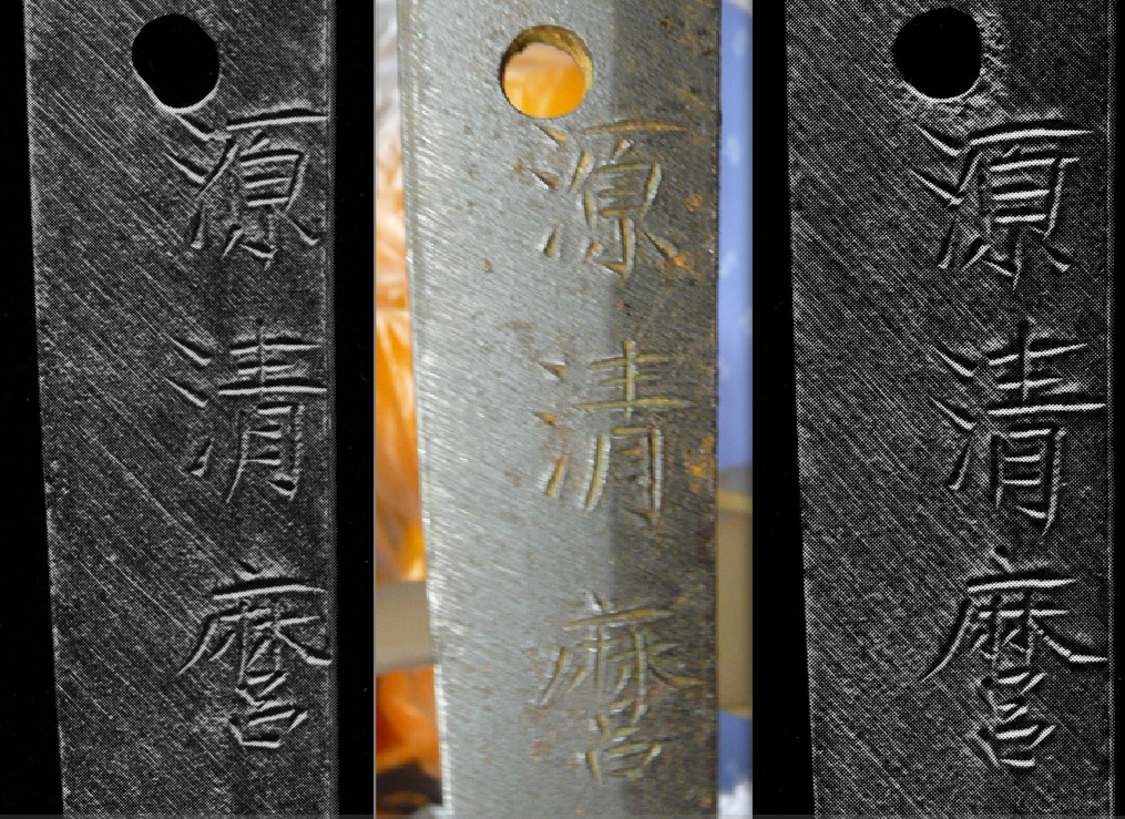

Stephen Posted January 29, 2010 Report Share Posted January 29, 2010 Peter when i first viewed the sword i also thought new sword, in last ten or twenty years. someone posted this pix before, not sure which was the shoshin or if there all gimei. the sword its self looks worth the starting price, just remove the mei? Link to comment Share on other sites More sharing options...

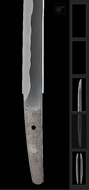

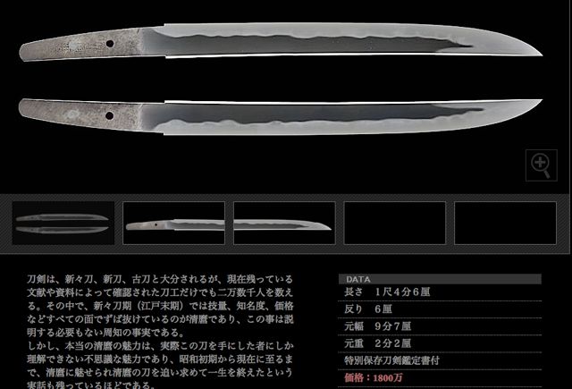

Eric H Posted January 29, 2010 Report Share Posted January 29, 2010 To give an idea about Kiyomaro prices This Wakizashi, price $ 200,000 Eric Link to comment Share on other sites More sharing options...

Eric H Posted January 29, 2010 Report Share Posted January 29, 2010 That gives me something to think about since longtime. There is a sword by a swordsmith, very famous already during his lifetime, for instance this Wakizashi by Kiyomaro. This sword was a bit later perhaps equipped with a new Koshirae, the Nakago got defaced by drilling an additional mekugi-ana. One would think it is easier to work with the existing one...and that craftsmen at that time had enough sword-connoisseur-ship to avoid such a doing. Unfortunately not... Eric Link to comment Share on other sites More sharing options...
