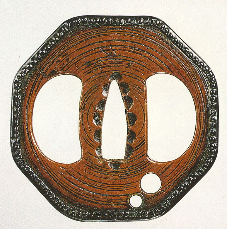

" This also brings to mind those tsuba that have metalwork right into the seppa-dai where the seppa actually sits upon this work. Those tsuba have wearing from the seppa that has damaged the metalwork. Were these made to not be mounted? John "
This particular issue was talked about a few years back............ I recall Jim G.'s opinion is that those are not " true " tsuba. I've seen most of that in late edo/Meiji pieces. However, Christie's, Sotheby's list them as tsuba.
I suppose they are not " functional " but more like presentation pieces.
Jim G. ( I recall ) thinks " decoration " onto seppa dai area is fine as long as they are " flat ".
:lol: at least that's what my memory tells me.........could be wrong and/or Jim G. never said that.

That's pretty much it to my understanding. If you decorate into the seppadai in any way which would interfere with the mounting you've breached the usefulness of the tsuba and rendered it an 'artwork', to be used as a presentation piece, gift or whatever. Late Edo saw declining utility for the tsuba but increasing artistry in metalwork therefore the tsuba as presentation piece. There's nothing wrong with this but those who are students of 'tsuba' orthodoxy would tend to not give much heed to these later pieces tending more to the early and pre-Edo examples which were purely for utilitarian purpose (and let's not get into the court-wear pieces arguement please)! LOL

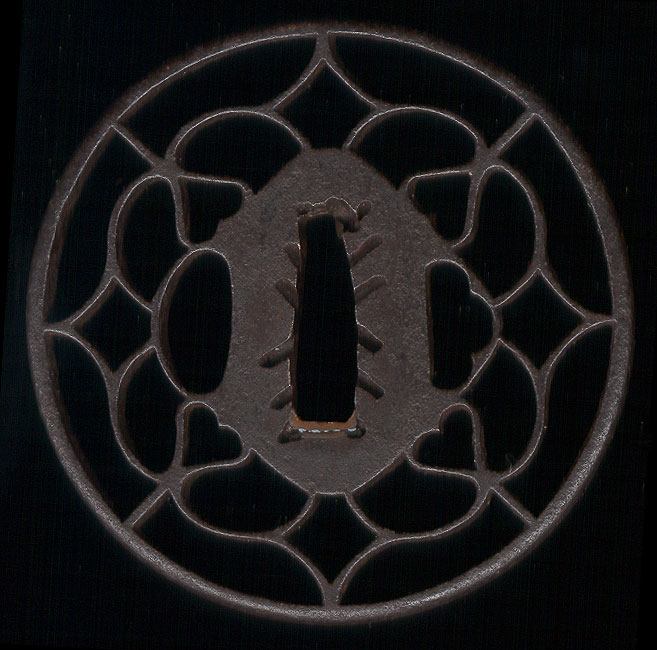

Note the lateral sequential tagane of the TM tagane mei. Many of the works were signed but the tagane were a good way to differentiate them from later Akasaka and Higo pieces.

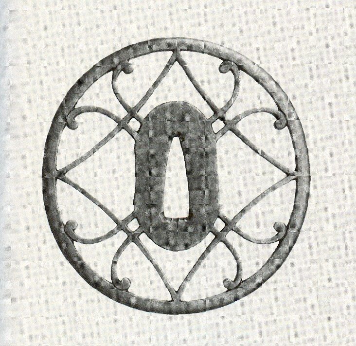

Here you will see the two / three tagane mei of Rakuju:

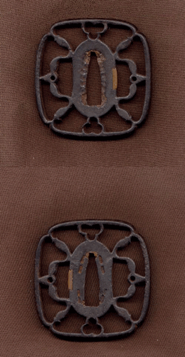

Sorry, I know this post does not relate to the theme of this thread. But I realized a strange thing about the Tsuba.
The pattern on the tsuba seems to be symmetry both vertically and horizontally except nakago-ana. But only lower left part is different. When I flipped over and rotated the part, it fitted in the tsuba correctly. So, I suspect that the maker made a mistake to assemble parts when he made the tsuba. :doubt:

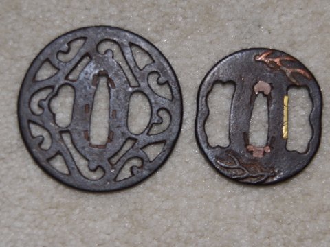

Hi Koichi-san, Yes, it is noticeable when you draw attention to it. The left half has the direction all one way and the right has the directions divided to two directions. It doesn't hurt the theme of the tsuba, but, yes I think when cutting out the design there was an error and the smith did not want to waste half of a weeks work. Pete, your examples really show how precise markings can identify a particular school, or at least be a part of the identification. While we are on the subject, I have a couple of Akasaka tsuba that have the same markings in the seppa-dai. I refer to the longitudinal punch marks. What is the purpose of these? John
99.9% of the time the tagane you see are for fitting the piece. It is a mistake to read into these too much. They are used as a form of signature by specific tsubako only, just as kuchi beni are used by specific makers/schools. In other words don't knock yourself out looking for these and attempting to figure out what every little mark might mean. It's important to remember that these were made for utilitarian purposes.
That was a very astute observation on the asymmetry of the design. It probably was a tracing mistake and as mentioned wasn't worth the time to discard the piece and start over. It could also be a subtle joke to see if anyone would catch it. Don't underestimate these boys -- they were crafty!
John -- Shoami it is. If you look at the edges of the sukashi you will see they are slightly rounded. Akasaka is known for a sharp edge. It's important to remember that the 'motif' does not necessarily point to the school as in mid to late Edo there was a coalescing of the schools, especially in Kyoto and Edo regions which resulted in a crossover of designs. You need to look to the finer details to discern the differences.

Tsuba on top I think is Shoami from the ovoid shape of the seppadai and the niku and thinness of the mimi. Theme looks Akasaka.
Tsuba on bottom has a Hagi/Choshu or Bushu look to my eye.
Just my feelings -- very well could be mistaken. Not in the 'expert' department yet or for quite some time to come.

These tagane were clearly used by several schools through out the Edo period. I would also note, I doubt many of these are a mei, as apposed to just a fanciful way to do punch marks, and you may find the one artist did several variations throughout his career.
Having written all that, I just read Pete Klein's thread and he basically said the same things.
Rich
Rich,
Very interesting...I would not have gotten that :)
Can you give us some indicators on what gives it away and what the kantei points were on this one so that we know what to look for?
Ie..if it wasn't signed, then what would eventually have led to the Tosa Myochin attribution?
Thanks,
Brian
