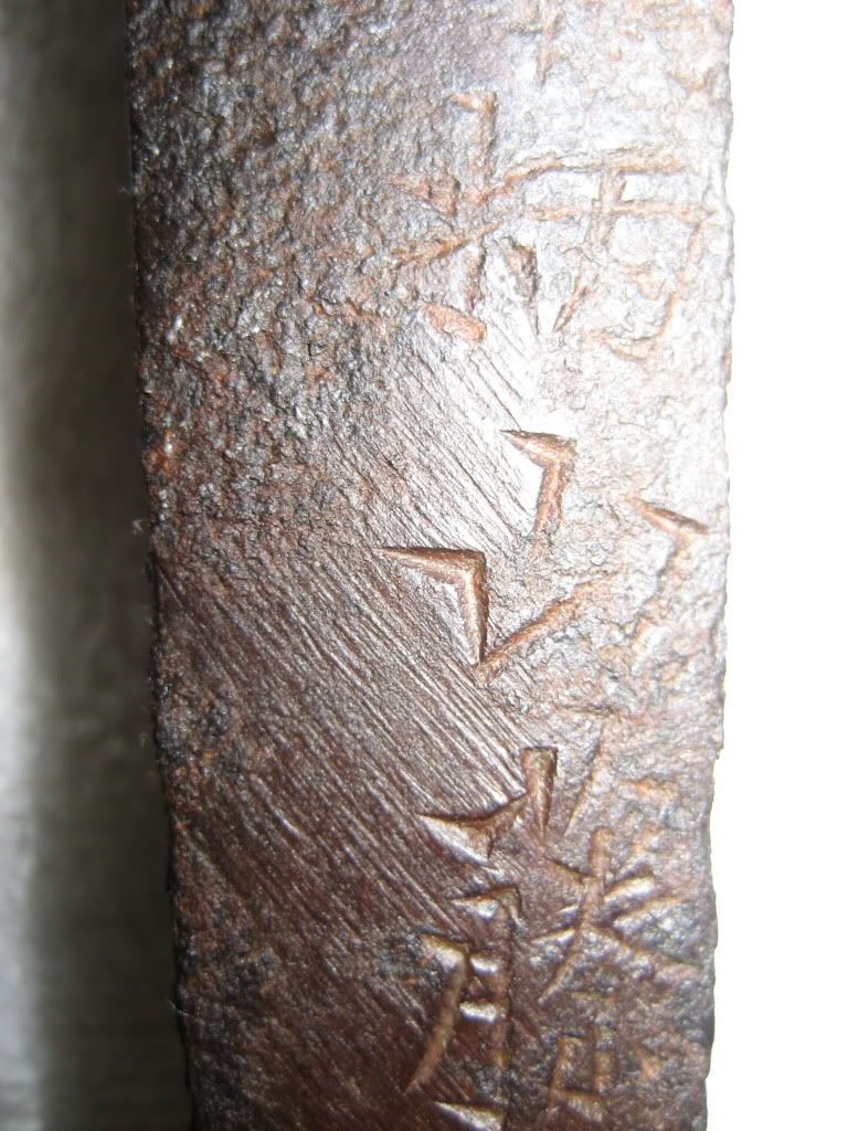

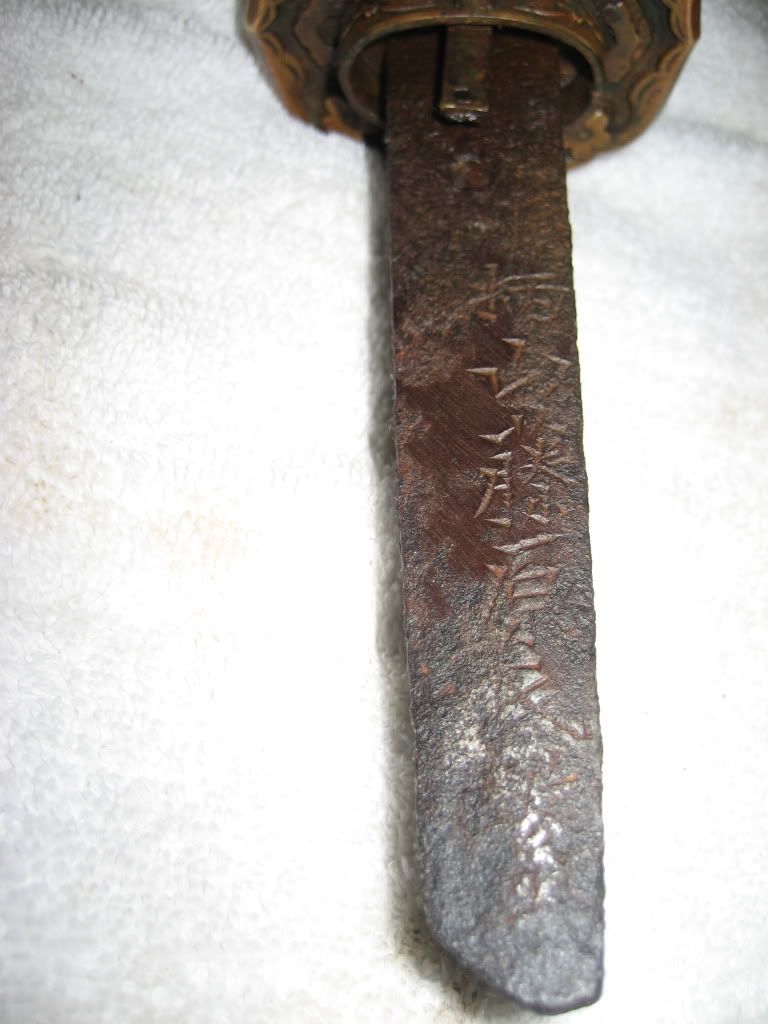

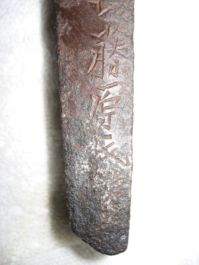

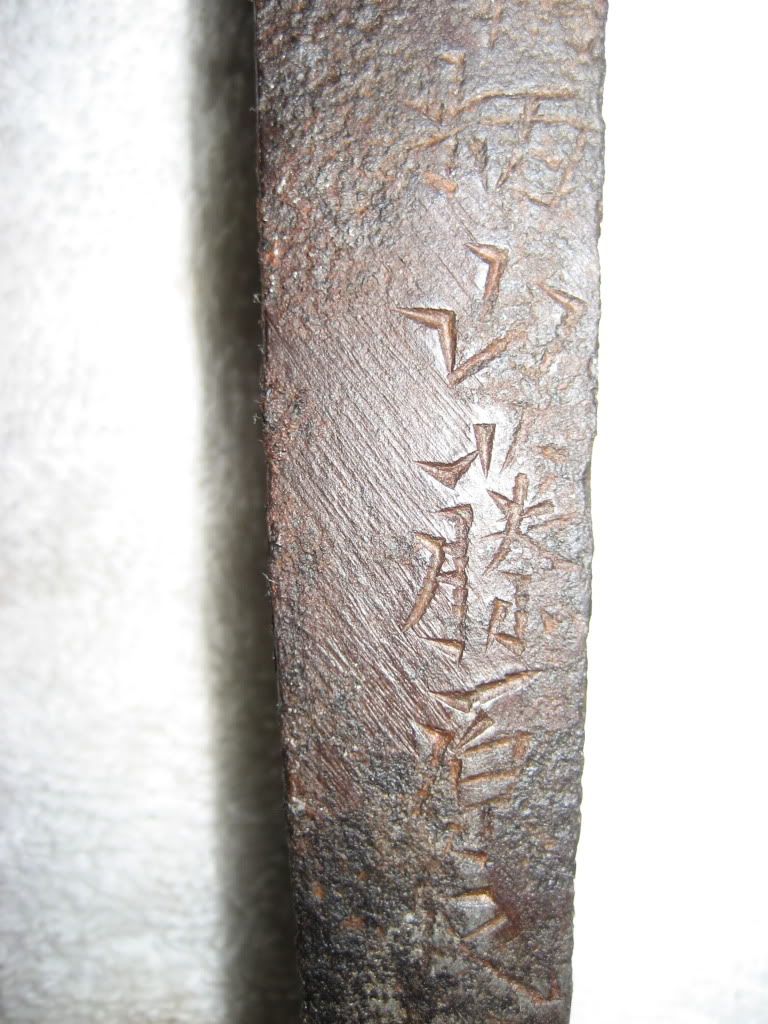

Ok so I spent a few hours each night for the past few nights crushing away with a plastic hammer and mineral oil. A lot of the crusty active rust has come off, revealing some of the "mei." It was pretty amazing...I would smack an area of the tang a bunch of times, and with each smack, the character would come clearer and clearer...
I am having some trouble revealing the bottom 1 or 2 characters (not sure how many there are under there). No matter how hard I smack the bottom of the tang, no rust comes off, and no characters come clear. Also, I am not sure if there is a character at the very top of the "mei" - Do we know how many characters there SHOULD be?
Anyway, here is my progress so far...
Is there a character on the very top here? I can't tell really. Do we know how many characters should there be?

Hi Dave,
it would depend on the name the smith wanted to use -- family, school or place attribution, if he had an honorific, wanted to give a date made, etc.
is there anything written on the other side?
doug e
As far as I can tell, there is nothing on the other side of the tang...That side is also pretty evenly rusted, but I can't even see a hint of a "mei."
On second thought...let me work on the other side as well...maybe there is a mei under that rust...
That nakago is dangerously close (or already there?) to being overcleaned and damaged.
I really don't advise this method for any genuine Japanese sword, and have severe reservations about it being promoted here.
I think this is for experts, and knowing who made it is really secondary to keeping the nakago original and undamaged further.
Or as they say..." Don't try this at home"
Brian
Edit to add: Done as Barry explained, and over a long time, the technique I am sure works well. However the problem is that we cannot be there personally to supervise how hard, fast and vigorous someone does this..and therein lies the danger.
Brian
Plainly, I don't agree and I have a Tokubetsu Hozon katana that passed NBTHK with my cleaning "technique", for want of a better word.
Dave
Brian is right - you're going too far too fast and I'm seriously concerned you have the bit between your teeth. Rein in, stop and go no further for the present. I was very concerned to see the aggressiveness directed at the last two characters. Remember my watchwords SLOW; CAREFUL; MONTHS OF PATIENT, LOW KEY WORK.

You may have cleaned enough. There is a strong resemblance to 3rd generation Tegarayama Ujishige. According to Fujishiro he worked ~1780 in Harima. The whole mei would likely be 'Banshu Tegarayama Fujiwara Ujishige'. We can see the 'Gara','Yama', 'Fuji', and 'Wara' pretty clearly. I can see the beginnings of 'Uji' under 'Wara'. As well, you can slightly see the 'Te' above the 'Gara', particularly in the last photo although its pretty rust-covered. 'Shige' is most definitely there, just rust-covered. I'm assuming 'Ban' and 'Shu' are above the 'Te', though that area is heavily rust-covered and I can see no traces.
My resource was Fujishiro, Shinto Hen, pg. 203. The mei in Fujishiro looked spot on for these characters. The yasurime and nakagojiri also match. The 1st and 2nd generation do not look as close from the examples I found. 4th generation Ujishige became Masashige, noted ShinShinTo smith. He signed Ujishige for awhile but his style is different, at least in his Masashige mei. I could not find a 4th generation Ujishige mei by him. Nakagojiri also differ 3rd to 4th generation. My money is on 3rd generation Ujishige.
Matt
I think the flash of the camera is making it look a lot shinier and "cleaner" than it really is. It is pretty much completely brown and rust colored still, but now you can see some more of the characters. I really just concentrated on the very loose flaky rust, which didn't take much work at all to crush off...I don't think any damage was done.
I don't plan on cleaning any more though...I don't think any of the other characters were preserved under all that pitting and rust anyway.

Anyone else have any thoughts on this translation?
