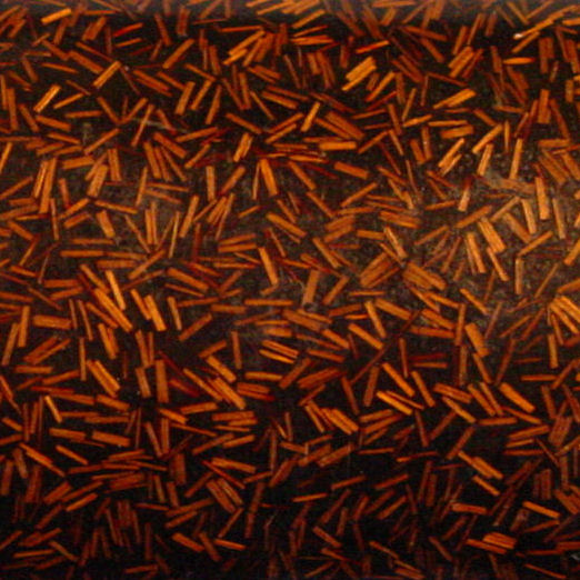

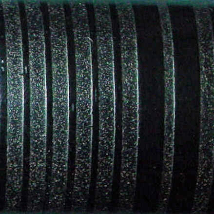

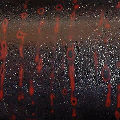

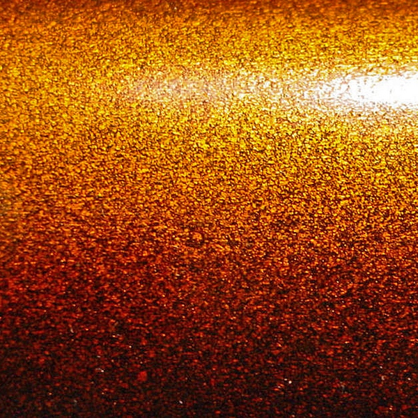

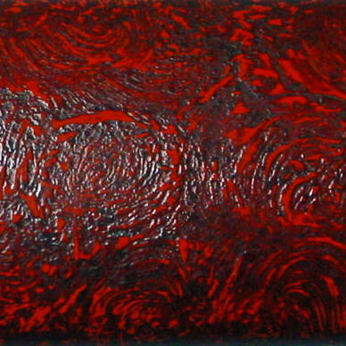

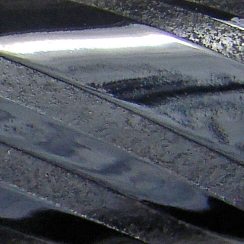

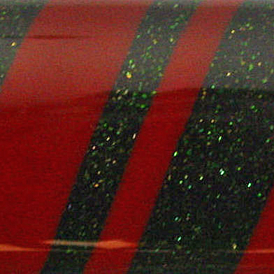

DIY aside for a moment: Cashew, applied by a professional, can be a great finish that looks as good - and sometimes even better - than "real" Urushi. Attached are a few close-up shots of Sayanuri of some of my swords (sorry for the glare in some of them): I dare you to tell the difference!

I have a couple of saya that have cashew. One I use almost daily. The surface shows wear. Although it has a wonderful finish it couldn't take this day to day use. Ford, you find it as hard as urushi? Maybe mine needed a better quality of cashew. If I had a choice I would always use urushi. Guido's examples are truly great and fine for display saya. John
Guido
Those are truly amazing cashew paint jobs. I dont mean that in an unkindly way at all... they look first class. Urushi ... good urushi is however an extremely hard wearing finish, something that cashew is not. For display purposes cashew can fool, and I do mean fool, even the most discerning eye. But real nihonto never had Cashew paint jobs. They had urushi. Only urushi is therefore correct. Sorry to be a stickler, but regardless of how good it is, cashew is not an original finish on saya and in my view it is not therefore an appropriate replacement or repair medium.

if a cashew finish is properly applied over a correctly prepared ground then it should not show any marks when you try to indent it with a thumbnail.
I tend to use natural urushi (mainly because it's more fluid and is capable of finer applications) but I have experimented with cashew and in most respects it works very much the same. Bear in mind though that the only difference I made was to substitute cashew for urushi, I still applied all the usual ground work etc. This is, I suspect, not done when cashew is used as a cheap alternative. This is understandable but doesn't really give a very accurate impression of the usefulness of Cashew. It's not entirely synthetic either, it's derived from an oil extracted from the shells of Cashew nuts and is made up of urushiol, the key component (after water) of true urushi.
