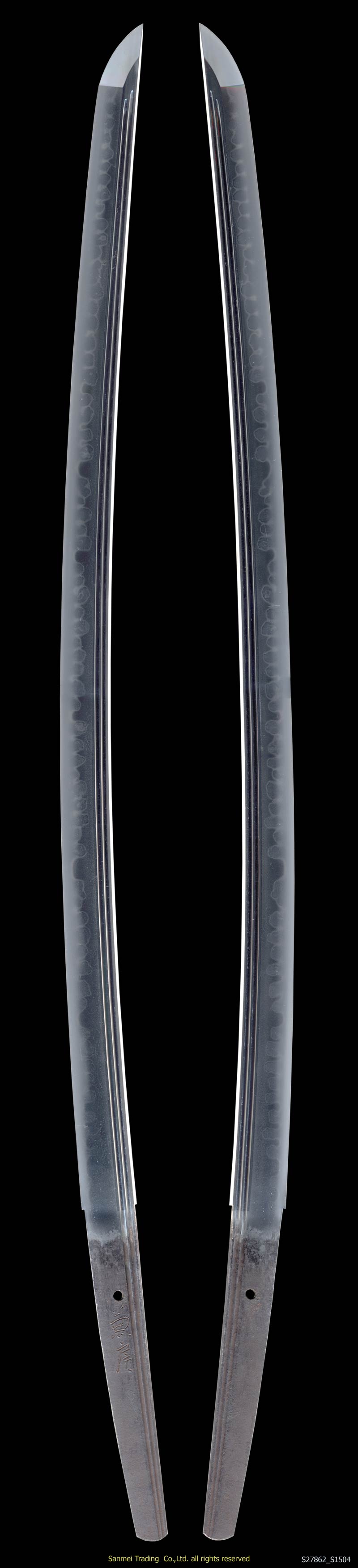

I recently purchased a katana with no signature. Being new to Nihonto study, I am interested in understanding how one goes about the task of researching the possible maker without getting it professionally assessed or papered in Japan or is this not possible. I have atached a few photos which give a reasonable view of the sword. I am happy to take more specific photos if this helps. Thus far I have reached the following conclusions:
1) It has civillian saya and mounts, with low - medium quality tsuba and fuchi. Leather cover fitted for war use.
2) Mumei tang shows "old" rusting. Has been shortened at some stage due to number of mekugi holes and squared off end.
3) According to Yumoto's book, it has a " billowing " temperline and looks traditionally made. Hard to see much more without giving it a good polish I suspect.
4) Leather wrapping on tsuka with a good quality menuki. Does the menuki date the sword ?
This where I come to a full stop ! I would be most gratefull for any advice or comments from the NMB, including advice that further research on the possible maker is best left to a Nihonto professional.
Sil L

What i am sure most of the members will want to see is, blade out of saya with out habaki full shot to see the over all shape. closer pix of the kissaki and if you can get any of the hada that would help.
Id say sofar a very nice first buy, many first buys are showato with a stamp and they think there gold...yours is very nice. More pix please.

A word of advice. First; Strip the sword down to the blade only; Use your undoubted talent as a photographer to take good pictures of the whole blade left and rightsided. Photos of the tang (nakago) including close up. Close up of Hamon. For the time being forget the hada., and finally close up both sides of the Kissaki (point).
That will give some of the subscribers a fighting chance about time and smith.

another serious advice: both the aesthetics of a Japanese blade and the decisive hints to it's maker could only be revealed in polished condition. I'm afraid, that Your blade hasn't the proper condition now to tell more than general ideas and speculations even with better photos. However, polishing is very expensive, but money is wasted if the blade turns out (in worst case) worthless.
It is not my intention to discourage You but try to get in personal contact with collectors and show this blade to someone who is experienced (REALLY experienced) and could advise You if further investments should be made. And maybe this person could tell You more about the origin, holding this blade in his hands.

I don't think there is much that can be deduced from the pics unfortunately. Once again, we have hadori polish without actually seeing a hamon, and the rest if fairly generic. Hopefully someone can deduce something.
PS - Please don't upload pics as a .pdf. Makes viewing difficult for some, and jpegs are so much easier.
Don't re-upload though, these should suffice.

As the others have said, it is hard to tell much about the sword. While decent photos, they don't or can't (due to state of polish) highlight some of the things that are helpful.
Using non technical terms:
Going from the shape of the sword, the even thickness up through the fore part of the blade... I would say Shinto or shinshinto.
From what little I can see of the jigane and the rather pilar like formations in the hamon, plus some scattering of snowy nie inbetween- my first thought is that it is a mino school derivative from perhaps some time in the shinto period? Not my favorite area of study.
Perhaps something more related to this: http://www.nihonto.us/UJIFUSA%20KATANA.htm
Most of the Unifusa were of Mino origins. I am not saying it is Ujifusa school. My impression is that it is from a derivative Mino school like the Ujifusa school.
Let me stress this is just my 2cents. I don't know what to make of the nakago (tang) shape and marks. That might point away from a Mino derivative school. Just trying to help a bit.
