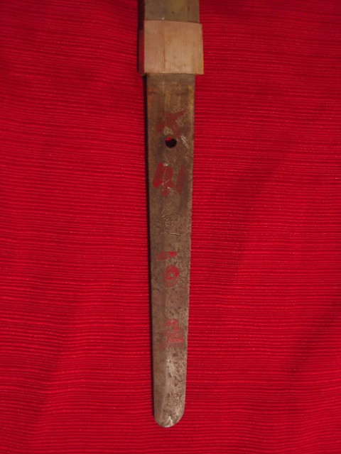

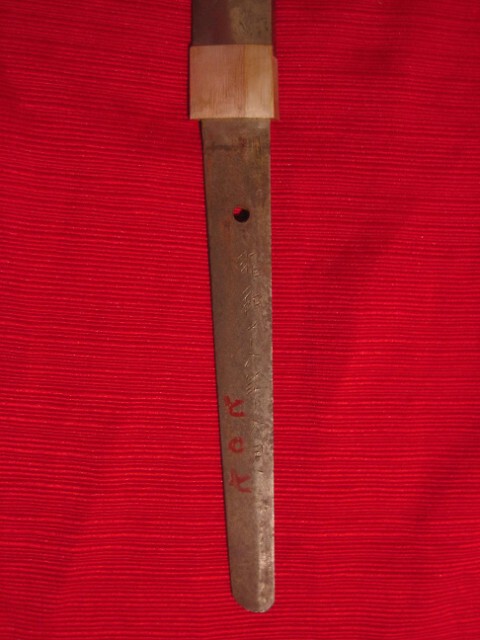

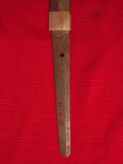

I have pics of the mei and the date on the tang, I do not know if it is readable, I joined the pics anyway. But there is no seki stamp on that tang.

Bruno,
The information comes from Dr Jinsoo Kim's site http://www.jpsword.com
click on Gunto Story then WWII Swordsmith Ranking and scroll down to Seki Kaji Tosho list.
Daido is there with his family and personal name, but although I can read many Japanese names I am unsure how to read this properly...as you know there are two ways to pronounce Japanese "On" and Kun"...and many variations in the pronunciation of Kanji when used as names. His name looks like Higashidani Fujiyoshi...or? Only Moriyama san can be familiar with the Japanese names.
Regards
George.
Bruno,
Stephen is translating the meaning of the words DAI "great" DO "way". Daido can be read this way "On" reading (Chinese pronunciation) or OMICHI "Kun" reading (Japanese pronunciation). Daido also sounds like a religious phrase of Buddhism or a Buddhist priest name.
There were a number of swordsmiths of this name Daido in Shinto/Shinshinto times.
Perhaps your Gunto tosho chose the name for this reason.
George.
