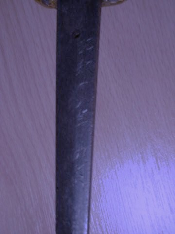

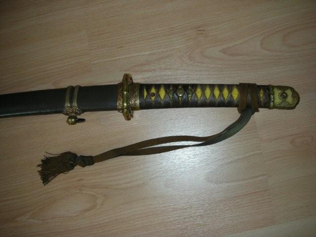

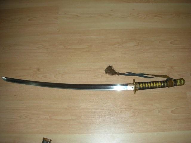

i recently got offerd a nice shin gunto whit early war blade signed under the tsuka
but wanted to have a experts opinion before i buy this one
seppa`s and tsuba all marked 45 on the left side and 4 above the tang opening
oh the stuka`s rayskin became yellow of all the smoking the veteran did as he loved sigars
thanks again for the help
cheers
better pics of the signatures are comming

To me, this looks like a genuine good quality shin gunto. The blade, judging solely from the sori and the general shape and color of the nakago with the long mei, strikes me as being a Shinto period blade in good old polish. This is what I see but an in-hand examination might have a different result.
The tsuka-ito seems to be darkened towards the tsuba. This occurs from being held by the officer to keep it steady by his side and further indicates its authenticity.

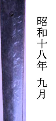

The inscription on the nakago looks like a date in Showa era. :?:
Hi Katsumoto.
I agree with Moriyama san...it looks like the date Showa 18th year 9th month (Sept. 1943)...suppose we'll have to wait for better pics. About the yellow same...I think it may be yellow because it is celluloid (an early plastic). I have seen this occasionally, usually on good quality WWII gunto blades, including star stamped (gendaito) blades. I think it is quite rare possibly because it was probably more expensive? than real same, but was expected to be water resistant and less likely to damage. It tends to turn yellow with age.
Regards, George Trotter
Hello,
Better eyes than mine have discerned a showa era date on the nakago and , looking at it again, I must agree.
As for the seller swearing it is prewar, perhaps he believes that to be true. My neighbor's father had a sword in gunto mounts he obtained in occupied Japan . He believed it was made in the 1880's because one of Japanese workers he oversaw told him so. My examination of the sword showed it to be a 1943 showato from the workshop of Kanemichi of Seki. Very nice for what it was, but no antique.
This sword could still turn out to be a very nice Gendaito.
William G.
