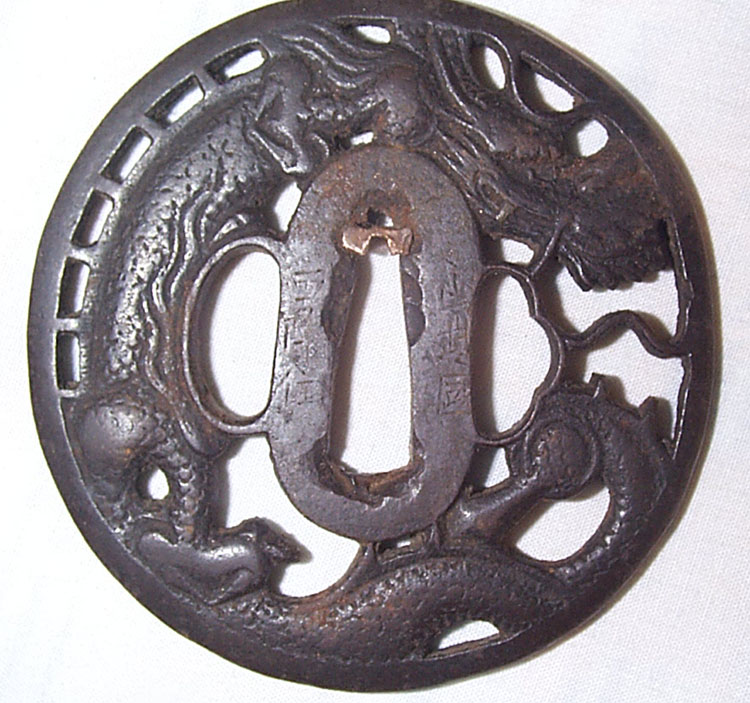

i went to 3 militaria fairs 2 antique shows and only found a gendiato but at a boot fair 2 miles from home i bought this "chinese belt buckle " for £1 $1.60
can anyone tell me who the maker is and rough age

This looks like an Umetada Dragon.
Refer to this link for a comparison between Kinai and Umetada.
http://www.shibuiswords.com/BITsuba3.htm
The wear on this tsuba appears artificial, it is too consistent.
It almost appears as if someone has used a sander to grind down all the highlights!
And strangely enough it appears as if both sides are equally worn?
Honest and true wear is usually occurs in specific areas, for example; where a hand was rested on the rim (mimi).
Just my opinion.
Still not bad for a quid.
Hi, the signature reads Yamashiro no Kuni Nishijin jû on the Omote (front) and Umetada on the Ura (back) thought it is not a very convincing mei. These are similar to the Echizen Kinai tsuba in that they were mass produced and only ever of average or below average quality.

In my opinion this is a fairly recent cast steel copy...not sure I'd pay a quid for it though.
The belt sander finish that has levelled the high points and the very irregular, inner rim are the most obvious indicators to my eyes.

Perhaps a brief description of the reproduction process will make it easier to understand and help with the identification of castings in future.
If you start with a genuine tsuba it is quite straightforward to take a rubber mould. This can be done with various liquid latex type rubbers that are simply poured around the piece and allowed to cure, or in a proper vulcanizing press, as jewellers would do. Either process yields a block of rubber encasing the piece. The rubber is then carefully cut apart using a scalpel. Care is taken to either keep the seam line in areas that can easily be tidied up after casting or hidden in complex pattern
Typically, when a piece is thus embedded in rubber it will also have a rod of metal ( about the thickness of a pencil) laid in so that it touches the piece on the rim and extends to the edge of the rubber. This will form a channel through which the molten wax is subsequently injected. Jewellery workshops specialising in casting use a pressurised wax injector.
Most of the roundedness we see on castings comes from the inevitable shrinkage of the wax at this stage. The seam (also known as flash in the trade) is a result of the molten wax being forced out through the gaps in the rubber mould. What I want to highlight here is that many of the tell tale signs of casting are more often evidence of the wax model and not marks left by the actual metal casting. It simply isn't usual practice, nor very effective, to cast such small and complex items in reusable, 2 part moulds even today when we have far superior materials with which moulds can be made.
Once the wax is made it is then encased in investment plaster (plaster of paris) mounted on that rod I mentioned. That's called the sprue btw. The wax is melted out and the metal pored in. The actual casting can be simply a gravity pour or it can rely on centrifugal spin in some process, to force the metal into the mould. The most accurate casts are generally produced in vacuum casting. Here the flask holding the mould is place on a vacuum machine that is released as the metal is pored in. The vacuum then sucks the molten metal in very effectively and yields the sharpest casts.
So, if you see evidence of a seam inside the openings of a tsuba it was probably cast from a wax injection moulded model and is therefore modern. I can't be sure when the process was developed ( none of my older books on Jewellery making mention it before the 1960's) but pressurised wax injection is a very new addition to the metalworkers technology.

Copper eye and brass whiskers....hmm, well I'd say unless you can show me a genuine Kinai dragon tsuba with copper eyes and brass whiskers then yes, I still think it's a cast copy. I notice that in the close up you show the areas not polished/ground smooth, and in the recesses are quite coarse and grainy as I'd expect from a steel investment casting.
The copper sekigane looks to be proud of the seppa dai too....how would that work then?
The irregular lines are on the inside of the mimi, as I stated. Anyway, looking at the way the steel has been so obviously ground down to smooth it it out and the fact that it's obviously been done to hide the overall coarseness of the metal (because it's cast steel :glee: ) I don't know why I'm bothering to try to explain this to you. You'll believe what you want to.

Hi all, this is a private massage I sent Nick in response to him asking me a question about this tsuba (did I believe Ford's critique of modern and cast)
Hi Nick, it might be. A few points if I may.
Firstly, I would not really bother with it any more as it's really not worth the angst, and as you said you paid only 1 pound or whatever, then it makes no matter.

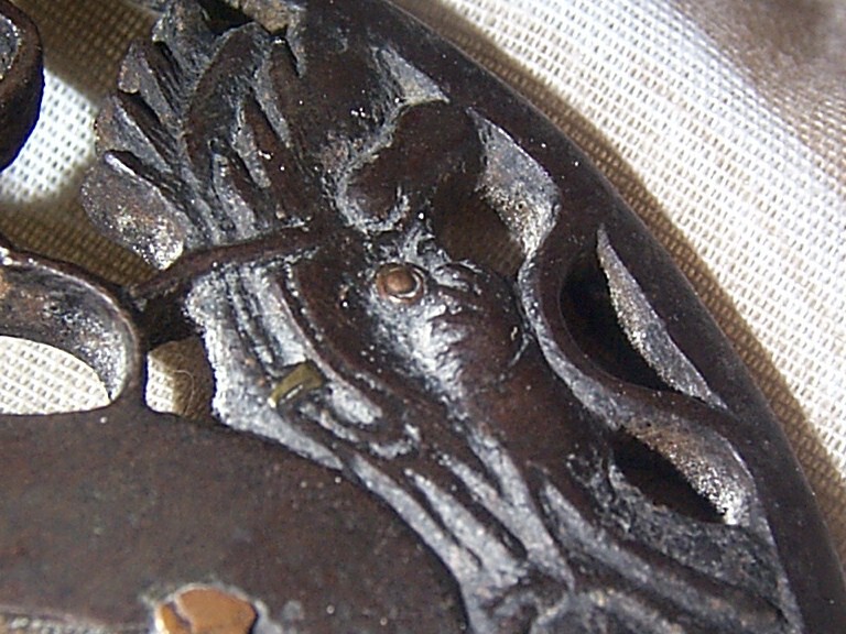

I am not sure if it's cast or not, but your close up of the eye and whisker gives a lot away. If it were true Umetada work, then they would both be gold and the signature would not be that chicken scratch style. If it were high end Echizen, then they would be either gold or brass, but not two different metals.
It is most likely a late Echizen kinai mass produced piece with a gimei signature. These are about equivalent to Yokohama dock (shiiremono) tsuba are come in variations of quality, from absolute rubbish to almost ok. Yours is in the middle somewhere there. I think it is possible it was cast and then cleaned up but it is also possible that it was a real tsuba, just made fair poorly.
The cast tsuba of the shiiremono type have a lot of the time diagonal file marks on the seppa dai, is there anything like that ?, you should also look for a seam in any of the sukashi walls where two halves were put together.
