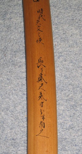

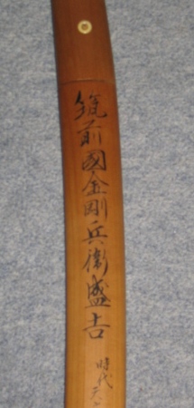

Hi,
I wonder if anyone could please help me with translation of my Katana sayagaki.
I believe it was written by Honnami Nishu, but beyond that I have no information.
The sword also came with Fujishiro papers (which I’ve managed to translate some of), attributing the sword to Moriyoshi.
Hope the pictures are good enough & they work OK.
Thanks guys for what ever help you can give.
Iain E
CHIKUZEN KUNI KONGOBEIYO MORIYOSHI , then ? DAI TENBUN (1532-1554), I can't see the nagasa clearly but it is signed Honami Nishin.
That's almost it. Just a few remarks:
This school in Chikuzen province is sometimes called "Kongobei" and sometimes "Kongobyoe". The kiwame goes on with: "jidai" (era) TENBUN (sometimes named TENMON) "koro" (at that time).
Nagasa: Ni (two) shaku (two/three?) sun (I'm not sure about this one)........
The name of the appraiser is Hon'ami NISHU (+Kao)
Maybe kind Moriyama-san will fill the remaining holes.
reinhard
