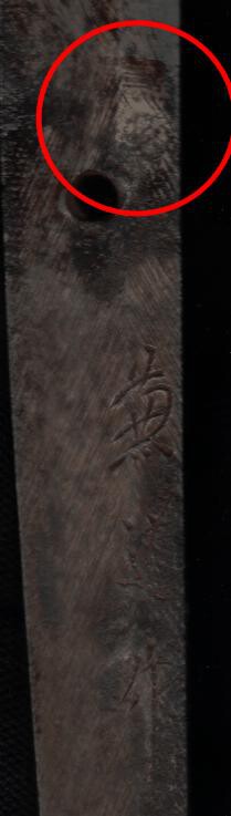

Sorry to open this thread again but I own a Kanemichi as well and it seems that something on the right side above the mekugi ana has also been removed (see red circle) - maybe a seki, showa... stamp. The mei seem like the mei in J. Slough´s book page 47 on the right site.
Now I am not sure any more if it is still a gendaito, even it has a nice hamon (Sanbonsugi, Sunagashi) and there is itame and masame in Jigane.
Sorry for the low quality of the photo - I still work on my improvement!
Of course I like this sword because it was my first one and I am sure not the last one, but now I am a little bit confused :?
Many thanks
Has nobody an idea :?

Do you also think so if I say that I bought if from Japan even I never saw the sword registration paper :?
I think what Klaus is saying is that this originally came from Japan, and although he never saw the torokusho, it probably had one.
Klaus, Stephen's point is that what happened once, does not mean it has to happen again. This time, if they think it is Showato, they won't allow it in, no matter what happened in the past. However they do seem to be getting slightly more lenient nowdays, and it might well make it in.
Whether it is worth that or not....is the question that Klaus has to work out for himself.
