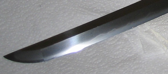

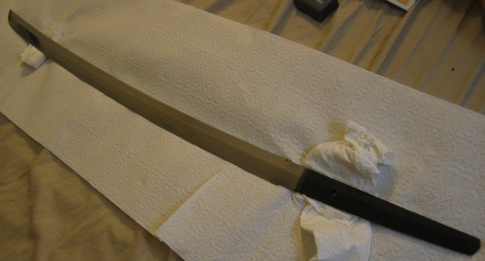

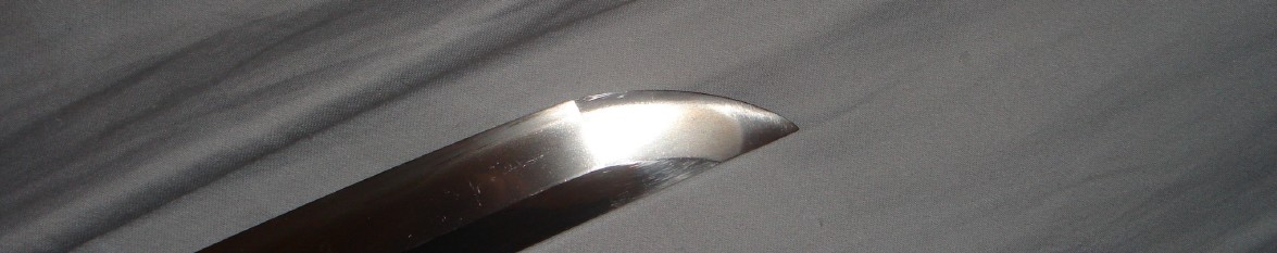

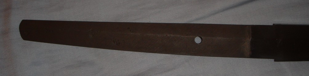

okay, i just took some quick pics, those are lookin just a bit better than horrible.. :(
it actually looks blueish grey under the sunlight in person, i've also seen some gold color during LED light inspection.
i can't see any flaws, kizu's at all, minor scuffs and surface oxidations that is.
it's very fat-so much of Niku- heavy sword.
CJ

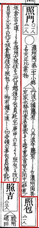

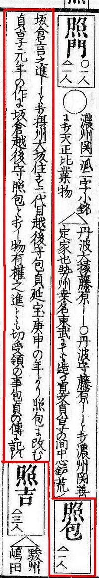

Sakakura Gennoshin Terukane and Echigo no kami Kanesada ... are the same person, ...
Aren't you getting a little ahead of yourself there? The vote of the "experts" is still out. But even *if* they are one and the same, you can't simply ignore the Kokon Kaji Bikô's rating: no rating is no rating -period!
Just to get the history of this smith correct. The shodai Echigo Kanesada had a student he eventually adopted who signed with the same mei. When the shodai died and his natural born son inherited the name Echigo Kanesada the hitherto nidai relinquished the name to the son and adopted Terukane as his name. Is this debated? When the natural son aquired his fathers name he was the sandai Echigo Kanesada, right? Name changes always seem to muddy the waters. John
Just to throw a possibility in the works here. Reading through this page: http://www.samuraisword.com/nihontodisp ... /index.htm and others...
A KATANA WAS DISCOVERED (AT THE TIME (PRE-WAR) HE WAS WRITING HIS BOOKS) THAT IS INSCRIBED “SAKAKURA GEN-NO-SHIN TERUKANE” ON THE OMOTE SIDE, AND “ARATAME, ECHIGO NO KAMI, KANESADA” ON THE URA SIDE (ARATAME MEANS: BEFORE / CHANGED). THIS CLEARLY CAN BE INTERPRETED AS MEANING HE CHANGED HIS NAME, FROM KANESADA II, TO “TERUKANE”, AND IMPLEMENTED SOME CHANGES IN HIS STYLE OF KITAE (CONSTRUCTION). FROM THAT TIME FORWARD HE WAS NOT KNOWN AS KANESADA II.
Is it not possible that when he worked as Kanesada, his style of kitae led to him being rated as o-wazamono, however when he changed the name, and subsequently his working style and kitae, his swords were not rated as o-wazamono anymore? That would explain the differences in ratings. Maybe the earlier works had better cutting ability than the later works? Just a feeble theory.
Brian
Hi,
Quote Fujishiro Shinto Jiten
TERUKANE SAKAKURA GENNOSHIN [ENPÔ 1673 SETTSU] SHINTÔ JÔJÔSAKU
He was a pupil of shodai Kanesada and later became his adopted son and inherited the name of Kanesada. He also followed suit with Echigo no Kami and signed Echigo no Kami Kanesada. However, due to the fact that one was not allowed to succeed to an official title without permission, in Enpô Hachinen (1680) Nigatsu he changed to Sakakura Gennoshin Terukane. Lately, there was a katana seen without an ura mei, it is thought that this was made around Enpô Hachinen. "SAKAKURA GENNOSHIN TERUKANE" could be seen on the omote, and "ECHIGO NO KAMI KANESADA" on the ura, and this is thought to prove that this is an actual fact. His works have a ji of ko-moku, hamon is notare midareba, suguba, sugu gonome ashi iri nado. Those with the mei of Kanesada have a gonome choji like that of the shodai. (Ôwazamono)
Signatures: ECHIGO NO KAMI KANESADA
SAKAKURA GENNOSHIN TERUKANE, ARATAME ECHIGO NO KAMI KANESADA
[TN]
SAKAKURA GENNOSHIN TERUKANE, ECHIGO NO KAMI KANESADA DÔ SAKU KORE
