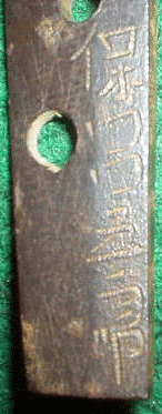

Okay, in order not to thread drift down memory lane completely, let's get back to John's sword. The signature reads "Hosho Goro". Fujishiro documents Hosho Goro as an inclusive part of, and alternative signature of Hosho Sadayoshi. It also is listed as an inclusive part of Sadaoki. A cursory look showed no examples for comparison for either smith, but I would encourage you to have the sword looked at. Even if the signature is questionble, Hosho works are generally not, and the signature could have been placed in attribution to someone from a very recognizable school. I guess if the mei were removed and it were a Hosho, it would be Sadamune by default. :lol:
Thank you for your welcoming me back (I'm sure, some others don't like the idea). I'll do some further research on Hosho-school; until then, you better believe Ted. He did a great job on the subject in his post. - As a footnote: I would like you to consider: Juyo Bijutsuhin is not an undeniable truth, for the criteria back then were based on derivation more than on quality and scientific expertise.
