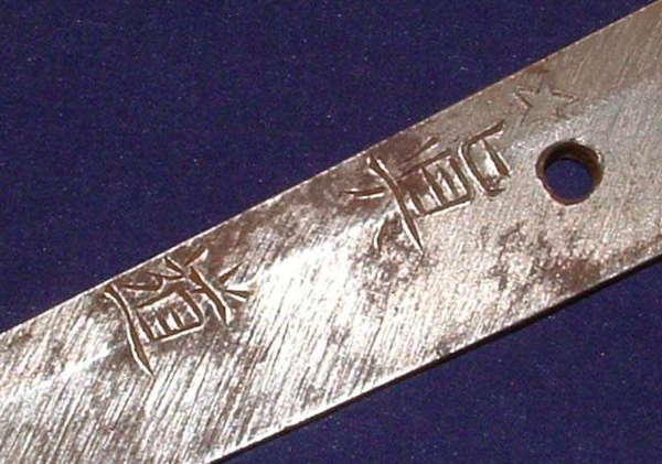

Hi guys,
I know the odds that a blade would match a random gunto scabbard is very low (but not impossible). I was wondering if with Type 3 blades/scabbards it is easier to find a matching couple.
I have a nice star stamped Masamichi with original habaki without any other gunto mounts.
I am tempted to buy a type 3 scabbard for it.
So if the nagasa, motohaba and sori seem to match, both blade and scabbard should feet together, or is it more complicated?
Thanks for your help
