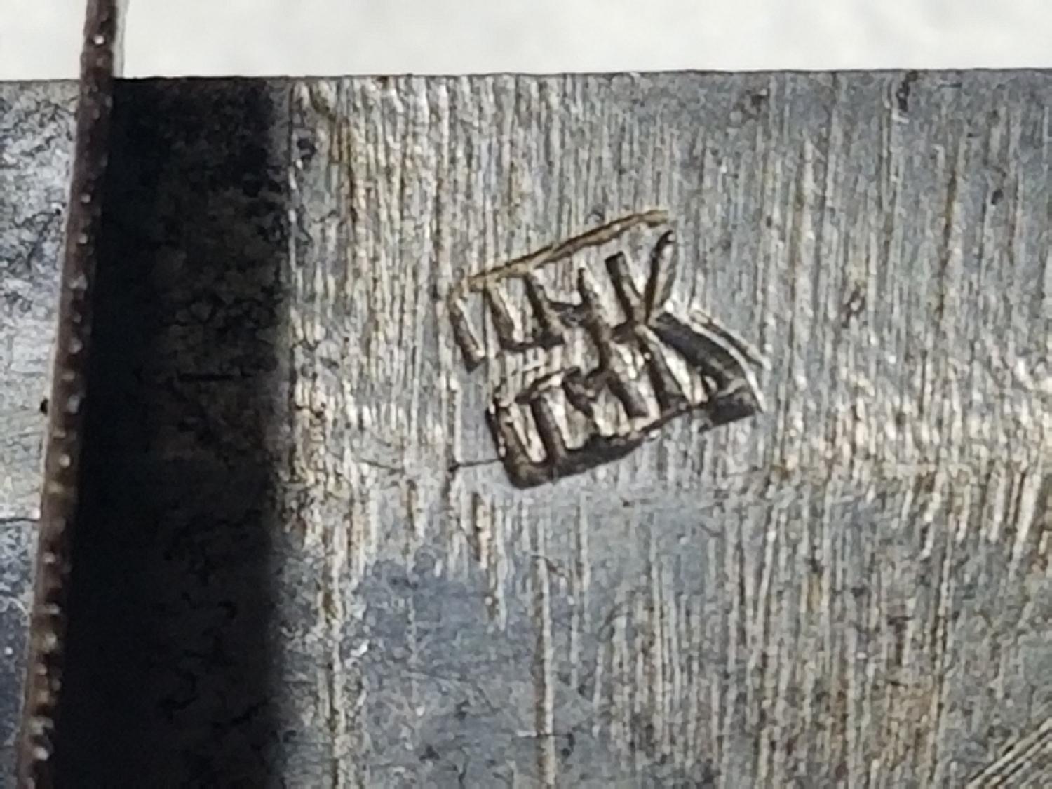

Greetings, I am new to the forum.  I picked up what I believe to be a genuine WWII Shin-Gunto sword and I started to research the tang markings and wanted to ask what some of them mean.  I believe I dated it correctly as a Showa period made in 1943 with no month markings. It has a Seki stamp.  The signature on the back "Mei" puzzled me.  I believe it says it was made by a person or in a province named "Taira" by a "Kami" Lord Grade Swordsmith.  I would appreciate and be very much interested to hear what you all can tell me about it.  It has a green scabbard.  I would have posted more pictures, but it would have been over limit on upload size.  Thank you for your help.

The key is that little stamp you see there. It is called a Seki arsenal stamp. Once you see this, you know the sword is wartime, and not 100% traditionally made. So made by a smith for the war, but using faster production methods.
Then once you know the name of the smith, you can look at the wartime smiths and find out which one made your sword. In your case, looks like Mike got it.

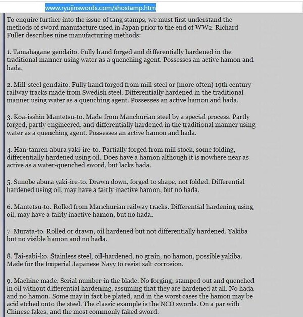

Brian touched on the "machine made" term, but to give a little more detail, all blades made during WWII were made by people. There was quite a shortage of blades throughout the war and to ramp up production (over 2 million were made by war's end) they started using hydraulic hammers and other machines to aid in the manufacture. The term is mostly used to describe "non-traditionally made" blades, which could have meant various things. I'm attaching a list of the 9 ways blades were made during the war. Any variation from the traditional way would have required a stamp on the blade. I'll also attach the lastest "Stamps Document" which goes into depth on the history of the many stamps used during the war.
