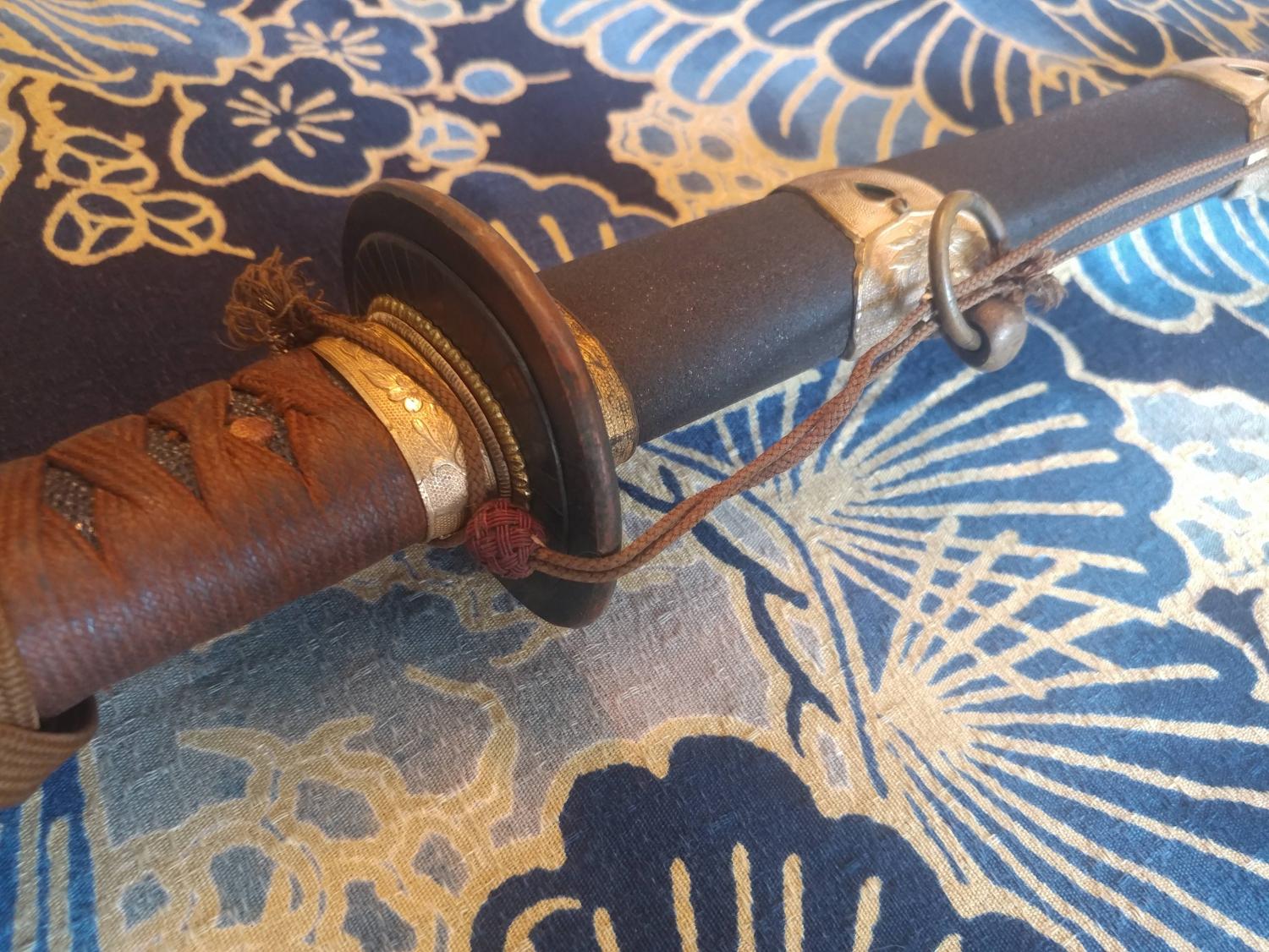

Hopefully I'm in the correct place. I recently acquired a sword for about 300$ and believe it to be a Kai-Gunto. If somebody could direct me to it's authenticity or any relevant information I would be very appreciative. I typically collect firearms and was presented this and though it was appealing so I jumped on it. I tried to take the best pictures possible and did not find any form of marks or signatures on the tang. Let me know if more specific pictures are needed.

Your blade was made in Seki. Nice example with a same saya and unusual chuso as Dave pointed out. Congrats!
EDIT: to the real specialists: the presence of that chuso and the (apparently) absence of stamp. Could this be a pre1937 blade?

It needs further inspection for flaws or what type of blade it is, but if you check eBay, Kai gunto usually go for about plus or minus $2000-2500. So that’s a very rough ballpark.
If it is a Gendaito (but I doubt that), I may go for more but in order to determine this, you need to post pictures of the blade naked, without Habaki, in its entirety and with close ups of the nakago and the Hamon. As I said, your blade was made in Seki. They produced many sort of blades from cut out blades to partially forged to rust resistant (often used in the navy) to fully traditional forging. The price will vary accordingly.
Cosmoline was frequently used by G.I.s when they brought back blades. I can be cleaned. I’ve never encountered it myself but heard it can be cleaned with oil. You’ll find a care and maintenance guide here:

JP, just curious how you determine it's a Seki blade. I'm pretty uneducated on that stuff. It's hard to say about the date/non-stamp. It may simply not have a stamp because it's traditionally made. But to your point, stamps didn't become the norm until 1940, so, if it's not traditionally made, then lacking the stamp puts it 1940 or earlier.

Officially called a Type 97, Kai-gunto. I'd say the owner paid some extra money on this with the shark-skin saya covering, the chuso, and that custom seppa. I can't tell from your picture if the blade is traditionally made or not, but it does have a beautiful hamon!
Other guys may know more on the "feather pattern" on the nakago (file marks on tang), but they are not very common on military blades in my limited experience.
Gunto prices have been falling the last couple years. Today, these go from $1,200 to $2,400 depending on condition and the buyer's interest. Yours has expensive upgrades, but the gold-gilding is mostly gone, so I'd put it around $1,400 +/- .
Bruce, most of the time, Seki swordsmiths used a takanoha pattern on the nakago, so chances are great it was made in Seki following the Mino tradition.
Moreover, there are togari in the Hamon, also typical of the Mino tradition.
But I’m no expert and could be wrong.
I think alcohol (rubbing, denatured) and a soft cloth will work to remove the cosmoline and won't damage the sword.  As there is more cosmoline inside the scabbard you will have to remove it more than just once but eventually the blade will come out clean.

Kai Gunto with Seki-To seem to have a Chuso retention system more so than any other blade type. The standard method was the thin retention cord that is ubiquitous in period photos but oddly enough rarely found extant on swords today. Whether soldiers in the field discarded them, G.I's discarded them or they simply fell apart and were lost is hard to say, but they were the official retention system for Kai Gunto.
