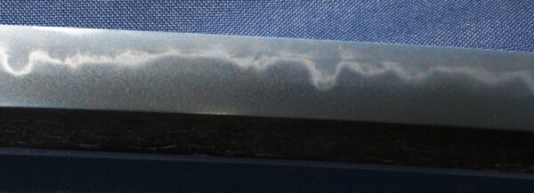

Just for fun, here are two swords by the same man...both photographed from side-on...which polish do members prefer?
Regards
  • Like 4

Ted, that is a long and very relevant discourse on the quality of polishing and the techniques used and the viewers ability to judge quality, but that is not what my comment was about...I merely said it is a shame that sashi-komi is "gone".
To emphasise my point i showed pics  of 2 swords by the same man  in both polishes and asked members for their opinion on which polish they preferred...only one answered, why? are the members afraid to comment? Here is another observation on the quality of  polishes... you only have to look at sword shop sale catalogues 1960-1980 and compare them with "current" catalogues. The old ones showed 1 or 2 clear photos of the hamon/hada etc (usually polished in sashi-komi) and a written description...now catalogues show a dozen or more pics of a (usually) hadori polished blade and nearly always include an oshigata of the blade activities because the pics are not able to do so adequately . I think this alone says a lot about the decline of polishes....why continue to polish blades in hadori which does not show the hamon clearly?...cost/profit!

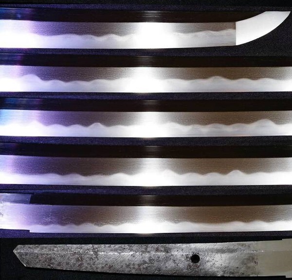

I wonder if Darcy or RKG have high-resolution, well-lit blades in opposite polishes, preferably from the same tosho, but at least from the same school?
If that was the case, one of the swords didn’t receive the proper polish - I don’t think Darcy would go for anything like that ...
Regards
I'll answer;  from the images, I don't like either one.  The habuchi is clearly obvious on the sashikomi, but I can't tell if there are any finer hataraki, and the hada doesn't thrill me.  The hada on the hadori looks better, but the hadori on the yakiba doesn't look well done or is perhaps compromised by age.  So again, *from the images* neither one thrills me.  So because we cannot fully appreciate a three-dimensional artform in a two-dimensional medium, we're stuck choosing from the most obvious visible features instead of the work seen in a unified whole.
So looking at two different swords in images that neither can fully illustrate properly and asking which is better, is a bit like asking someone if they can tell from the sound of galloping hooves in the distance if it's a horse or a zebra.

George, all due respect, I recognize, support, and concur you are certainly allowed to like what you like.
I was going to let it go, but I will answer..
Yes, we all concur that all are allowed to like what we like.
You don't like either one....I like the sashikomi on the left.
