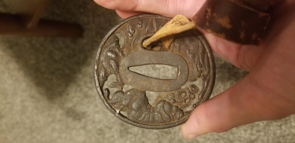

Signed tsuba curious about signature

With the greatest respect I do not think you have got your eye in yet as regards tsuba.  Look at the chipped mimi, the surface of the seppa dai, the quality of the carving of the mei and the general  quality of the design.  Look inside the edges for evidence of a casting seam. I do not think it matters what the mei says, it matters what the tsuba says.
Keep looking.
All the best.
Yeah, won't argue I don't have a refined tsuba eye. My eye however has always liked folk art more than fine art. To me though, it's actually a pretty creative little design. Fun gaps, the water details look good. The horse is odd, done with more expression than realism. Knew I didnt have any great artwork here but liked the style of the guy. Looked around for a casting seam or a place that shows evidence of a stem from pouring into a mold but didnt see one, but then again not 100% positive if there are variations of what those look like. It came on a sword with a horse menuki, so goes with the theme. I'll do some reading and look through the for sale forum here for tsubas and get some tsuba eye research in and do some reading.

Peter, perhaps overly harsh. Adam hasn't argued like many, and I don't think deserved the criticism.
Better to point out the features that point to this begin cast. The average novice won't recognize that soft and uneven looking seppa dai, with striations typical of the cast ones. The lumpiness of the design, without any real definition.

Your tsuba is a legitimate, late Edo period (+/- 1800) fitting. At that time, quite a few men in Japan were expected to wear a sword. Even impoverished men could - and may have had to - wear a short sword. In my opinion your tsuba was the sort of fitting that could be available to those men.
As you know, your tsuba is signed with the name SOTEN. It also has clear characteristics of having been cast rather than carved. That is to say, it was something like a mass produced product rather than an individually crafted accessory.  "Soten" describes a group of workshops that made and marketed a distinctive style of tsubas that were popular and appropriate to most situations. They were the tweed sport coat with Dockers of the era.
Soten guards also came in a wide (!) range of qualities At the high end Soten guards are individually created - and worth a lot of money. At the low end, basic Soten forms seem to have been cast of iron. After casting, these guards would have been cleaned up by hand and then moved on.
The cast iron blanks were made with flat facets so that they could be shipped on to Soten workshop for further work. Some "gold" nunome highlights  could be added. But the real hall mark of the Soten guards were soft metal highlights - faces and figured - applied over the iron. These highlights could be knocked out by apprentices and then soldered on to the iron blanks. Look at your tsuba. See those two flat areas right in front of your thumb in the middle picture? I think that is were figures could have been added - but weren't.

Water under the bridge, as a horse and some clouds go by on a cast soten tsuba. I understood the intent behind your original message and take no offense. I truly do appreciate the knowledge imparted by the experts here as it is a gift of learning that they do out of a passion. I realize that I did not respond in an educated way but rather a subjective way in my original response which was due to the fact that it takes time to follow up on the learning portions imparted by the experts. For example I went off of Geraints original response and googled all the terms/observations he used then was able to immediately apply them to my own little tsuba. It was in essence a shortened lesson he gave that I was was able to apply once I had a private bit of time to invest in the learning. Your example you shared led me down another little link pathway to explore and read descriptions, styles, variations etc... your latest message actually gave me a glimpse into the culture and climate of those times. Reading can be linear and discussions can be dynamic, but with both in tandom one has a more interesting/fulfilling learning experience. So thank you all. I personally have no one around me in my area who has any interest or knowledge in these things to share with so if you ignored the post I wouldnt have learned from you and therefore I'm grateful you didn't.
