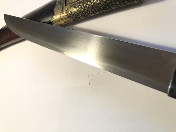

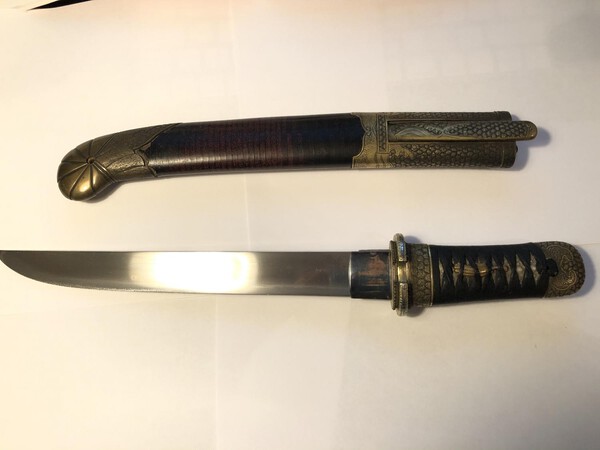

Thanks for your answer. I am new to the site and i need help. Here is a photo of blade and mounting. It is a mumei blade
* Provenance
Taken to Sweden by doctor Karl Rudberg participants of the world tour with Vanadis 1883 - 1885. HMS Vanadis was Sweden's first and only steam frigate.
shinshinto/meiji ?
nagasa 9 inches
ubu nakago
1 mekugiana
jihada itame masame
hamon suguha / komidare
