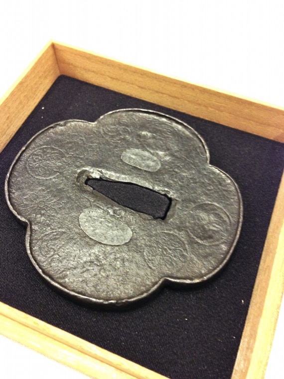

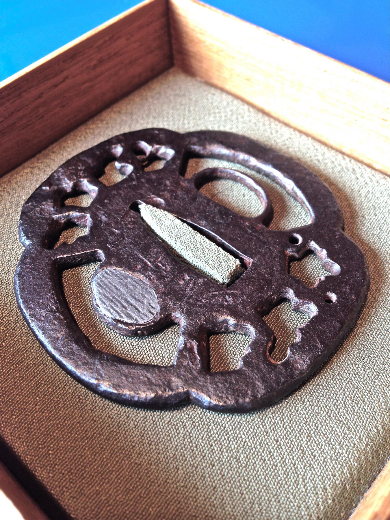

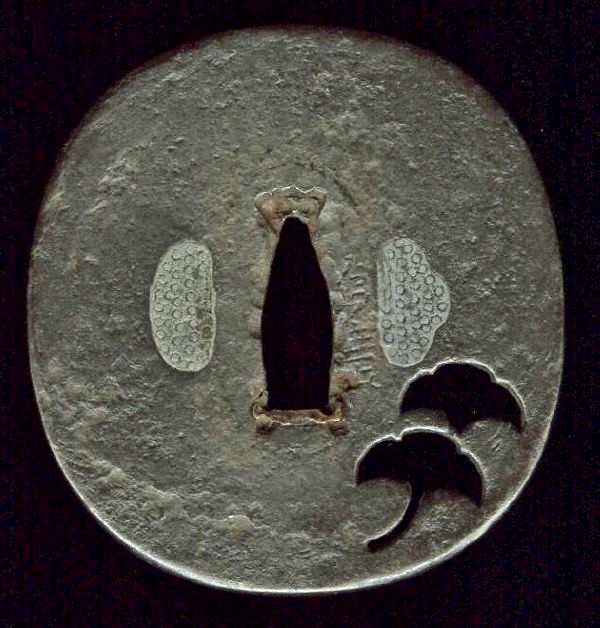

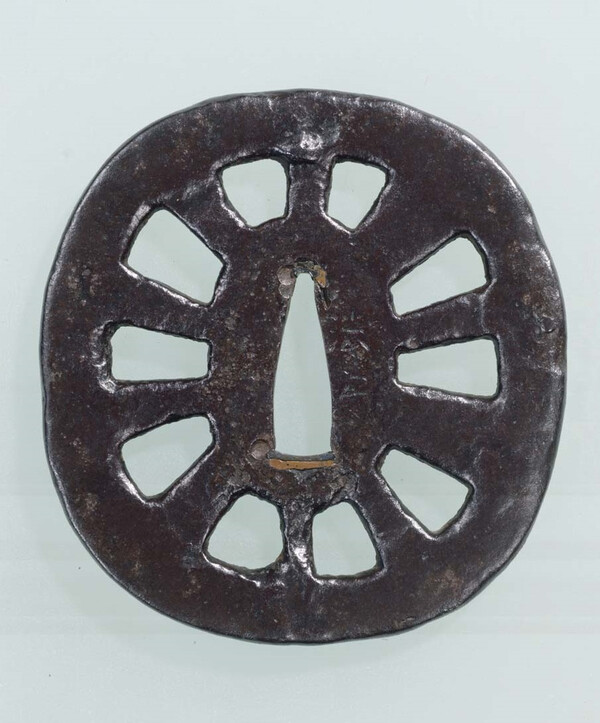

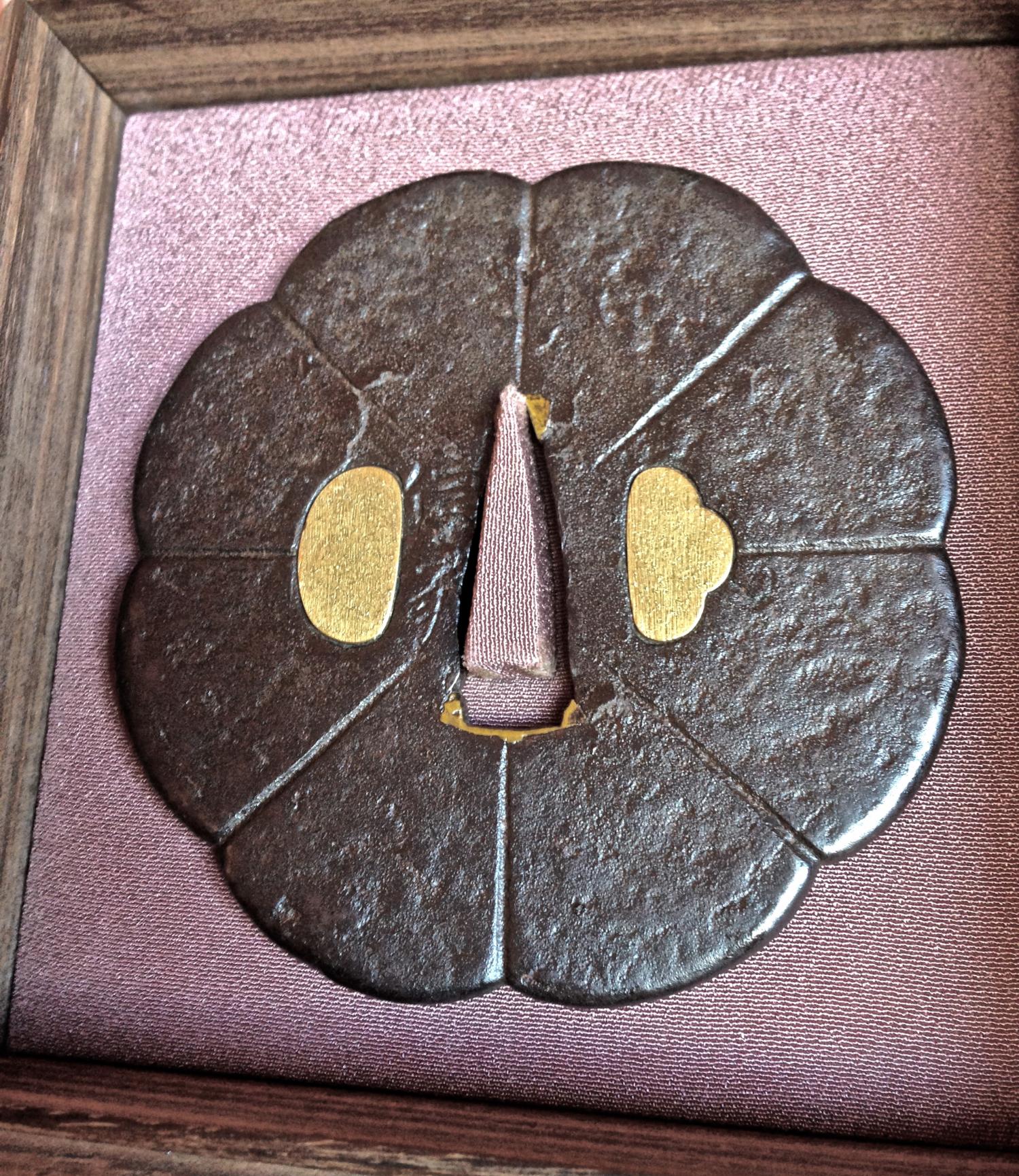

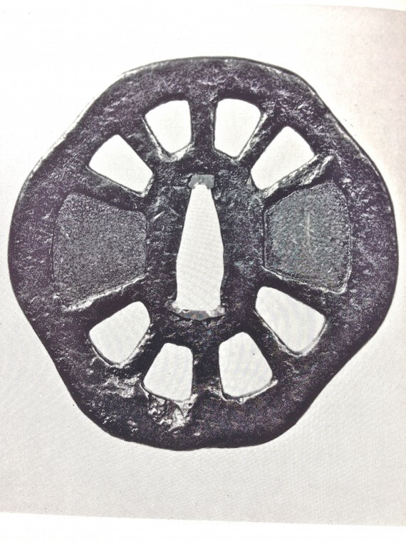

They say a picture is worth a thousand words...  Thought I'd throw a few thousand words into the conversation... ;-)
#1  Shodai (Hanare-mei) Nobuie
#2  Shodai Nobuie
#3  Nidai (Futoji-mei) Nobuie
#4  Nidai Nobuie
#5  Yamasaka Kichibei
#6  Yamasaka Kichibei
#7  Yamasaka Kichibei
#8  Meijin-Shodai Yamakichibei
#9  Shodai Sadahiro
#10  Shodai Hoan
#11  Nidai Yamakichibei
  • Like 7
