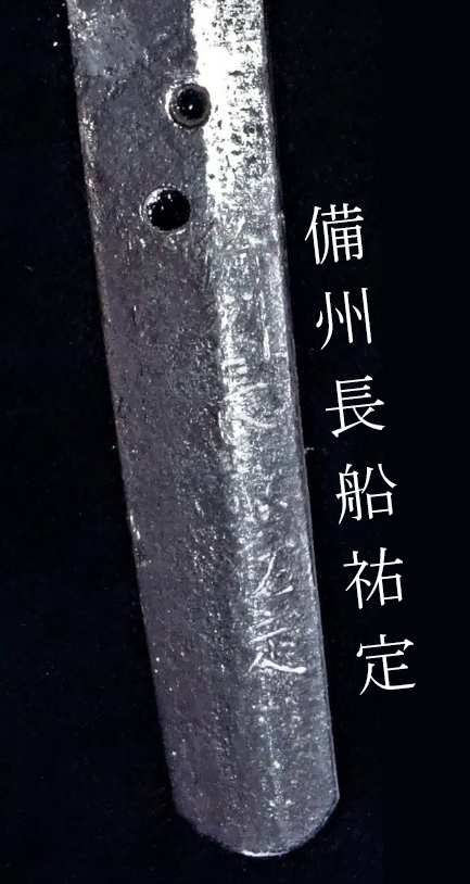

A 500 year old blade? Known maker?
waljamada

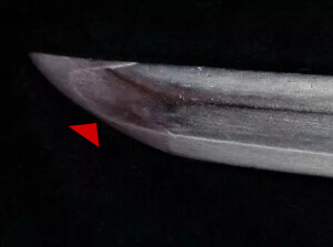

I appreciate the advice. On top of the blade (I actually like straight hamons most) I like the guard, the family Crest is a bonus and the fact the sword is over 27 inches but do want my next purchase that would hold its value to both a seasoned collector's eye as well as the casual.
I think this sword will NOT hold its value. It was a mass produced weapon that does not reflect or represent the artistry and high craft of Japanese swords. The tsuba is a nice example of a type that has attracted some attention. And the recycled WWII era menuki with a family crest are mildly interesting. But I doubt that there will ever be serious interest in this sort of sword.
Peter
