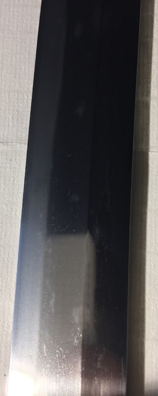

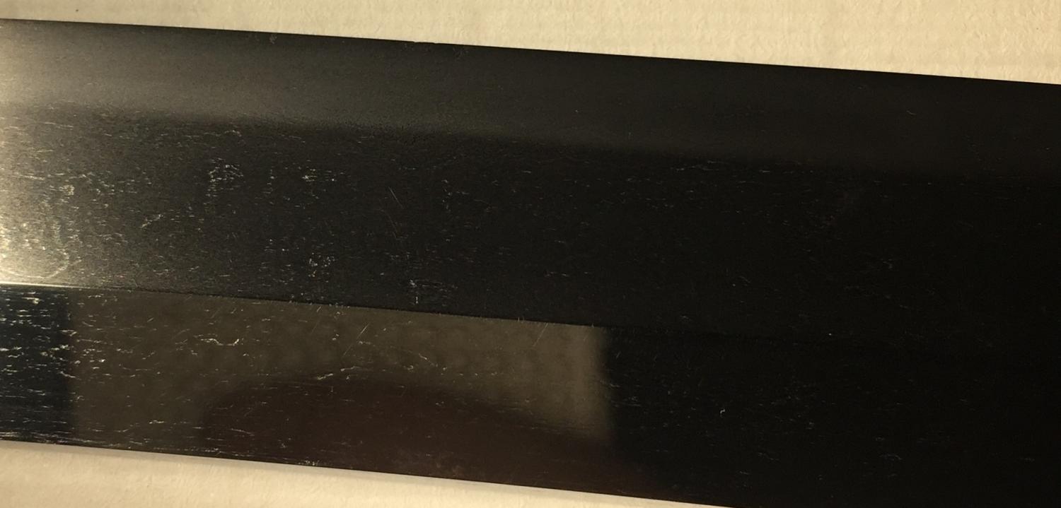

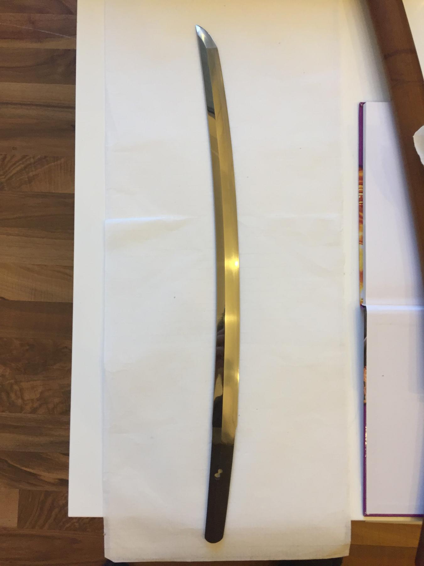

Wakizashi with white spots
DoTanuki yokai

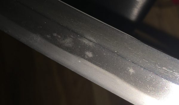

That is the result if someone use the wrong oil !
Especially in Germany many people think that the cheap WD40 is good for conservation of steel!
It is not !
In this oil some aggressive elements etch the surface and the result is you have these white , blind looking spots on the surface.

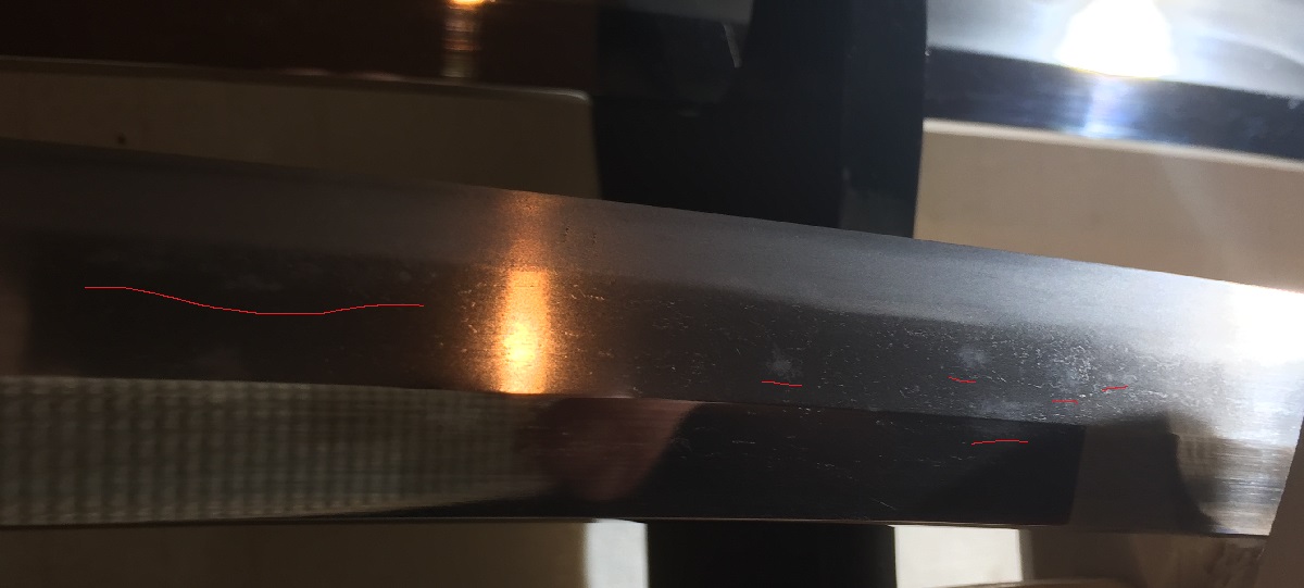

in the red marked area you see white spots in the Hamon !
That mean to me that the spots can´t be tobiyaki.
That was the reason why i write that it might be possible that someone use agressive oil and damage the surface.
And here is a exampel of a blade where the owner tell me that he use WD40 for conservation .........the result is terribel !
I have see this blade absolut clean , without these white areas 6 Month bevor by the previous owner.
But .....these are just my two cent´s

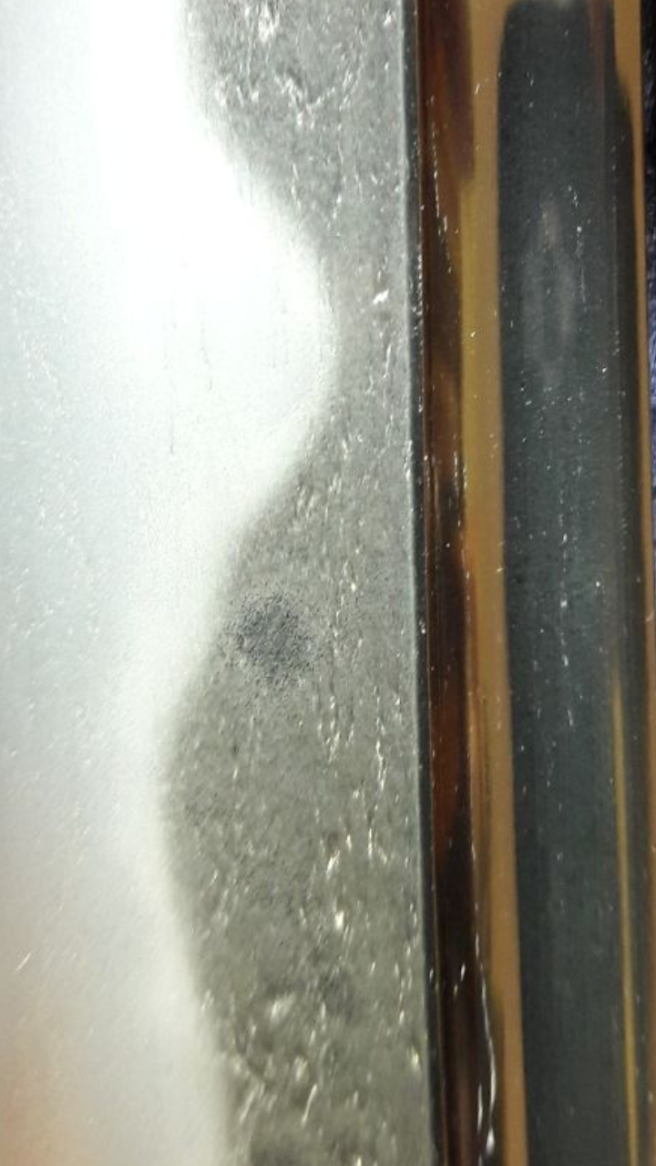

Sometimes white spots are actually little areas of black nie (tobiyaki?) Or similar
Usually in the dark, using a LED flashlight, you can see that theyre actually black spots.
Then again it could be anything. Scratches, old removed rust spots, a bubble under the steel, etc...
Here is what the "white spots" really look like under certain light. Little clouds of Nie
