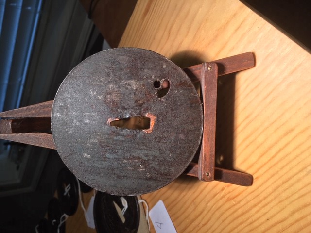

Here is a quick before and after comparison of a very thin touch of the wax to a dirty guard. In the old days, we could find masses of dirty "as found" tsuba and there was a role from this sort of stuff. Mebbe not so useful in this era of well organized and thoroughly assessed stuff.
Peter
This stuff was made to be quick and easy and it is quite removable. It is far easier to remove than renaissance wax, I think.

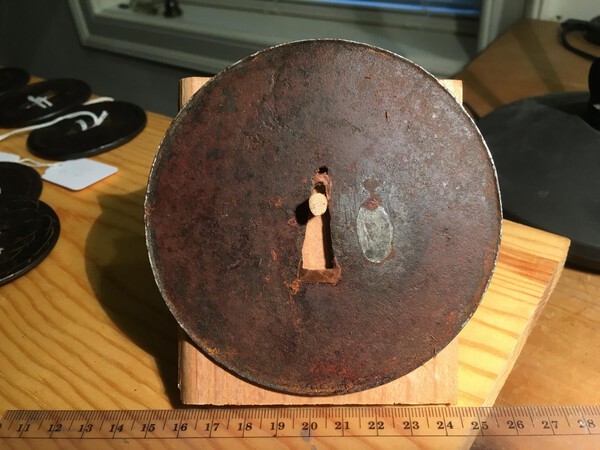

Please let me post another before and after (I'm trying to get ready to start sell some tosho tsuba and trying t0 get the orientation right)
notice that the wax cleans the surface and kills red rust, but does nothing to holes in the patina. That means to me that it is less strident than etchants (feric cloride etc etc) that have been used and suggested.
