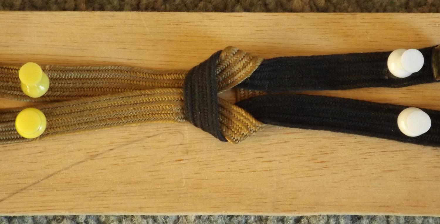

Dear Steff.
You can sure pick 'em!  Managed to find one image, (In Markus Sesko, Encyclopedia of Japanese Swords), and did a mock up of the knot to show how it works.  It is not something I have ever seen.  What makes you so keen to try this wrap?
Hope this helps.
All the best.
oh nice thanks very much Geraint.  I think it looks awesome, and I think it would totally go with the sword I,m trying. generally I seem to make life difficult for myself by wanting something other than easy options. I,m surprised there aren't more people who do this stuff tbh
