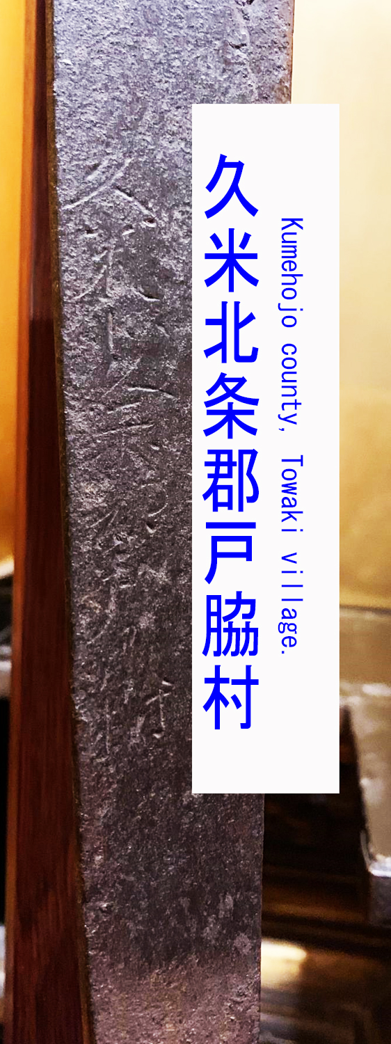

reverse side
久米
Kume (illegible)
This is a votive offering (奉納), to one of the many Tenman shrines in Japan. The one that comes to mind is the Tenman-gū shrine in Osaka, dedicated to the ancient scholar Sugawara Michizane (aka Tenjin). Sakushū Tsuyama is a place name in Okayama prefecture. It would have been in Mimasaka-no-kuni in the old days, which is abbreviated here as Sakushū. Shōtoku 2 (tatsu = year of dragon) is 1712. I can't quite pick out the month and date, but it looks like August 13th. A closer shot would remove any doubt. I can't read the part at the bottom, so I'm not sure if it is a name or more location information. It has what kind of looks like a kaō at the end, but I think the name of the smith is on the other side.
On the other side is what looks like 久米 (Kume, which is a location name, and by extension a family name) associated with Tsuyama. But I can't figure out the bits after that. This part looks like it would be the name, but I can't be sure.

And other side says:
久米北条郡戸脇村 (Kumehojo-gun,Towaki-mura)
Kumehojo county,Towaki village.
