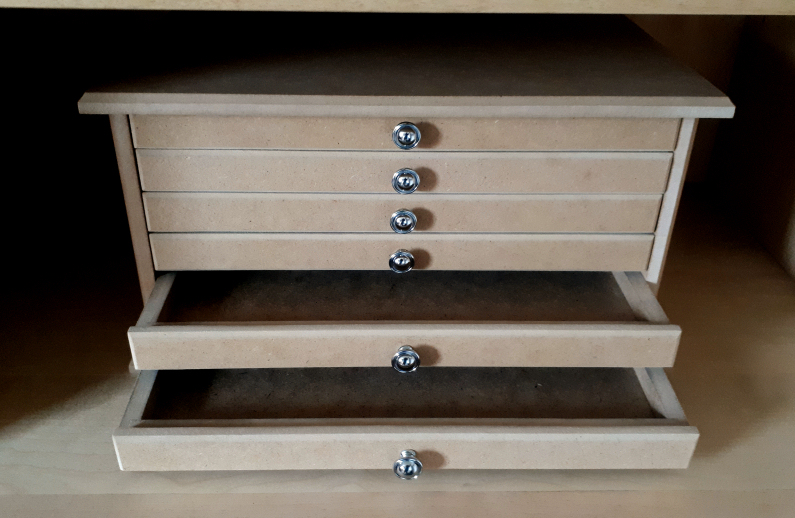

Relative cheap Tsuba Collector Box.
By searching for another tsuba collector box, i found one under the search for coin boxes and bought it.
The price of 75 EUR incl. shipping  is not expensive for the work. The 6 drawers box is very heavy, much more you expect.
The box is made in poland under the brand "Schulz" (no not the Dr. Schulz from the Tarantino movie) from the company Marstol and of very good quality.
I bought it not veneered and not colored. The material is mdf and didn't smells like chemicals (formaldehyde) or something you know from older mdf plates. The smell is wood, nothing else.
I think it has a classic design and fits as a tsuba storage.
The box has place for 36 Tsuba.

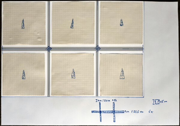

Here is the material plan for the drawer insert.
You need:
6 x 33,5 cm, wide 2 cm, height 1,5 cm wooden battens
12 x 23 cm, wide 1 cm, height 1,5 cm wooden battens

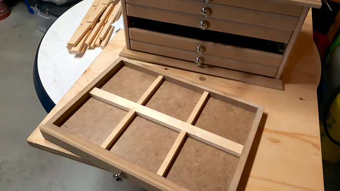

Today i bought the battens. Cut them and made the sections for the drawers.
The sections are 10,4 cm x 10,4 cm so there is some space for the plates to fill with the pillow.

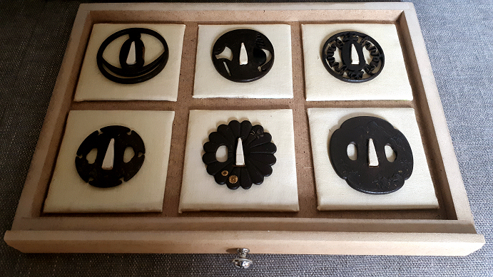

After glueing with wood glue use some force to tighten the fabric.
When you are finished it should look like this.
