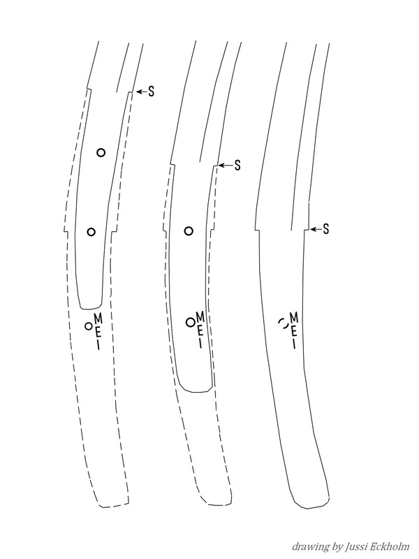

The sword (bare blade as whole) is called tōshin that includes the blade & nakago. While sori is used for curvature between munemachi and tip of kissaki there is also nakago-sori that can be measured. I wish I would be good at drawing it would be easier to explain than with words. But at least I tried to make a few pictures. Of course the scale of those is bit off.
Different sori and nakago-sori will have a huge effect on the overall sugata of the sword. When you calculate blade curvature you can take two measurements. Regular sori and also from the butt of nakago to the tip of kissaki. With swords of very large nakago curvature this will of course produce large overall curvature to the sword even if the sori is small and vice versa swords with very big sori but small to none nakago curvature will not produce a pronounced difference when measured like that. The name for measurement from nakago butt to tip of kissaki is called zencho 全長 but I am not aware what the full length curvature measurement is called. But here is a picture showing how shortening will also affect sori as measurement point moves upward and it affects the overall curvature even more. I tried to fit in my drawing that when shortened enough neither of the holes remaining is the original one as it has been lost with the signature.

Nice drawing Jussi. As can be seen from the picture any shortening will always reduce the value of the sori  and in some cases can change the point of maximum sori to a much different location.A large amount of shortening could turn a koshi- sori piece with fumbari into a tori-sori piece or turn a saki-sori piece into more of a tori-sori. If one is going to use the sori value to make comparisons for kantei purposes, you need to know where the machi was with a high degree of certainty. Fortunately most blades are not shortened to the extent where it would make too much of a difference and it is a useful kantei factor.

I have a Muromachi Soshu Blade that is torii sori. Yet, when you hold it in front of you, bare, you’d swear it is a koshi sori. Obviously, it was a tachi in another life that got greatly shortened and machi okuri subsequently. If I take into account the nakago, it becomes koshi sori. So I guess that taking the nakago into account is a great way to imagine what the blade used to be.
Now, there are pitfalls here! But I’m pretty sure this way of thinking is helpful in getting a further notion of the original sugata.

Hi Jussi if you allow i bring your drawing on a white paper. If someone will print it for studying.
Thanks for your work.
