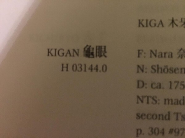

As regards the metalworkers signature it reads "Kigan" plus kao. Haynes has a couple of artists using this "Ki" and one using this form of "Gan" but only one signing "Kigan" but using a different kanji for "Ki" (photo attached), it might be the same guy who changed his signature at some point, but I don't have any more information. As you can see, the one Haynes lists is from the Nara school and someone who knows better than me might be able to tell you whether or not the workmanship on your fuchi points in that direction.

Finally found 'Ki' (or 'oni'):   Haruaki Hogen no Zu Kigen Kao  (design from work by Haruaki Hogen, made by Kigan (kao).
I can't find anything on this maker so by the workmanship (the carving of the mei is somewhat crude) my best guess would be an unknown or possibly amateur maker.  Perhaps someone else will find something more definitive.
