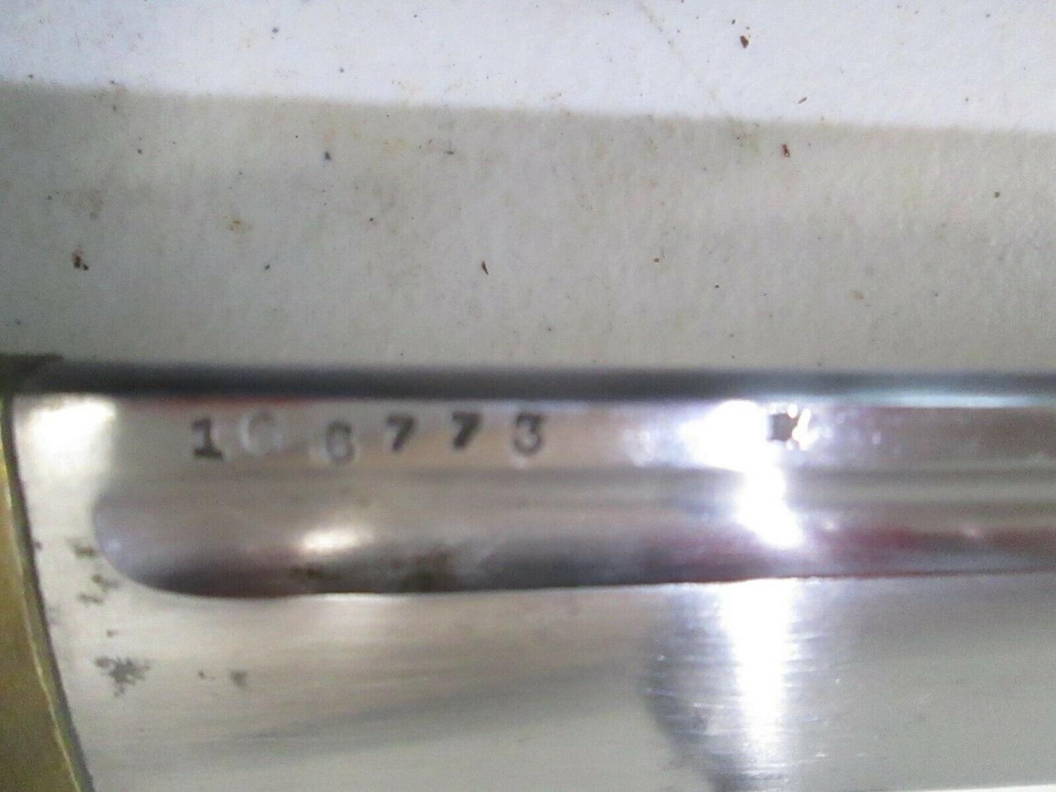

Bruce Pennington Posted January 13, 2020 Report Share Posted January 13, 2020 Some additions here... The "一 within a cherry blossom" also appears in the 47k-49k range for both Std issue (Brass Tsuba) and Contingency issue (Steel Tsuba) Ok guys, here’s an Ichi stamped 95 in the 100,000 range! 106773 to be exact. fleabay: https://www.ebay.ca/itm/WW2-Japanese-NCO-OFFICERS-SWORD-MATCHING-NUMBERS-ON-BLADE-SCABBARD-MINTY-C13/402003773216?hash=item5d994ac720:g:qpIAAOSwOzld-5Qv Quote Link to comment Share on other sites More sharing options...

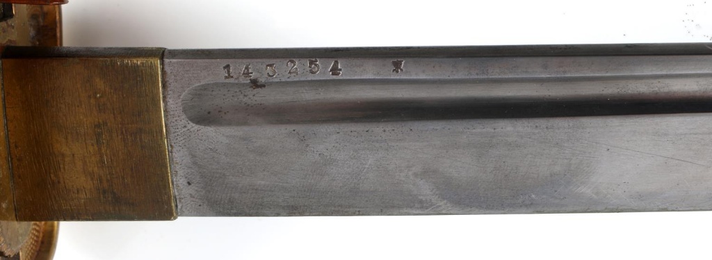

Bruce Pennington Posted May 12, 2021 Report Share Posted May 12, 2021 I believe @Stegel in another thread, said the Ichi serial range ran out to the 160000 range. Here's one at action with 143256 number. I'll link the auction, but that's going to be out of date once the auction is over. HERE Quote Link to comment Share on other sites More sharing options...

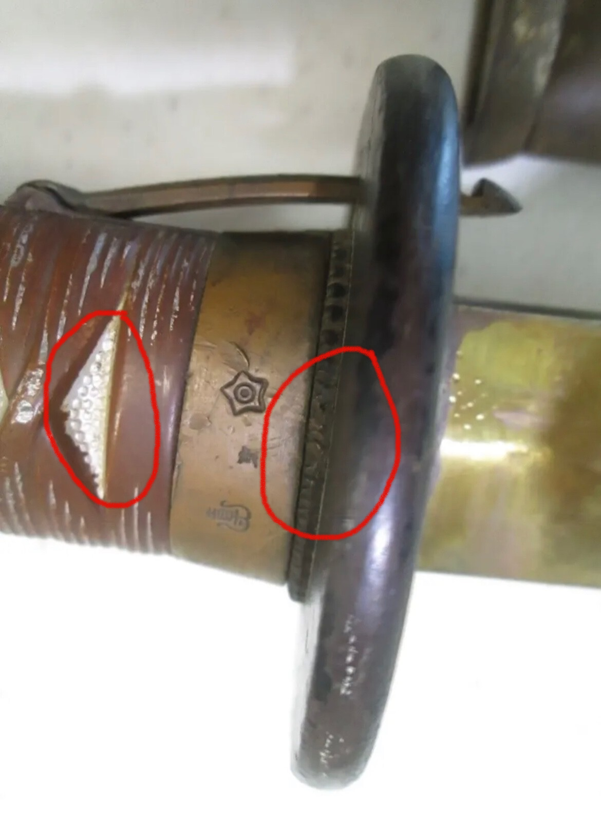

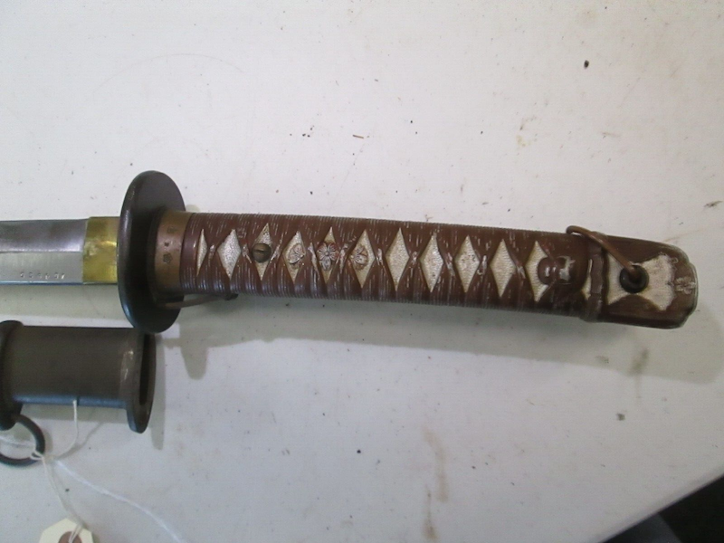

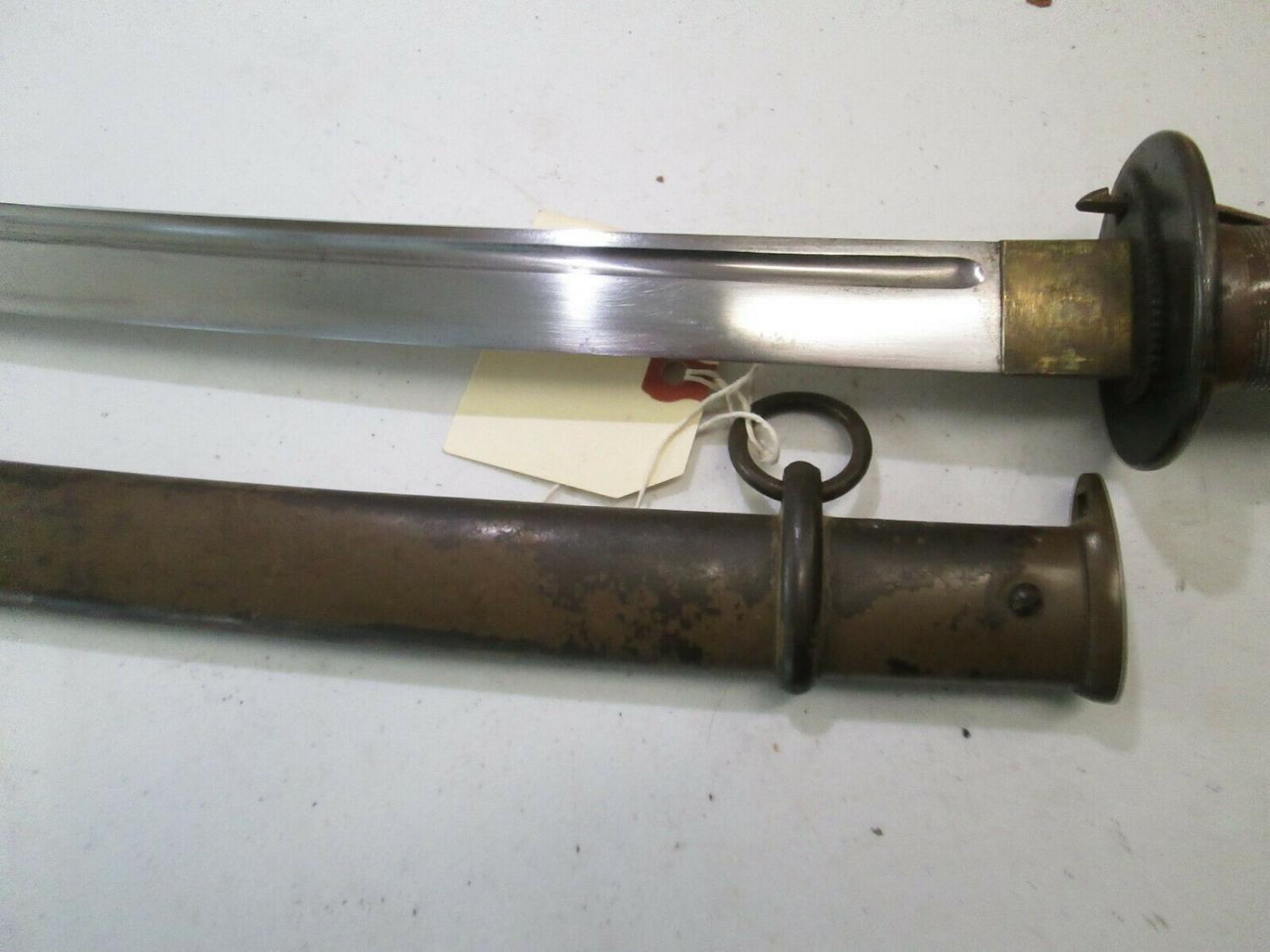

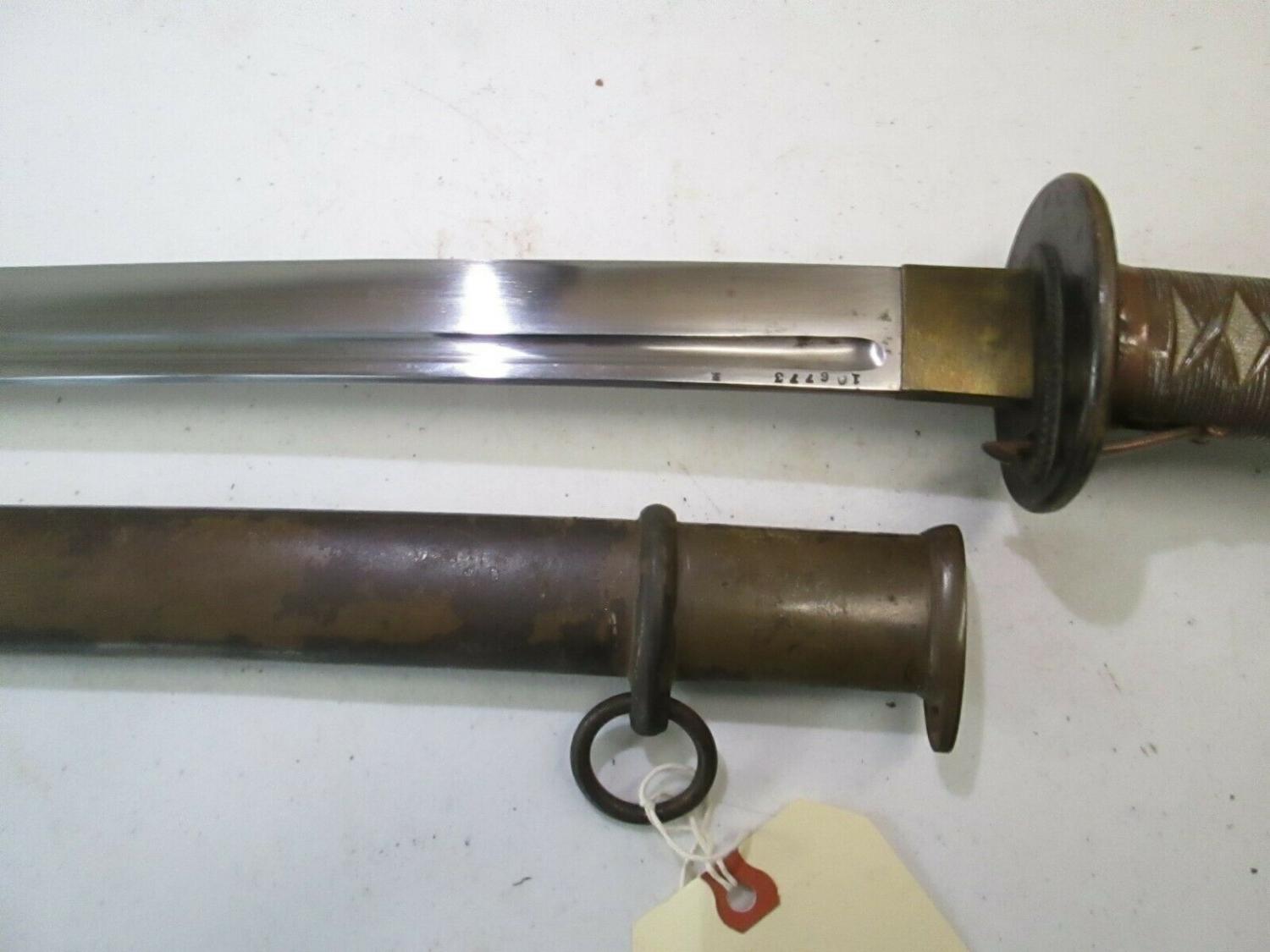

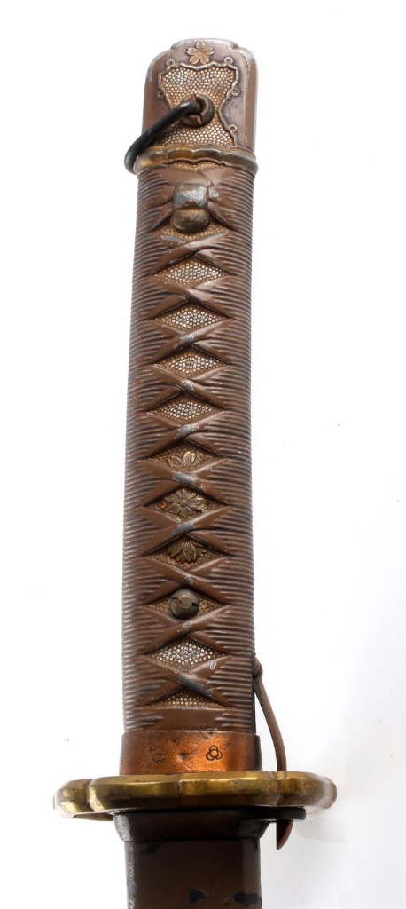

Conway S Posted July 21, 2023 Report Share Posted July 21, 2023 I just wanted to repost this in a more applicable thread. I am wondering if anyone can contribute an opinion as to whether the handle has been repainted and if it looks like a period job or later. I noticed little spots of brown overpaint into the white Same areas and close to the menuki. I do not collect these and am I just trying to learn what features to scrutinize. Thanks. Conway On 7/19/2023 at 11:22 AM, Bruce Pennington said: Photos added for future reference Quote Link to comment Share on other sites More sharing options...
Conway S Posted July 21, 2023 Report Share Posted July 21, 2023 Quote Link to comment Share on other sites More sharing options...
Bruce Pennington Posted July 21, 2023 Report Share Posted July 21, 2023 Conway, there seems to be plenty of wear & tear on the paint, so I'd guess it's original. Quote Link to comment Share on other sites More sharing options...
vajo Posted July 21, 2023 Report Share Posted July 21, 2023 Inverse nanako, crude seppa, a long sarute. I have my doubts about this sword. I don't like the numbers on the blade too. Quote Link to comment Share on other sites More sharing options...
robinalexander Posted July 22, 2023 Report Share Posted July 22, 2023 Chris, I like your observations.....is it possible the long sarute could be added or variation and the seppa damaged? That said, I definitely agree with you re the inverted nanako...your eyes are probably better than mine but I have never seen that on a genuine 95. This point alone would be a deal breaker for me. And the numbers don't sit well with me either but there are some weird variations. If it's a fake, then they are getting good. Quote Link to comment Share on other sites More sharing options...

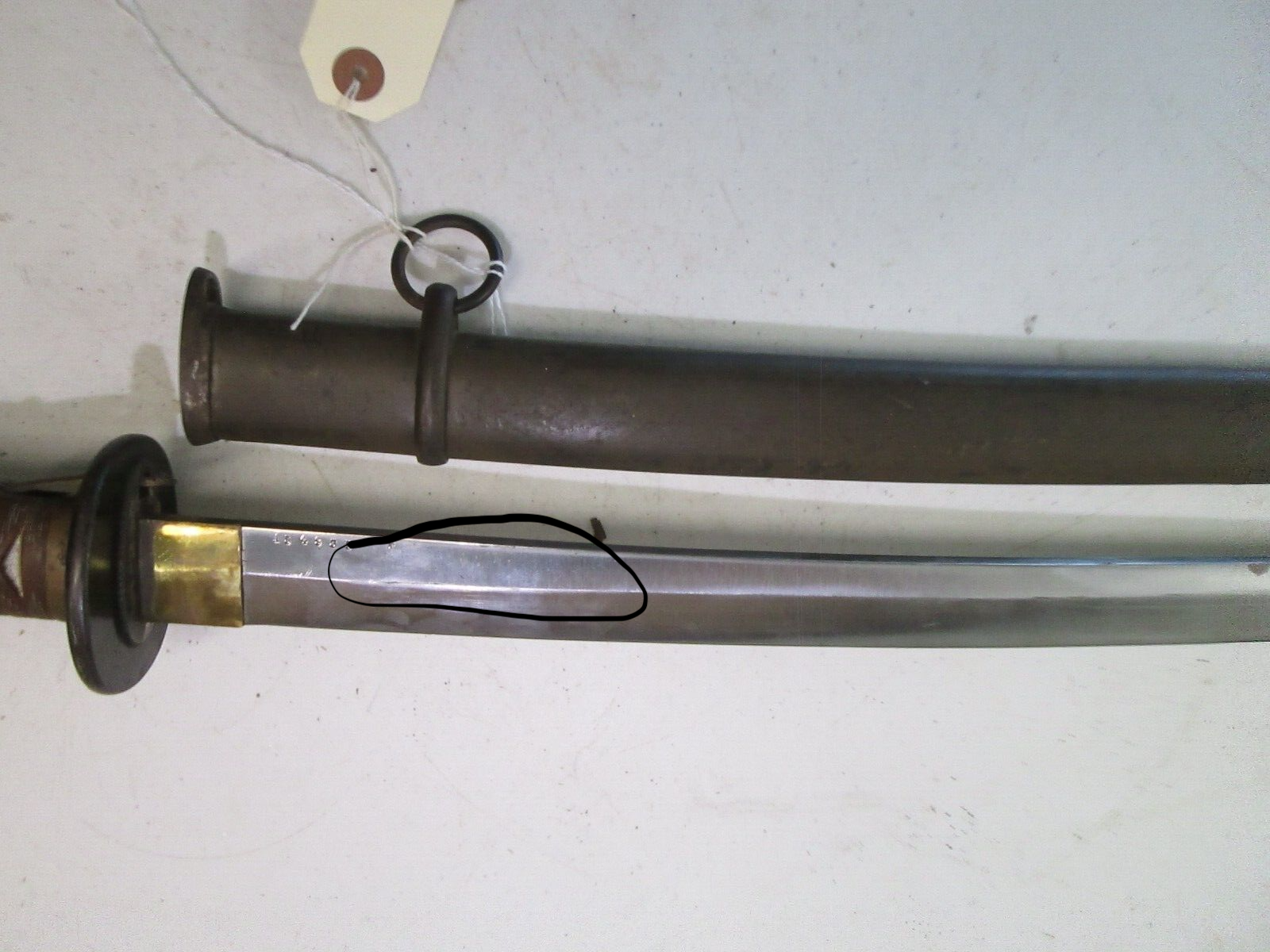

Stegel Posted July 23, 2023 Report Share Posted July 23, 2023 i wonder what happened to the bohi?? 100% original in my opinion Quote Link to comment Share on other sites More sharing options...
vajo Posted July 23, 2023 Report Share Posted July 23, 2023 2 hours ago, Stegel said: i wonder what happened to the bohi?? 100% original in my opinion That one Stegel? I can't belive it is genuine. For me it looks fake. But i learned every day something new. Quote Link to comment Share on other sites More sharing options...
Conway S Posted July 23, 2023 Report Share Posted July 23, 2023 4 hours ago, Stegel said: i wonder what happened to the bohi?? 100% original in my opinion Quote Link to comment Share on other sites More sharing options...
Conway S Posted July 23, 2023 Report Share Posted July 23, 2023 @Stegel To me that area does not look entirely straight. I thought @vajo made a good point about the inverse dimpling on the handle. Have you seen this before on other Type 95s? I know you are one of the resident experts on these. Not doubting your opinion just trying to learn from those who know. Thanks. Conway 1 Quote Link to comment Share on other sites More sharing options...

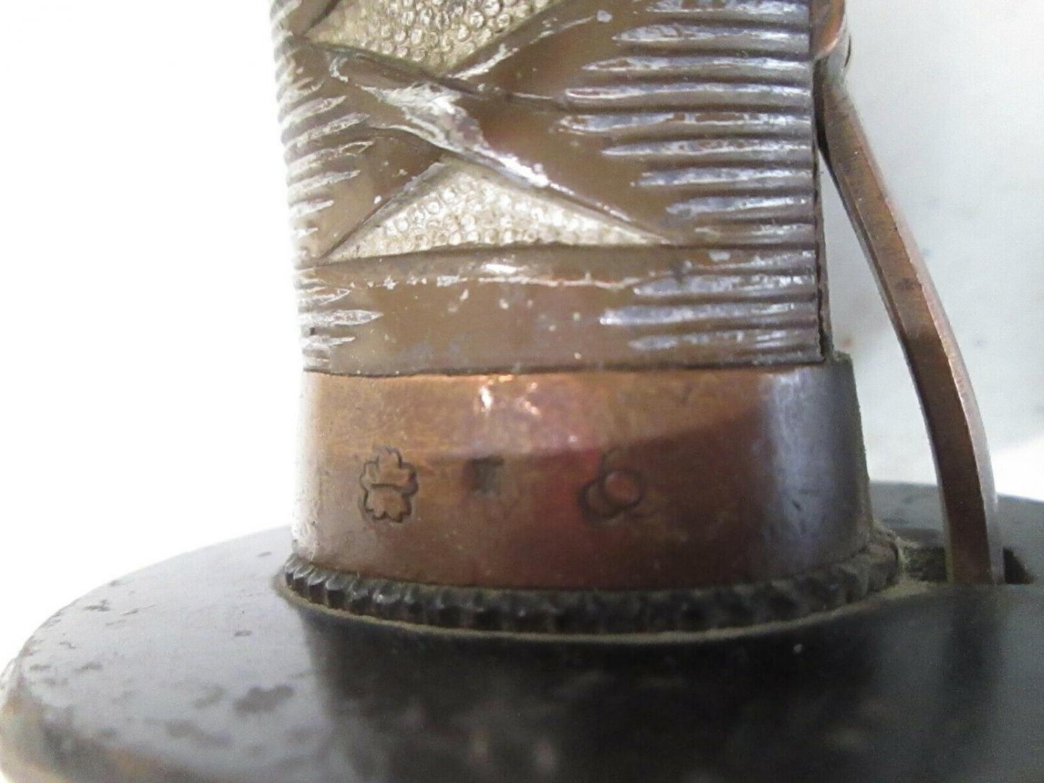

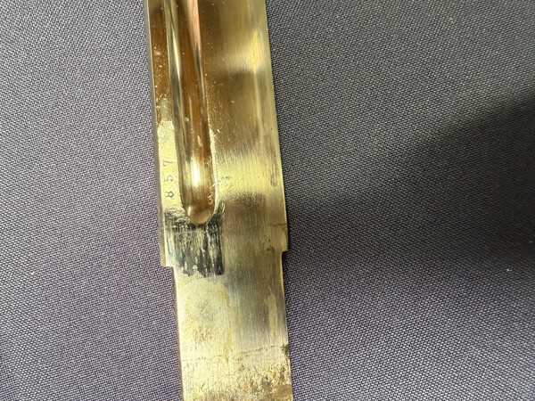

Conway S Posted September 7, 2023 Report Share Posted September 7, 2023 Found this late Suya example with serial 155,437. It has a brass tsuba instead of iron. As you can see from the pictures the Suya and Tokyo First Arsenal stamps on the fuchi are very faint. It does give me some pause because the seller is also selling two other fake NCO swords at the moment... If it is fake they picked a good serial number to use. Interested to hear others' thoughts. Thanks. Conway Quote Link to comment Share on other sites More sharing options...
Conway S Posted September 7, 2023 Report Share Posted September 7, 2023 Quote Link to comment Share on other sites More sharing options...
Bruce Pennington Posted September 7, 2023 Report Share Posted September 7, 2023 Have to call on @Shamsy for this one! The whole thing looks too crude to be something made by Suya Shoten. They are known for higher quality stuff than this. I also don't like the Tokyo star. Never seen one like that. Quote Link to comment Share on other sites More sharing options...
John C Posted September 7, 2023 Report Share Posted September 7, 2023 Conway: Just my two cents... the tsuba and tsuka look legit to me (note the even pattern of "same'" and the detail on the menuki). Also, the style of numbering (font) looks correct. But Bruce is correct that it all seems a bit "weak" for that shop. John C. Quote Link to comment Share on other sites More sharing options...
