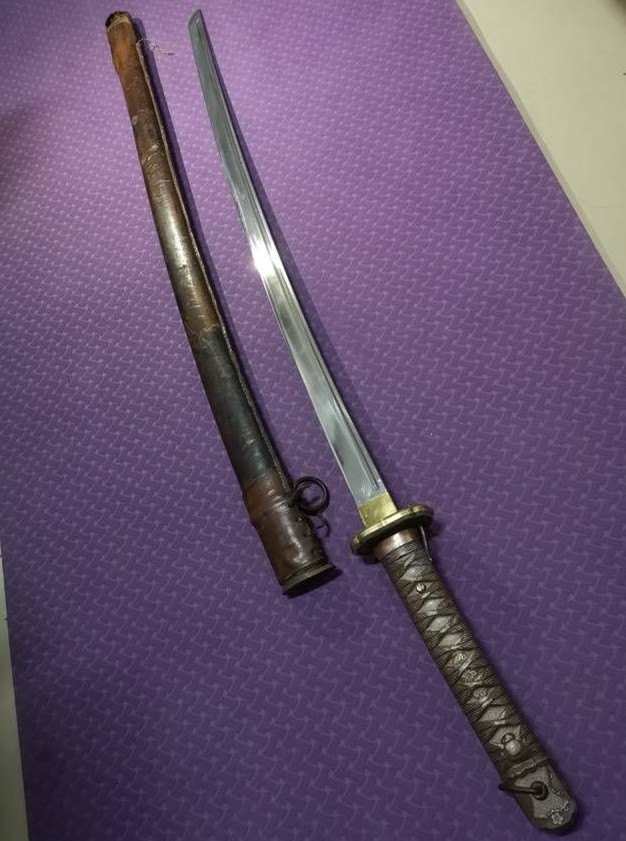

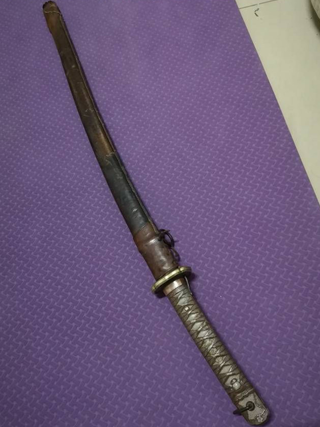

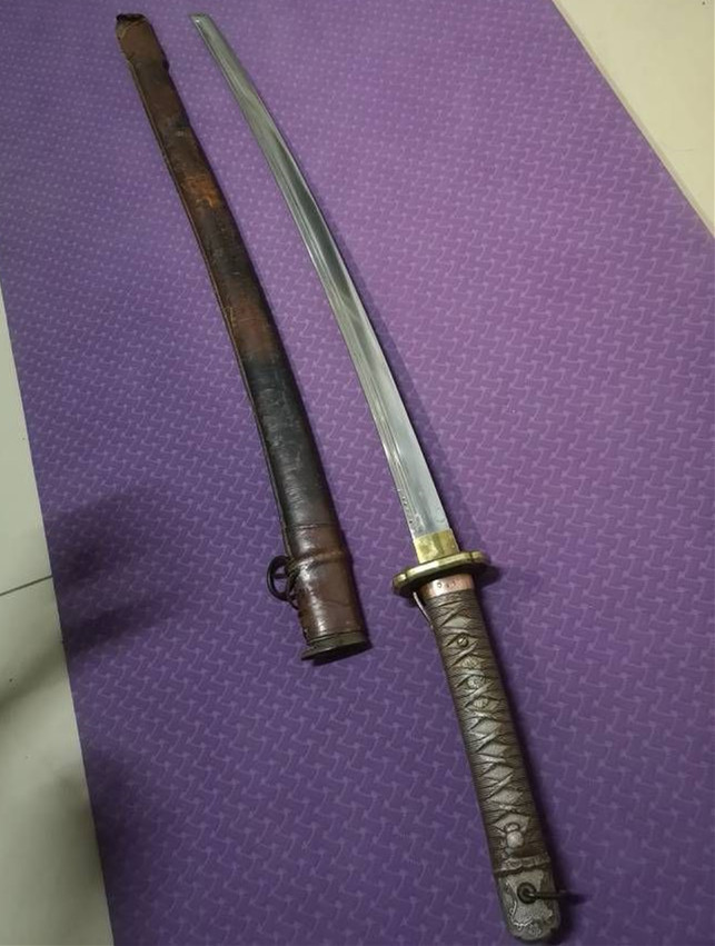

IJASWORDS Posted September 17, 2019 Report Share Posted September 17, 2019 An original leather covered NCO. 4 Quote Link to comment Share on other sites More sharing options...
BANGBANGSAN Posted September 17, 2019 Report Share Posted September 17, 2019 This leather cover looks original with the sword. 3 Quote Link to comment Share on other sites More sharing options...

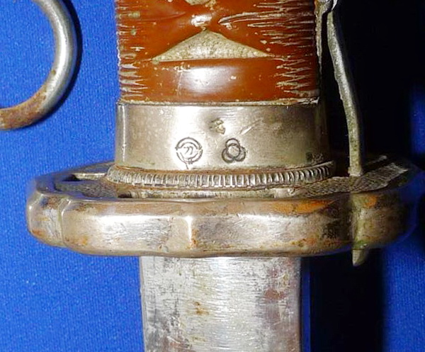

Bruce Pennington Posted September 19, 2019 Report Share Posted September 19, 2019 So, we still have 2 mystery stamps on 95s, and one of them could have been the Minuzo stamp: Quote Link to comment Share on other sites More sharing options...
BANGBANGSAN Posted September 19, 2019 Report Share Posted September 19, 2019 神户-Kobe,think about the 神户牛肉 Kobe Beef. Quote Link to comment Share on other sites More sharing options...
BANGBANGSAN Posted September 19, 2019 Report Share Posted September 19, 2019 So, we still have 2 mystery stamps on 95s, and one of them could have been the Minuzo stamp: 20180529_114427.png20180603_215249.jpg The first mark is 水- Water-Mizu Quote Link to comment Share on other sites More sharing options...
BANGBANGSAN Posted September 19, 2019 Report Share Posted September 19, 2019 An Australian collector from Victoria told me that Type 95 fuchi came in either brass, iron, or copper plated alloy. Can anyone identify what material this fuchi is made of? It is coming from a 神戸商店 made Type 95, serial number 68452東. Sorry about the maker's name, the translation is currently unknown as it is a last name that has like five pronuncitions! http://www.warrelics.eu/forum/Japanese-militaria/Japanese-nco-sword-verification-676512/ Thomas This fuchi looks like copper plated alloy to me. Quote Link to comment Share on other sites More sharing options...
Bruce Pennington Posted September 19, 2019 Report Share Posted September 19, 2019 The first mark is 水- Water-Mizu Is that what the kanji means? That has a very suspicious resemblance to “Misuno”!!! Maybe we just figured out which stamp came from the Misuno company! Thanks Trystan! Quote Link to comment Share on other sites More sharing options...

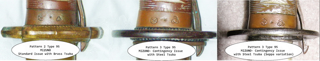

Kiipu Posted September 19, 2019 Author Report Share Posted September 19, 2019 (edited) I think I found the Mizuno company logo and inspection stamp but still have no serial number. Does anyone know the complete name for this company? http://www.militaria.co.za/nmb/topic/5999-arsenal-stamps/page-11?do=findComment&comment=219263 Mizuno stopped Type 95 production in 1942 because of some quality control issues. http://www.warrelics.eu/forum/f216/short-development-history-type-95-gunto-676112-post1753234/#post1753234 Here are the characters for Mizuno as they appear in wartime documents. Mizuno is a Japanese surname with only one pronunciation according to Japanese Names by P. G. O'Neill. 水野 Edited September 19, 2019 by Kiipu Quote Link to comment Share on other sites More sharing options...
Kiipu Posted September 19, 2019 Author Report Share Posted September 19, 2019 The first mark is 水- Water-Mizu I agree as does Komiya san over at http://www.warrelics.eu/forum/f216/short-development-history-type-95-gunto-676112-post1753234/#post1753234! You will see a supplier called Mizuno , who is not included in Stu W's thread. They only produced for a few months in 1942 before getting sacked. They had a logo consisting of the character 水 in a hexagon. Quote Link to comment Share on other sites More sharing options...
Kiipu Posted September 19, 2019 Author Report Share Posted September 19, 2019 After re-reading all this, I can see I've misunderstood. We are not talking about the "Ichi" stamp, you (Thomas) simply introduced a new topic about the manufacturer named "合名会社神戸商店". To me, they are one and the same. The K was dropped and replaced by 一. Just like Seki which went from the 岐 logo to the 刀 logo. Serial Numbers in Sequential Order 38027東 K within a cherry blossom. 38254東 K within a cherry blossom. 39023東 K within a cherry blossom. 68452東 一 within a cherry blossom. 68765東 一 within a cherry blossom. 68920東 一 within a cherry blossom. 2 Quote Link to comment Share on other sites More sharing options...
BANGBANGSAN Posted September 19, 2019 Report Share Posted September 19, 2019 Yes,水 means water,and pronunciation is Mizu. Is that what the kanji means? That has a very suspicious resemblance to “Misuno”!!! Maybe we just figured out which stamp came from the Misuno company! Thanks Trystan! Quote Link to comment Share on other sites More sharing options...

Stegel Posted September 20, 2019 Report Share Posted September 20, 2019 Mizuno produced only the Aluminium Handled Type 95 with the Top Locking mechanism, but in both the Standard issue and contingency issues. 2 Quote Link to comment Share on other sites More sharing options...
Stegel Posted September 20, 2019 Report Share Posted September 20, 2019 Serial Numbers in Sequential Order 38027東 K within a cherry blossom. 38254東 K within a cherry blossom. 39023東 K within a cherry blossom. 68452東 一 within a cherry blossom. 68765東 一 within a cherry blossom. 68920東 一 within a cherry blossom. Some additions here... The "一 within a cherry blossom" also appears in the 47k-49k range for both Std issue (Brass Tsuba) and Contingency issue (Steel Tsuba) 2 Quote Link to comment Share on other sites More sharing options...

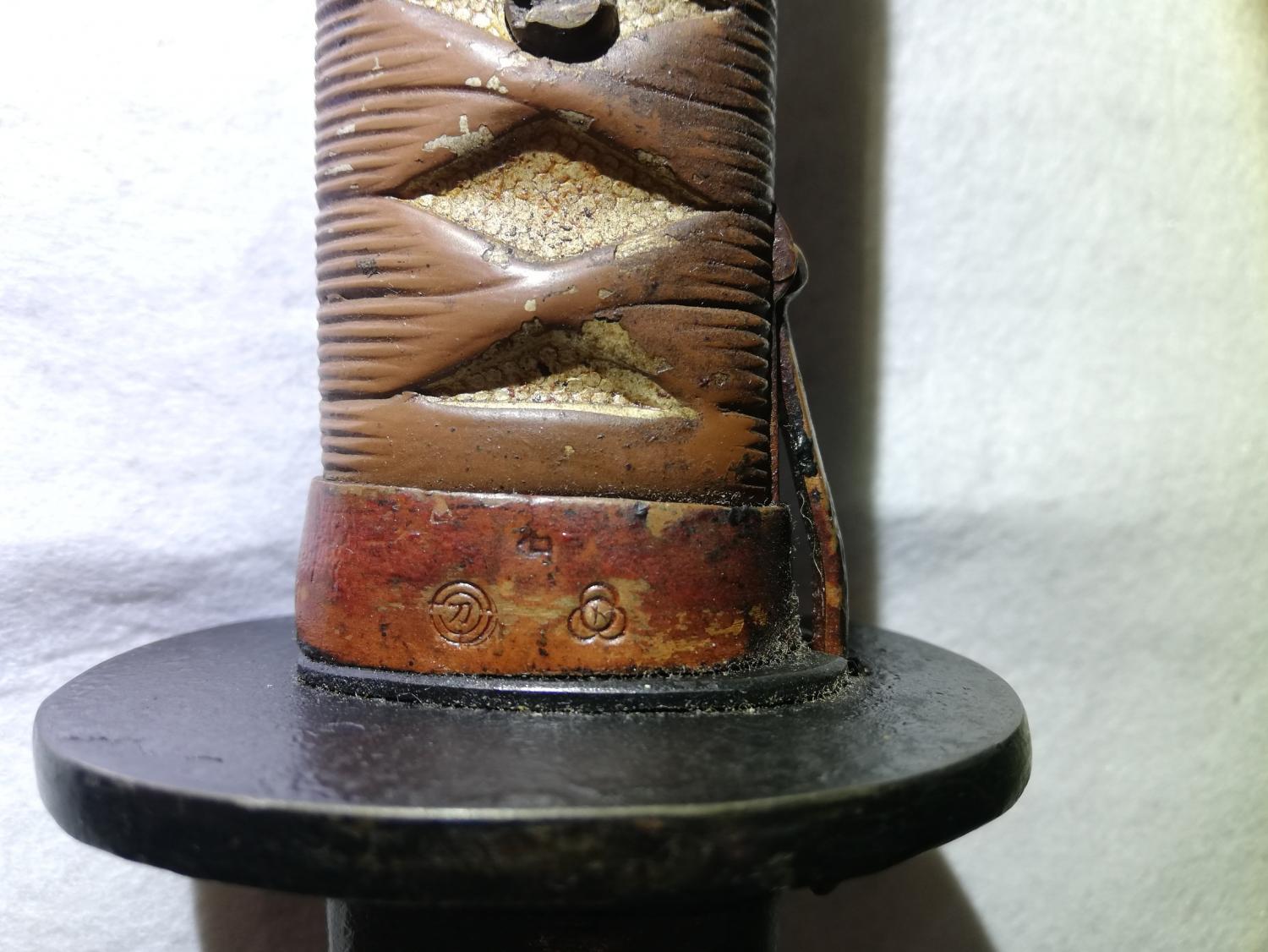

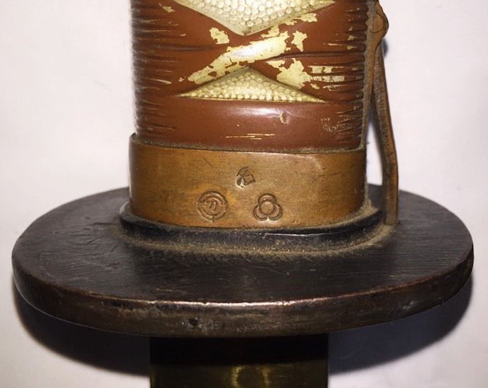

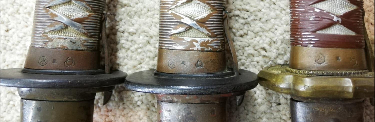

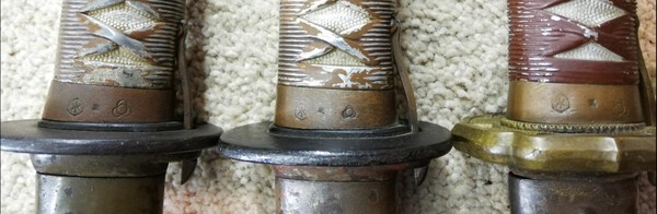

Shamsy Posted September 20, 2019 Report Share Posted September 20, 2019 Well since the Mizuno is finally out of the bag (I note that Nick actually mentioned them several times over the last few years but no one seemed to notice), here are three more. 2 Quote Link to comment Share on other sites More sharing options...

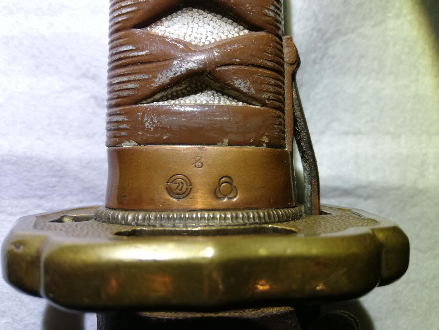

Bruce Pennington Posted September 20, 2019 Report Share Posted September 20, 2019 Ernie & Steve, Thanks for verifying all this! Ah, the round Seki! I had forgotten about that one! I've seen partials on fuchi, but never a good, complete one. If one of you guys have a good example, I'll add it to the Stamps Document. There are examples of it on the foil Seki acceptance stickers on saya, but I don't have a good one on fuchi. Ok, so there's now 2 guys I trust who are saying the evolution from "K" to "一" (Kobe Shoten) has merit. Well, I'm going to move the Ichi stamp out of "Unknowns" then, and put it down as a "Possibly later Kobe". Quote Link to comment Share on other sites More sharing options...
BANGBANGSAN Posted September 20, 2019 Report Share Posted September 20, 2019 Thomas,thanks for the info.So Both 岐(Gifu)&刀(To/Knife)are ues by 関市(Seki)Factory。 Quote Link to comment Share on other sites More sharing options...
Kiipu Posted September 20, 2019 Author Report Share Posted September 20, 2019 (edited) Thomas, thanks for the info. So Both 岐 (Gifu) & 刀 (To/Knife) are ues by 関市 (Seki) Factory。 More than likely the same place, but different names and logos. 岐 = Seki Hamono 関刃物 Highest observed serial number is 名78789. 刀 = Seki Tōken KK 関刀剣株式會社 Lowest observed serial number is 名82009. I have one other serial number in-between but it has an iron fuchi and you know the drill with them. Here is the blade serial though 名81642. And thank you for all your input. Edited September 21, 2019 by Thomas 1 Quote Link to comment Share on other sites More sharing options...
Stegel Posted September 21, 2019 Report Share Posted September 21, 2019 Ah, the round Seki! I had forgotten about that one! I've seen partials on fuchi, but never a good, complete one. If one of you guys have a good example, I'll add it to the Stamps Document. There are examples of it on the foil Seki acceptance stickers on saya, but I don't have a good one on fuchi. Hey Bruce, here's some to pick from Quote Link to comment Share on other sites More sharing options...
Bruce Pennington Posted September 21, 2019 Report Share Posted September 21, 2019 Perfect Ernie, thanks!!! Added to the Stamps Doc. Quote Link to comment Share on other sites More sharing options...
Shamsy Posted September 21, 2019 Report Share Posted September 21, 2019 I forgot to offer these this morning, Bruce. I have examples of Seki stamps on other models with iron tsuba, but they're fairly incomplete or covered by paint,. Still happy to get some pics of your interested, but these are clear enough for demonstration. 1 Quote Link to comment Share on other sites More sharing options...
