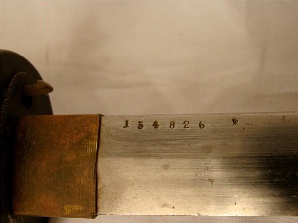

BANGBANGSAN Posted September 12, 2019 Report Share Posted September 12, 2019 Suya Type 95, serial 154826 東 no blade fuller 1 Quote Link to comment Share on other sites More sharing options...

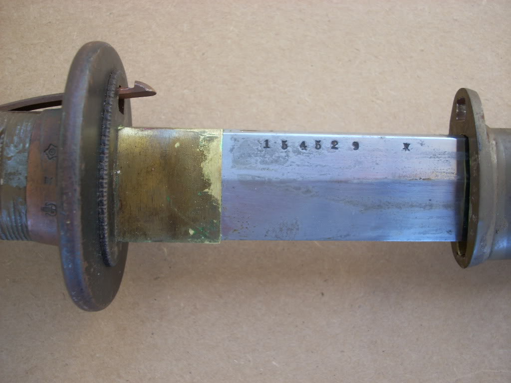

BANGBANGSAN Posted September 12, 2019 Report Share Posted September 12, 2019 Suya Type 95, serial 154529 東 no blade fuller 3 Quote Link to comment Share on other sites More sharing options...

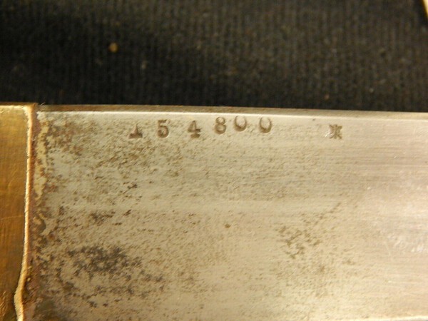

BANGBANGSAN Posted September 12, 2019 Report Share Posted September 12, 2019 Suya Type 95, serial 154800 東 no blade fuller 2 Quote Link to comment Share on other sites More sharing options...

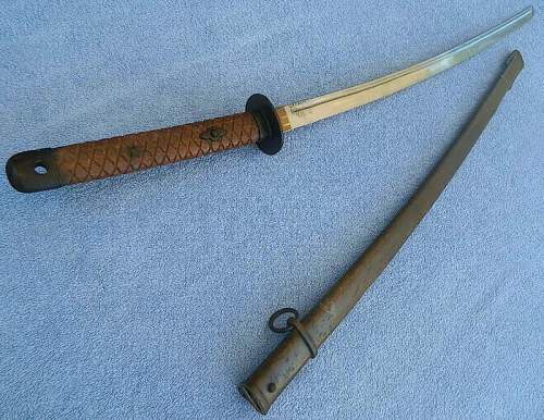

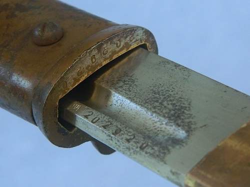

BANGBANGSAN Posted September 12, 2019 Report Share Posted September 12, 2019 Nagoya wood handle Type 95 serial 201920 関 ,with blade fuller 3 Quote Link to comment Share on other sites More sharing options...
BANGBANGSAN Posted September 12, 2019 Report Share Posted September 12, 2019 Nagoya wood handle Type 95 serial 201750 関 ,with blade fuller. 2 Quote Link to comment Share on other sites More sharing options...

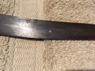

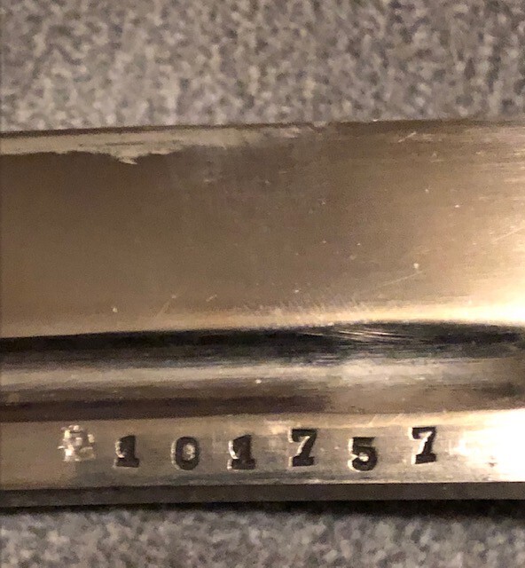

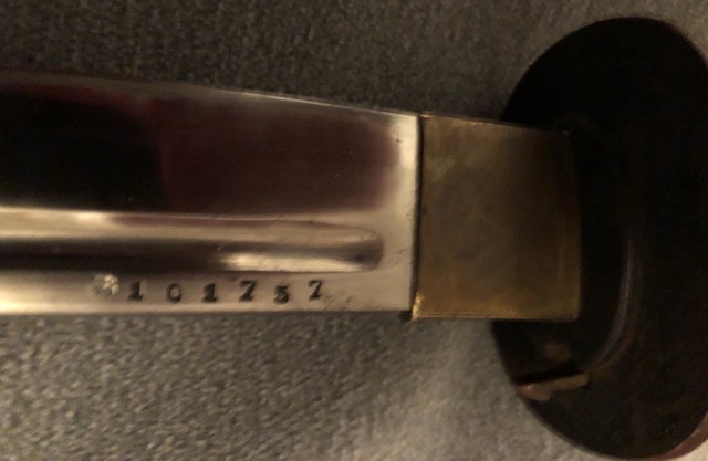

IJASWORDS Posted September 13, 2019 Report Share Posted September 13, 2019 Does this add to the conversation ? Number 161752. 2 Quote Link to comment Share on other sites More sharing options...

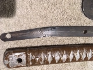

Bruce Pennington Posted September 13, 2019 Report Share Posted September 13, 2019 My only odd-ball 95 is a Nagoya side-latch with a crooked nakago. I'm not sure if it was damaged and repaired or if it was just really poorly made. In my opinion, the Nagoya arsenal had a looser quality standard than the Tokyo arsenal. It's also has the odd multi-green paint on the saya that we've tentatively determined to be period paint, not post-war. 3 Quote Link to comment Share on other sites More sharing options...

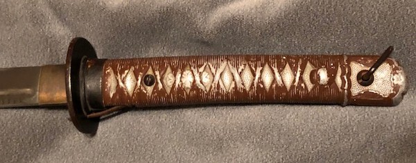

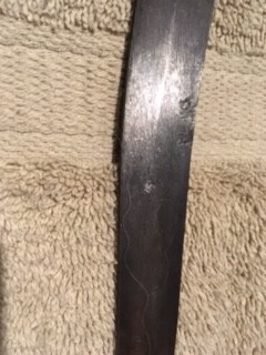

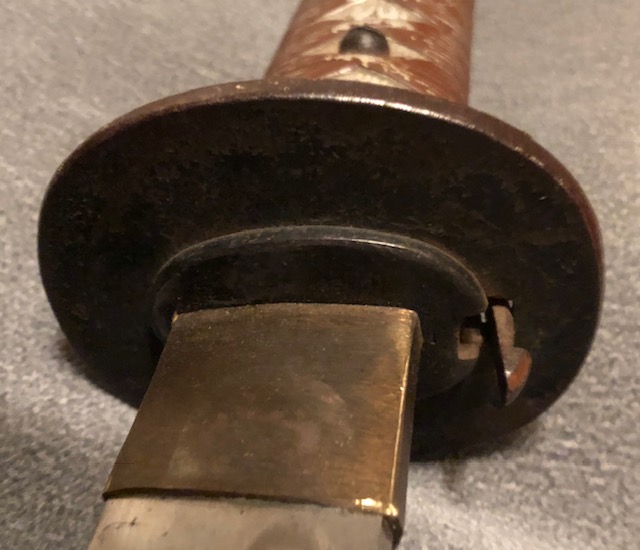

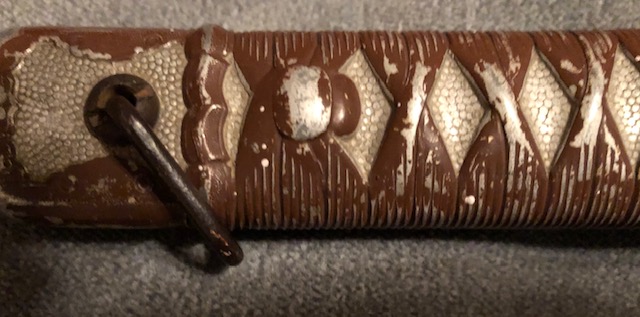

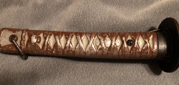

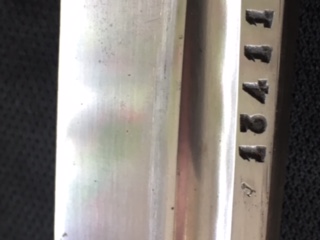

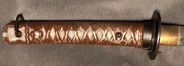

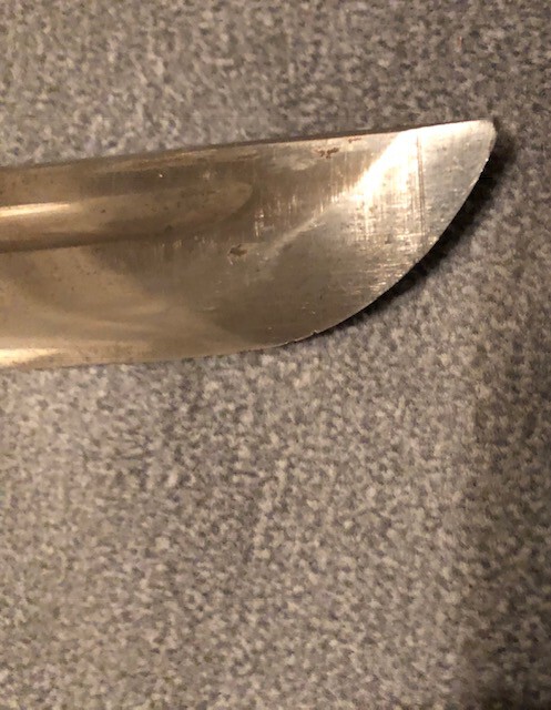

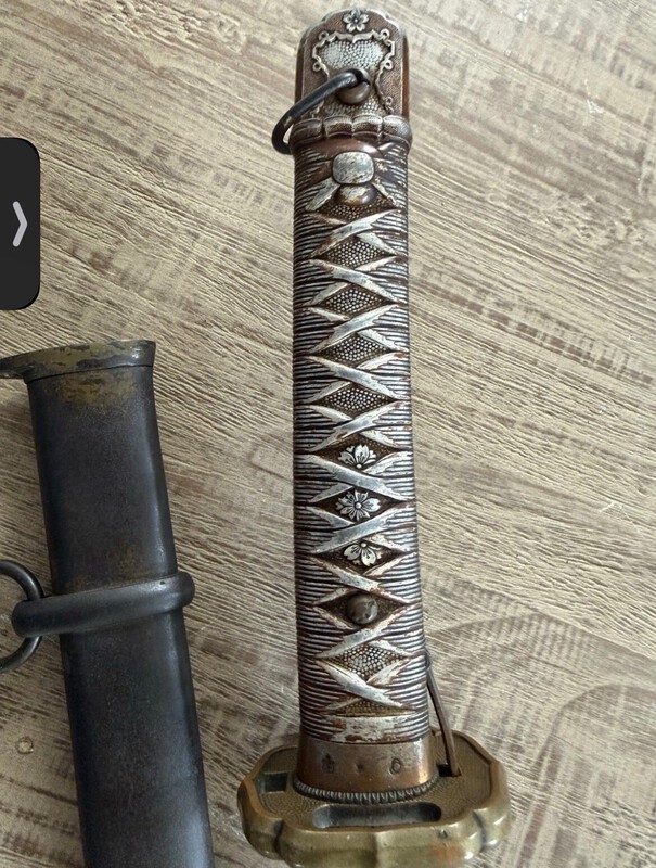

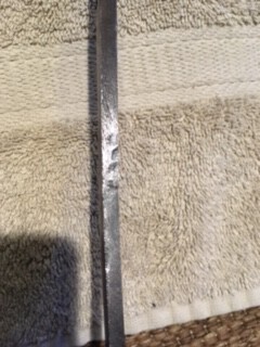

Yoshimichi Posted September 17, 2019 Report Share Posted September 17, 2019 Dear NMB members: I just picked this sword up at a local gun show about three weeks ago. I cannot make out the arsenal or inspection stamp next to the serial number. Any thoughts? Is the serial number incorrectly stamped upside down? Is the iron fuchi common on this sword? Any input is appreciated. It came with what looks like an English or U.S. cavalry saber scabbard. Regards, Bill E. Sheehan (Yoshimichi) 2 Quote Link to comment Share on other sites More sharing options...
Kiipu Posted September 17, 2019 Author Report Share Posted September 17, 2019 Looks like a deeply struck Na inspection mark. Carefully look at the fuchi and see if you can see any arsenal or company logos. Don't fret as it looks like yours is iron and it can be hit or miss in that case. 名 = na Quote Link to comment Share on other sites More sharing options...
Shamsy Posted September 17, 2019 Report Share Posted September 17, 2019 It's a nagoya inspection stamp, Bill. The serial numbers are fine. They can be either orientation, depending on the arsenal that made the blade. The saya is from another sword as you guessed. Not got the right suspension rings. Quote Link to comment Share on other sites More sharing options...

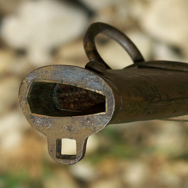

PNSSHOGUN Posted September 17, 2019 Report Share Posted September 17, 2019 There was an example of a rarely seen leather saya cover with second hanger in one of the F&G books but this looks different, the example has the second hanger as an integral part of the leather cover. Quote Link to comment Share on other sites More sharing options...
