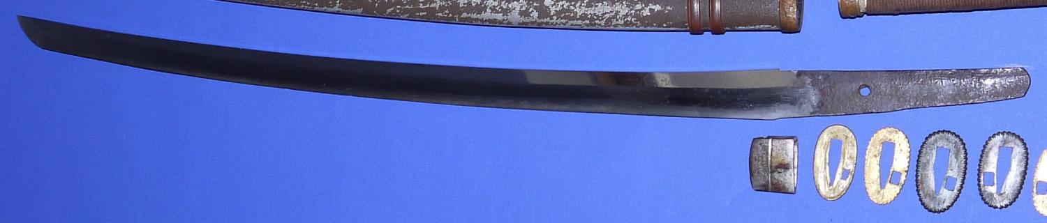

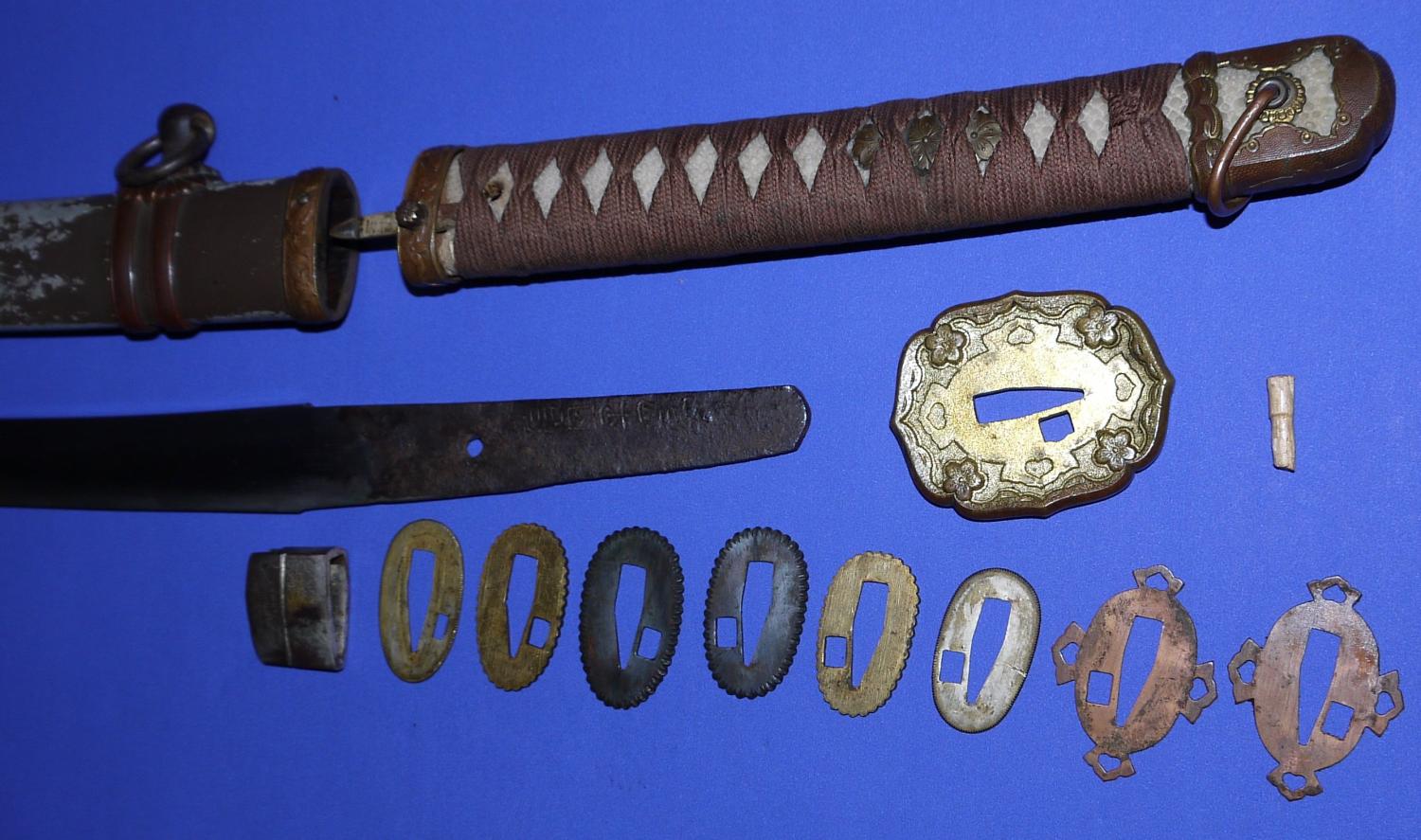

Hello all
I generally get by deciphering mei these days, but this one has really got me.
Also, unsure if I should have split this into two posts, but the blade has some very strange inserts.
So it comes from a shin gunto with very high quality furniture (e.g. the seppa seem to have been made especially).

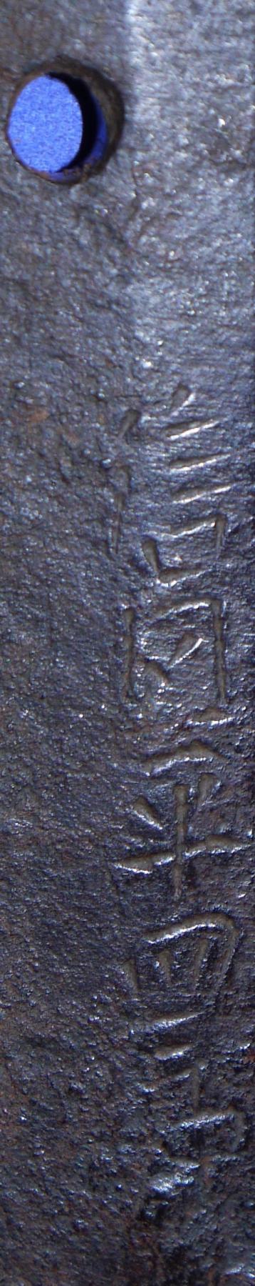

The last character is corroded away; I can not take a better photo.
My best guess is Hiko Shi (no) kami Kane (last character)
But the first character looks more like the first character used for province Shinano, but the second character seems to rule that out.

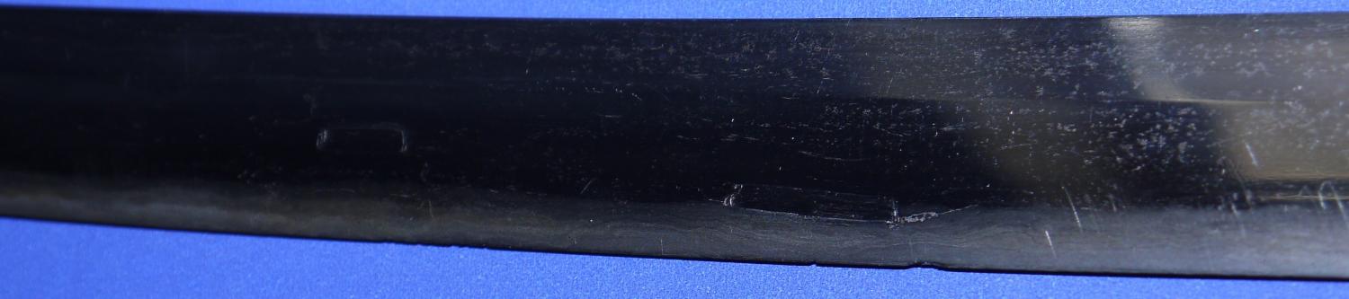

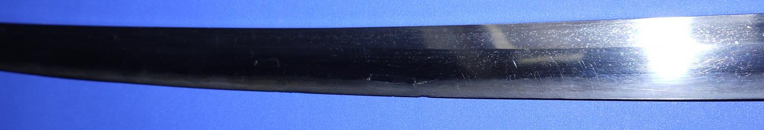

OK, now the blade inserts.
These are clearly light weight? metal inserts which were then covered over by steel proper.
One has fully exposed (it looks like plastic but that is the light, it is a metal), and there are a couple of outlines of two smaller ones that are "coming out" (the thin steel covering is yielding).
I can not believe these were done more recently, why, how?
The blade itself appears to be very high quality.
Please, on both counts, can someone put me out of my torment?

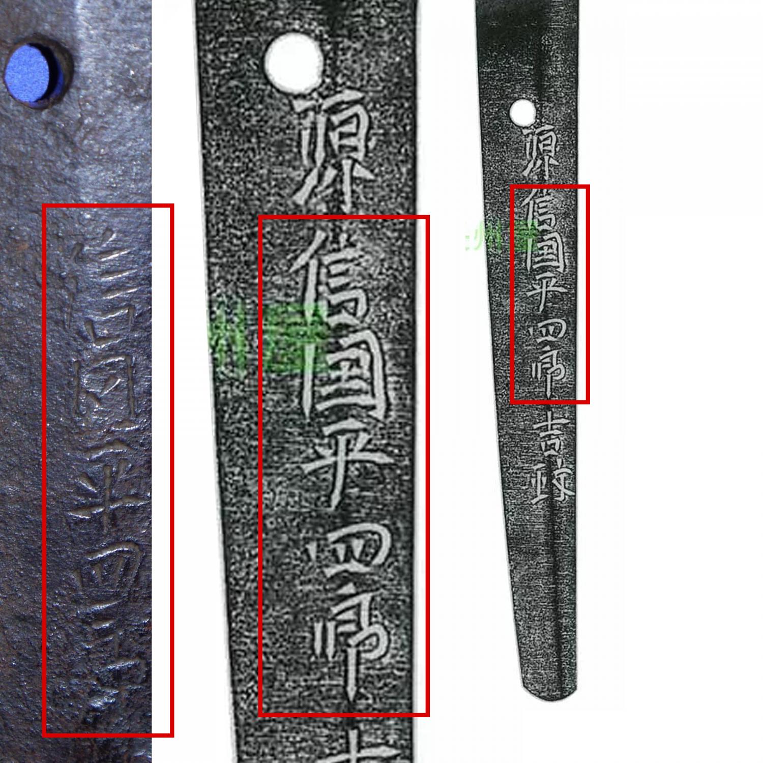

I am seeing 信_平四_. The only combination which would seem to match is 信國平四郎 (Nobukuni Heishiro) but that does not seem right for your mei.
Thanks Ray. It seems a very minimalist signature. I think you are bang on with Nobukuni, thank you. But I do not see Hei, I see Kane, maybe Kanemori? Kanekuni?
Please see attached for an example of 信國平四郎 (from a larger mei for Nobukuni Yoshimasa). That appears fairly certain to be what the mei is trying to read.
https://www.choshuya.co.jp/senrigan-1/%E5%88%80%E3%80%80%E9%8A%98%E3%80%80%E6%BA%90%E4%BF%A1%E5%9B%BD%E5%B9%B3%E5%9B%9B%E9%83%8E%E5%90%89%E6%94%BF

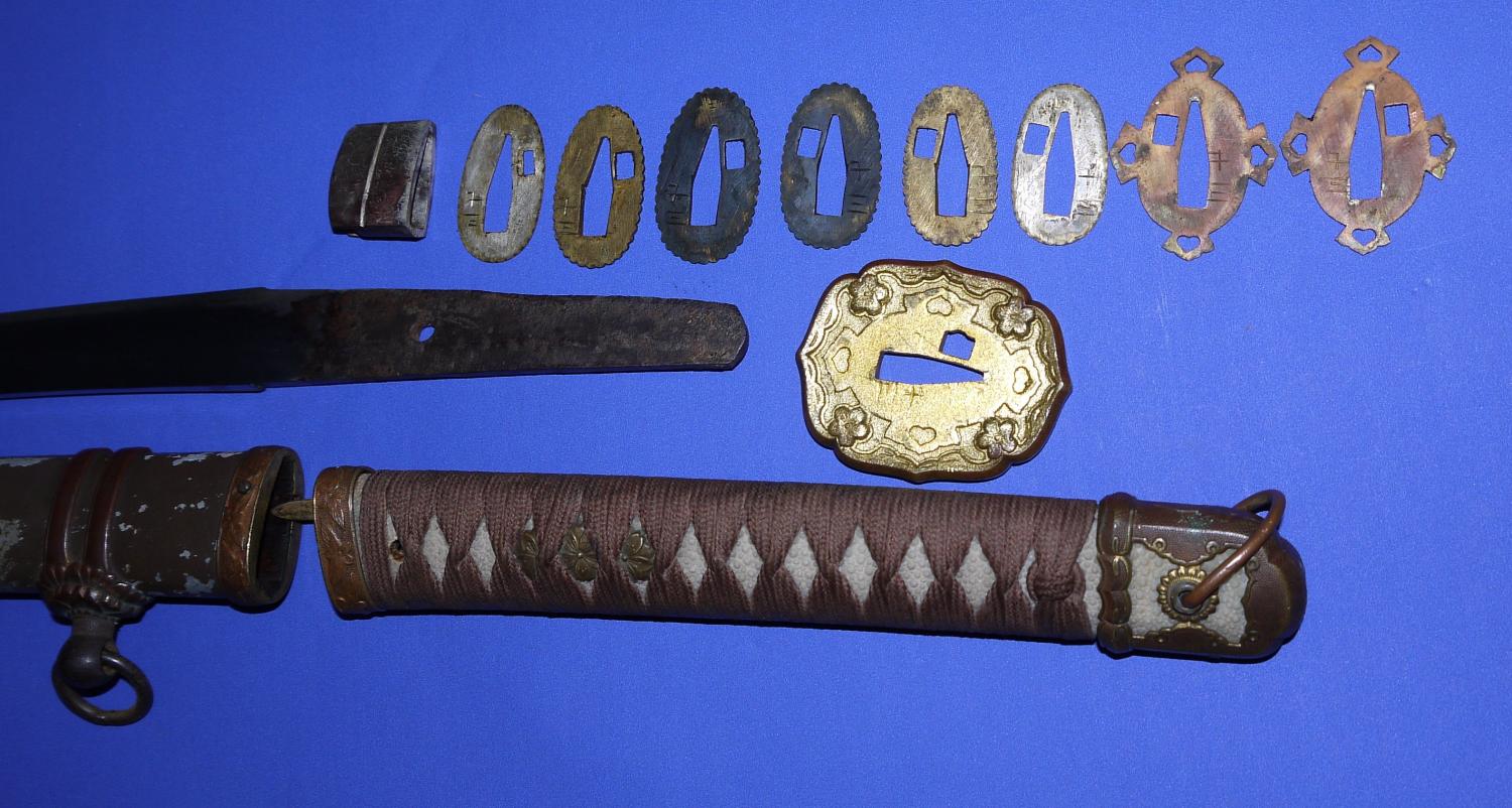

Thanks for taking the time out. I know the blade is pretty much worthless from a nihonto point of view, but I am into military swords, as my French Napoleonic Cuirassier image shows. I find it interesting identifying the smith as much as the thought process / reasoning by the Japanese officer (I presume it was him who did it) to "repair" the blade (basically make it fit for a fight and with his ancestors honour).
I bought it auction knowing about the odd inserts and it fascinated me. The trouble someone went to. I thought they might be to balance the sword.
So, I have these if they help.
