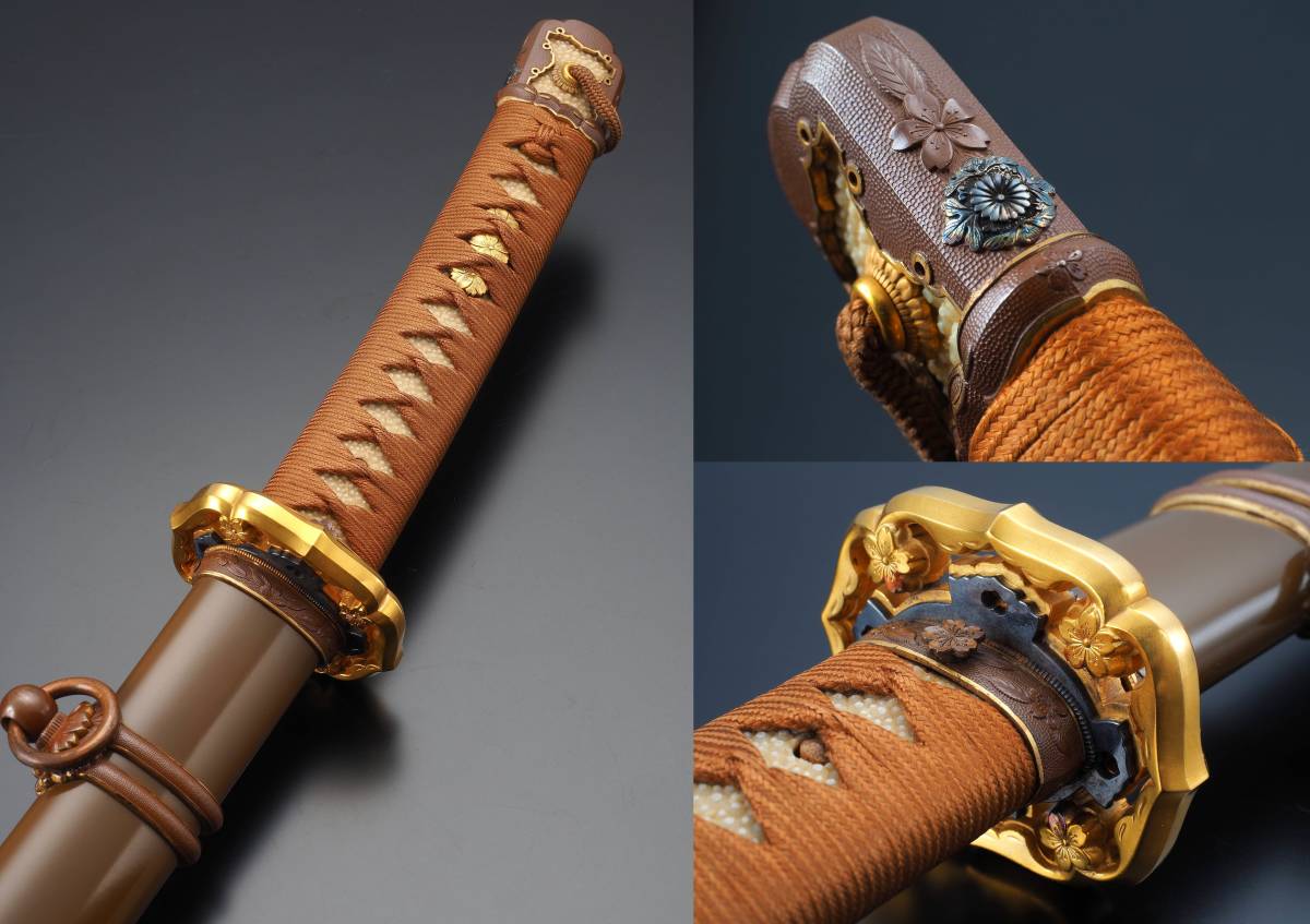

Does the sword look like this one? This is purported to be Prince Takada's sword (Bizen Sukesada) retrofitted to guntō mounts.

My heart skipped a beat over the first photo. That profile is very similar; but this is a Kanezane, not a Sukesada. Sure wish it were!
