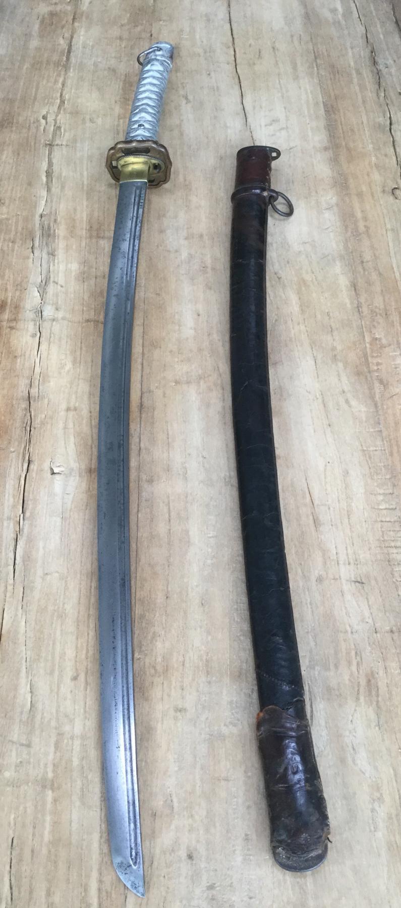

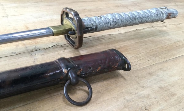

I’m already the proud owner of some type 98 shin gunto’s and a couple of kai gunto’s, but never had an NCO sword. So this week I got a nice opportunity to get a rather interesting NCO sword. It’s an alluminium handle Nagoya sword with a leather covered saya ( in rather good condition). Next to this unusual feature, it also came with a war trophy certificate for a British officer and an old picture of the officer ( as I was told).

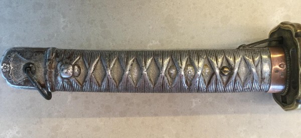

Upon taking a closer look at the tsuka, I have a strong suspission that it has been painted over with a silver colored paint. It looks like it since it seems to cover the initial brown paint and also the thickness of the paint has blurred or covered the smaller details.
Basically, my question is if anyone can confirm that it has been re-painted, and more importantly if it should or can be removed without damaging the original paint.
I would like to restore it if possible, but am terrified to damage it permanently.
If anyone has any experience with this. Thanks a lot for your help in this.
Yes, it has been repainted (look at the sarute and at the stamps on fuchi). As you noticed, under the silver paint there are traces of the original brown coating, but how much of it is still there is a bet. I would try petrol or acetone in a hidden, small spot just to see if it is an easily removable paint. To me, it seems that is has been already partially cleaned (look at the fuchi again).

So, i started gently with q tips and nail polish remover (thanks to my wife) and it comes of with a bit of rubbing.
I started on the menuki and the details start popping again. It will be hard to go into the deeper parts of the design but a toothpick might help?
I guess I have a little project on my hands for the coming month.
Just to illustrate a pic of the menuki on one side and on the other where i did the test.

Ok, so after a lot of rubbing, i got one side finished and I’m feeling rather happy.
Not sure if it’s the result or the fact that i’ve been sniffing nail polish remover all day... man, that stuff gets in your nose.
So here it is; before and after.
Let me know what you think.
