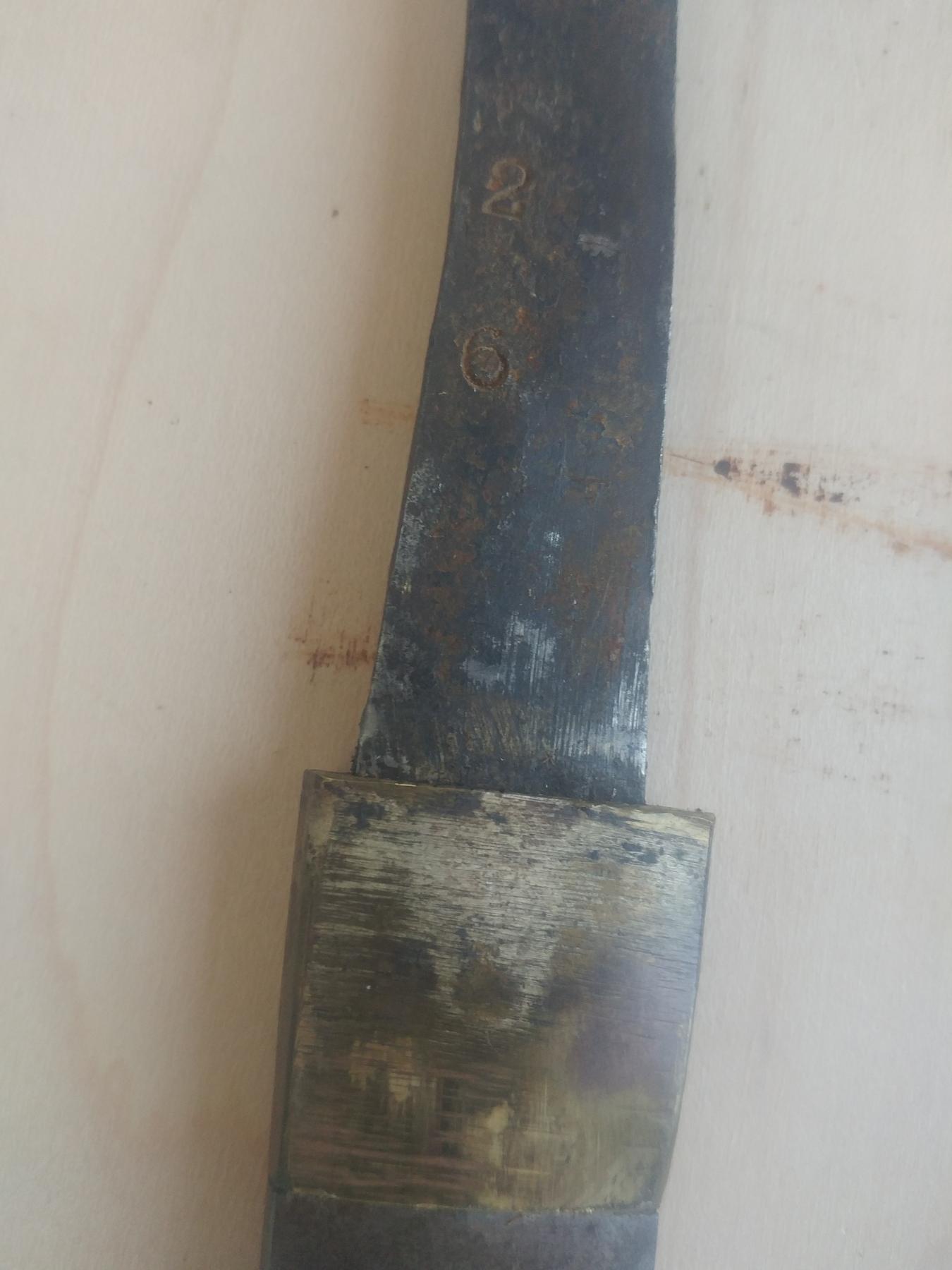

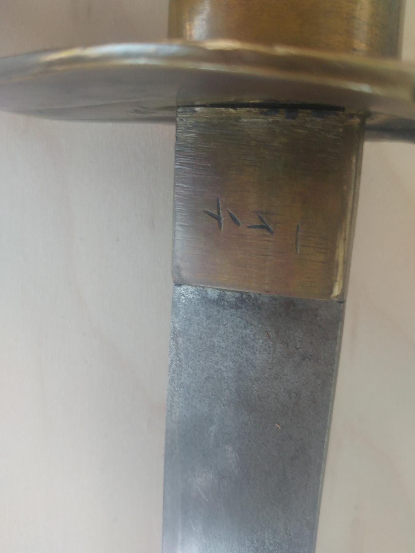

Help needed identifying a kyu gunto sword. It belongs to a friend who's had it many years. I've looked at hundreds of kyu gunto sword pictures and have not seen one that matches. It appears that the tsuka was wrapped with samegawa. I hope the pictures I'm posting can shed some light. Thanks.

If you click on one picture, it will go to gallery form, in which the pictures are greatly magnified, and you can scroll around to see every portion of the picture. If you look at the magnified images, you'll see they were taken a from a certain perspective for a reason; there's a number 26 stamped in the underside of the tsuba/hand protector, and on the nakago. Also, there are figures/writing stamped on the habaki. Yes, some of the pictures are not the best, but that being said, thanks for your input and I hope that others that read this will be able to view the pictures in the way it was intended, helping to create a more definitive response.

Thanks for the info Bruce. The blade retaining nut on the end of the handle is flower shaped, like the one on the handle on the left side picture, but the handle matches the one on the right side picture. Any significance to the number 26, stamped on both the nakago and handle, or the writing on the habaki? Since I don't have Dawson's book, what era would this sword be? Is it considered kyu gunto?

 My friend who owns the swords, lives far from me, still has a landline phone, does not have a cell phone OR computer. Truly OLD school! So for now the best I could do was call and ask him to check on the end cap. It is indeed a five petal design flower. Next time I'm in his area, I'll stop by and take a picture. By the way, anything on the #26 stamped or the writing on the nakago??

Sorry, I meant to answer your question about the "26" - on shingunto, the numbers are to keep fitted parts together as the blade goes through polish and re-assembly. I can only surmise that the numbers on kyugunto were used for the same purpose. I've never read, nor heard, a knowledgable discussion on that issue. They have no other meaning that I'm aware of.
