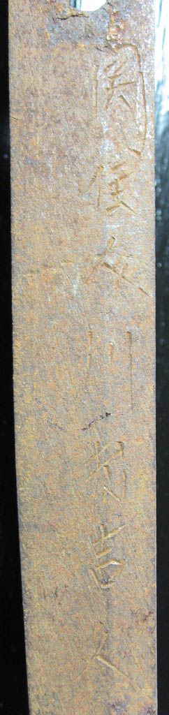

I've got the beginnings of it, but someone will fill the rest in shortly, I should imagine.
What I can see is Seki-Ju, Nani(?)kawa Mura, Yoshihisa
I.E. a smith called Yoshihisa who lived/worked in Seki. Can't read the name of the local village, though.
PS Oops, Rich got there first! (So did Stephen...)

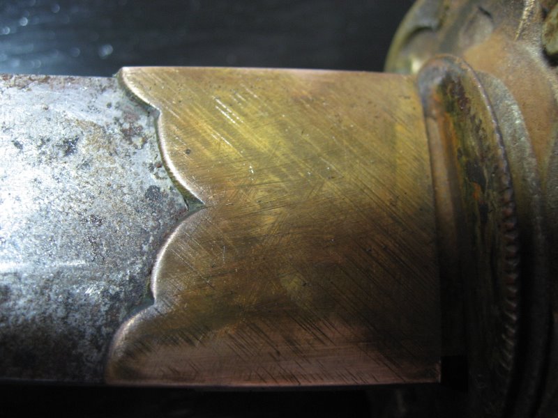

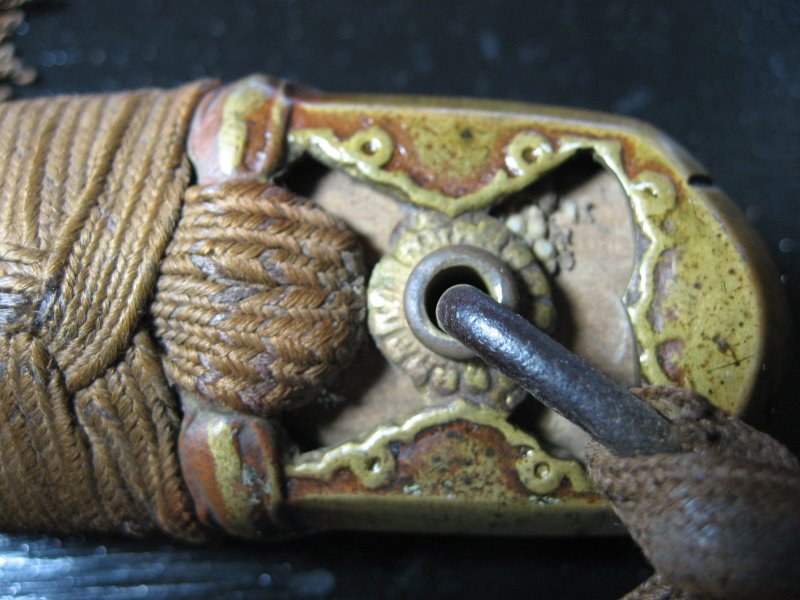

Rob,
No, that is a painted military marking, found on many WW2 swords and of no real significance. An arsenal stamp will be small and stamped above the signature near the top. Not always there either.
There is no set pattern for WW2 furniture. Can have a lock or not, variations in tsuba and all the other parts. Lots of different variations, but still standard WW2 Shin-Gunto.
I expect your will be more mass produced and oil quenched.
