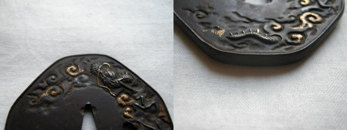

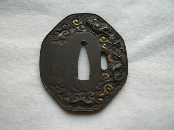

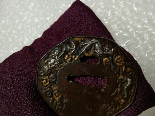

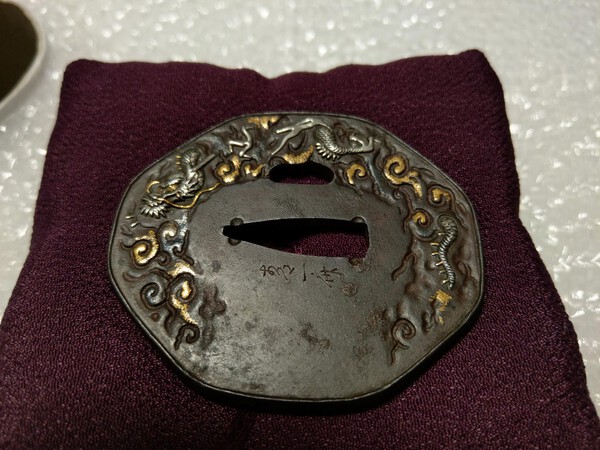

Hello,

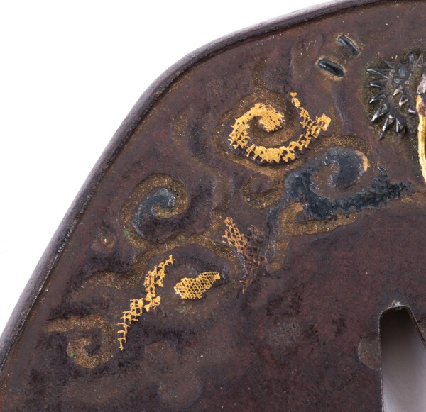

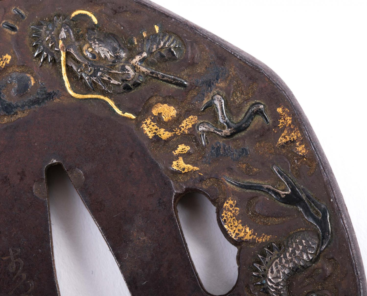

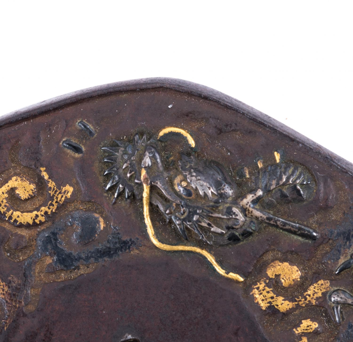

I just bought this tsuba. As you can see It is damaged and I wanted to do some work on it (not me personally but a specialist). I would like It to look as similar to the original look as possible. That is why I am looking for similar tsuba for reference. Thanks to the forum I already now the name of the maker: Haruichi-sai or Harukazu-sai. However I can't find this maker in Haynes or the internet!. So if you could help me find his work or examples of similar tsuba it would be great.
I would like to start with color of the dragon. It is made of silver and I don't know If It should be "silver" or should I use patina to make it dark/black.
I also wonder about an original color of iron.
Thank you in advance for all comments.
Best Regards,
Krystian
Hi Krystian,
Henry is right in his reccomendation of Ford Hallam, this aesthetic is definitely one he is extremely well schooled in, he will know exactly how it should look.  As I don't have access to all my reference material, I can't say if he is a direct associate of the school, if not he was heavily influenced by it.  Your photos are not good enough to see the details of the nunome work, but many direct members of the school laid it down using  a 'Y' shaped punch, if you can see this detail It could provide confirmation.  It's a very nice piece in good condition, excepting some rust and a bit of unfortunate vandalism.
-S-
Krystian,
If your planning on having someone work on this...DON'T clean anything!   Much better pics, thanks.   Its a promising looking piece, a couple of questions, is the rim part of the piece, or is it an applied fukurin?  Also, could you please give us the dimensions?
-S-
The dragon does look to be in silver, but blackened silver finishes, which are produced by using sulphur, were evidently not an aspect of metal finishing used in the past.
And as Steven suggested, don't do any cleaning if you intend to have a professional deal with it because a microscopic examination before intervening allows for a more detailed and subtle understanding of the piece and what it might have been intended to look like. DIY cleaning tends to destroy a wealth of valuable evidence.

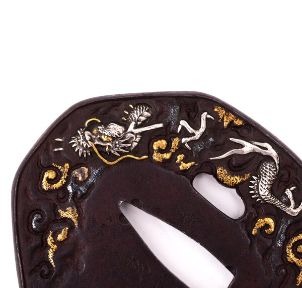

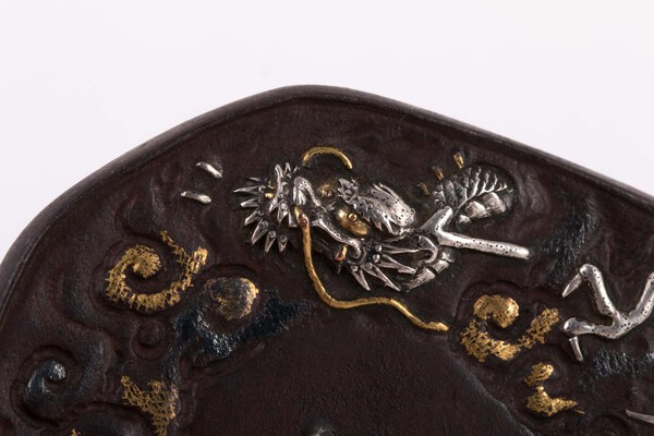

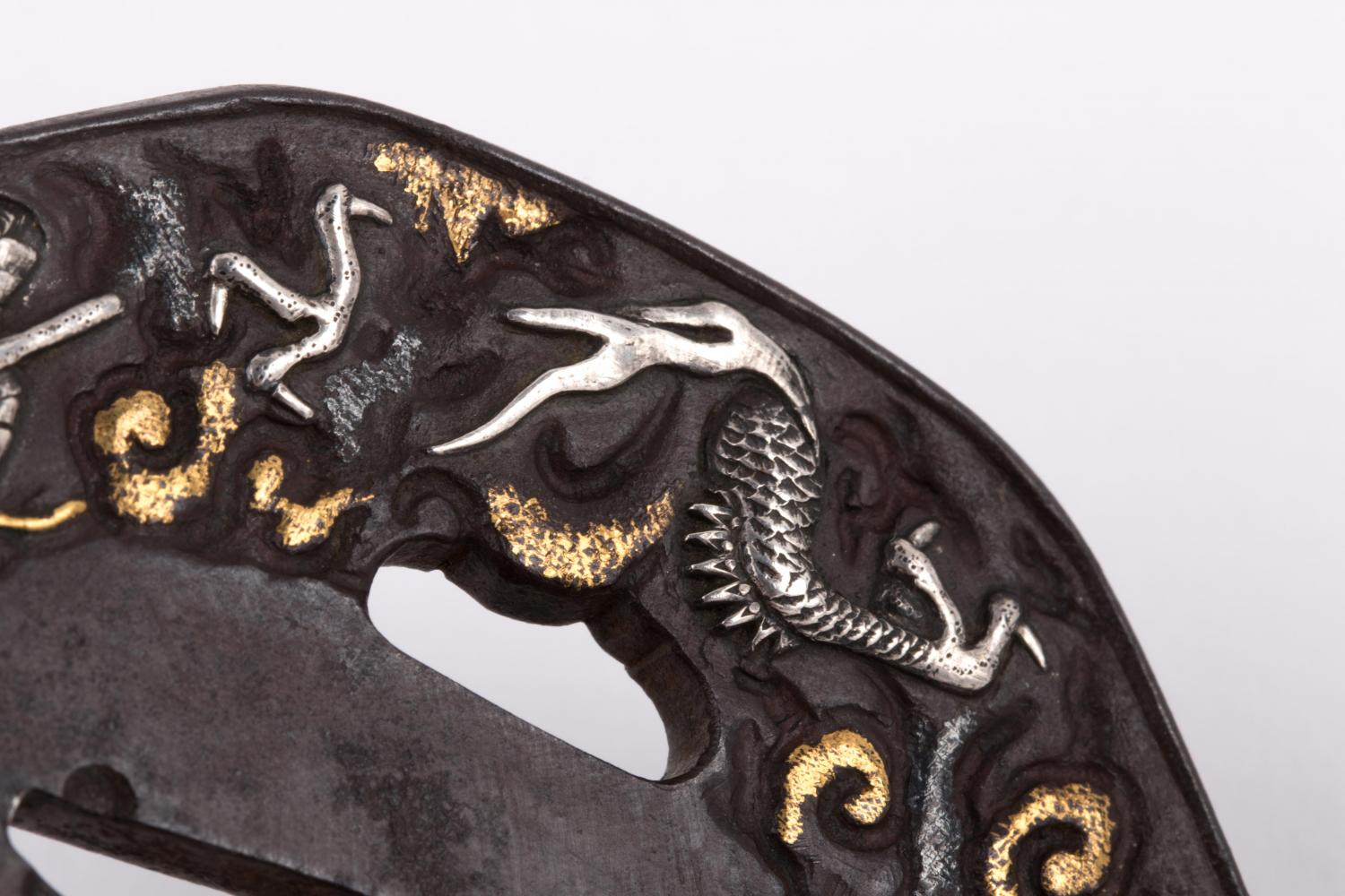

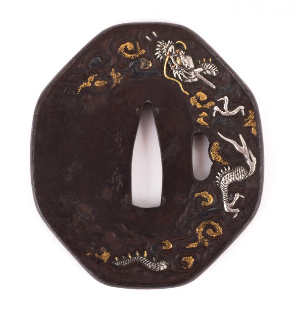

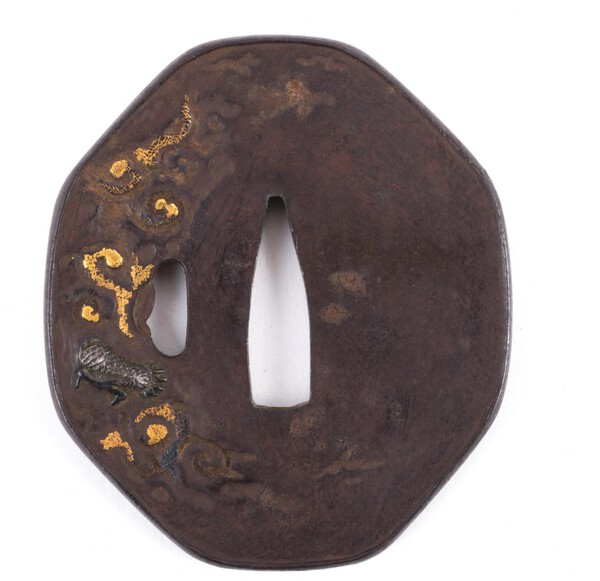

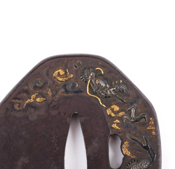

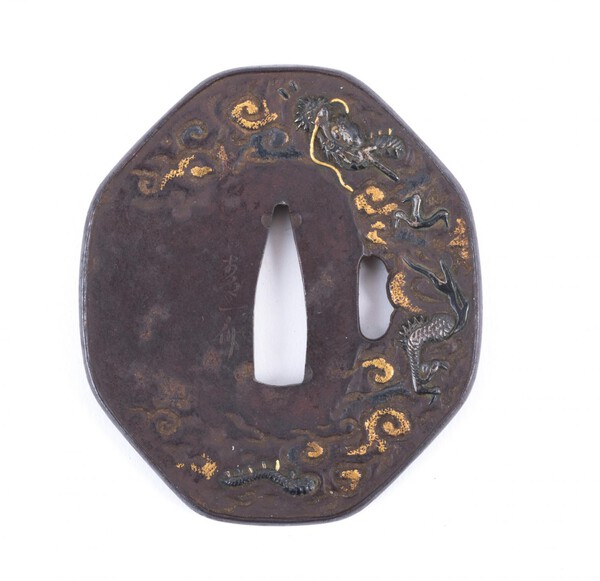

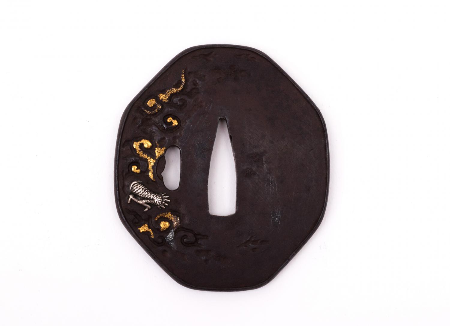

Here are pictures of this tsuba after cleaning. We decided not to touch the iron base. Just clean it together with the inlay.
This was a learning exercise so If possible please comment and be as harsh as possible. In the future I would like to avoid as many mistakes as possible.
Thank you in advance for all the comments.
This time pictures where made with strong direct flash light to show all the details and with reflected light to make it nicer to look at.
Dear Krystian,
I can tell that you worked hard on this, but you asked for our honest thoughts....  In my personal opinion (so feel free to ignore it), I think that it looked much better before you cleaned it.  One of the primary goals of cleaning this tsuba should have been to stop the active rust, but it appears that the tsuba still has active rust on the plate.  I would have just boned the active rust, lightly cleaned it with a soft brush, water and a very mild soap, waxed it lightly (using Renaissance Wax) and left the rest alone.  I imagine that there will be as many different opinions as commentators.
Thank you for your comment George. A lot of people think that I went to far with this one so you are not alone. I will remove the active rust. However I wanted It to look as good as those tsuba found on Yuhindo:
https://yuhindo.com/hagiya-katsuhira/
and other webistes with highest quality items. But It seems I went to far accorind to many.
Everyone has a favorite (bone, antler, ivory, etc.) but I like old ivory the best (don't want to kill any Elephants, but I think it's OK to use antique discarded ivory).  If you can find someone who tunes pianos, they may have some old ivory keys available.
