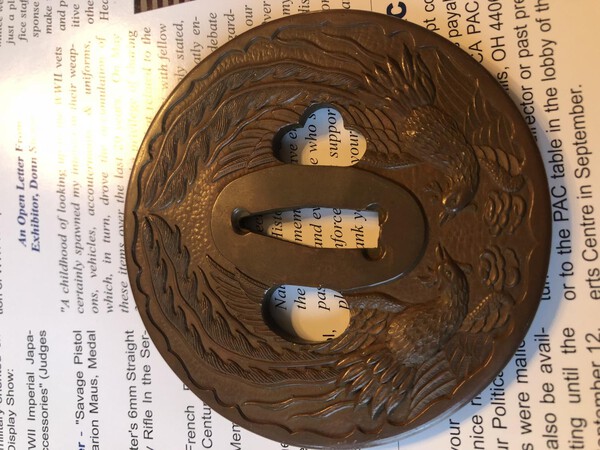

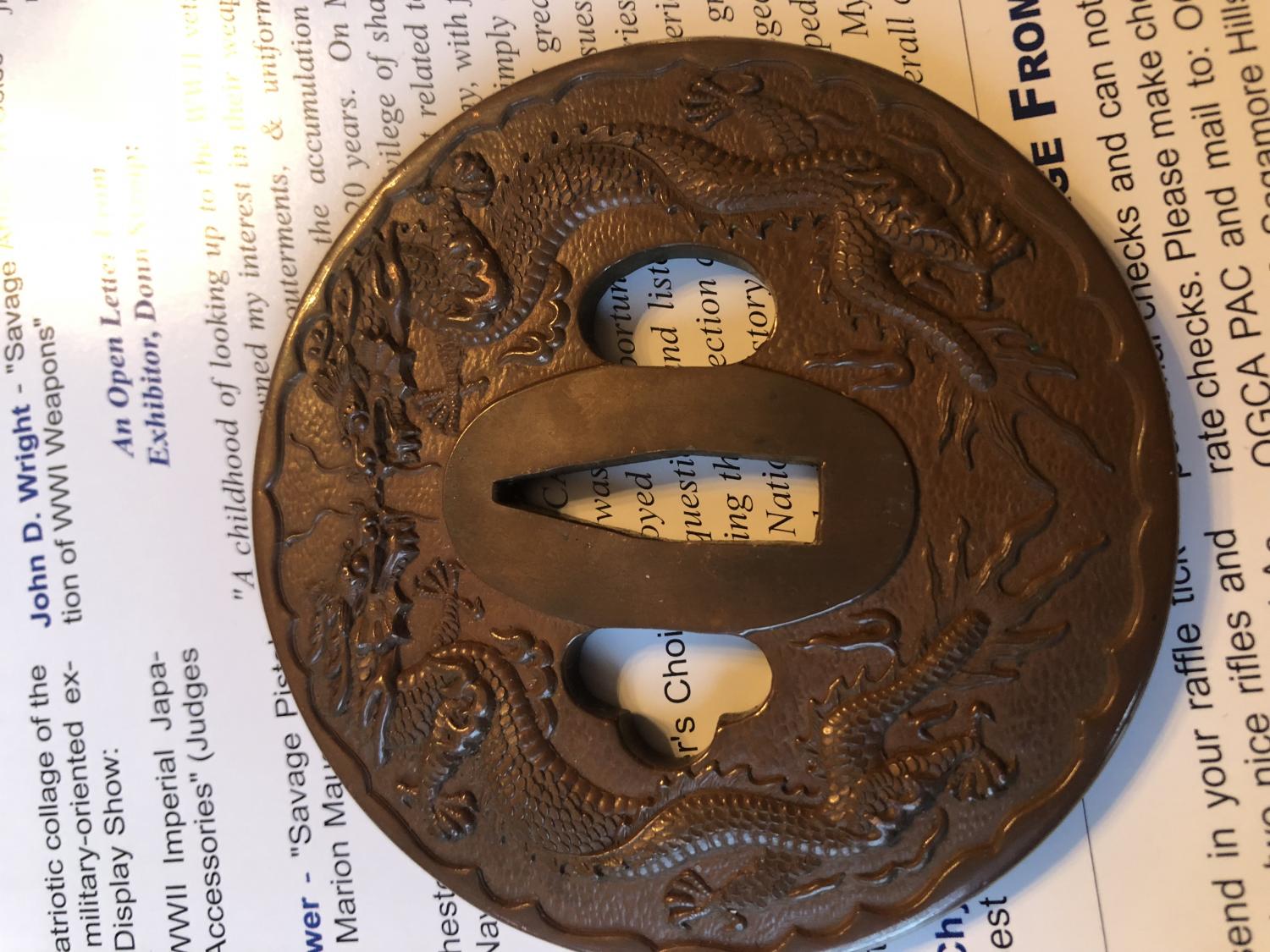

I did buy one but it was 15.00 for the stamped tsuba

i like Fred's over all the rest.

All,
not in the hand maybe looks good at 5 feet but then grab a 5x loop find under cuts find chisel marks the base of the tsuba has nothing no life !
again another watch out..... alot of fakes and the stamping is the base of the best out there

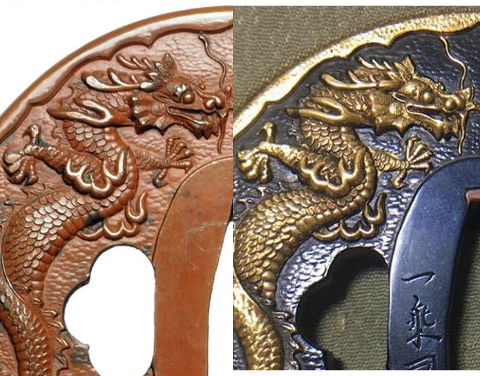

I'm not posting to inflame passions further but there is a specific detail I'd like to point out so that those who care to learn and 'with eyes to see' might be better armed in future encounters with pieces like the under discussion.
Referring to the handy images Henry composited for us, Thanks Henry (see...I'm happy to offer my gratitude  :laughing: )
I think most of us are in agreement that the tsuba was created by means of stamping.
Just as with coins, this process is designed to produce a raised impression that requires no further finishing of the metal surface. Colouring and plating.are obviously optional extras.
The most obvious clue that this tsuba was stamped is the background texture/finish.
When the die was carved they created a sort of indented texture all over the surface of the die on the area that would be the deepest on the stamped item. It might have been  simple hammer and punch work or even perhaps little divots carved out. Judging from the way some of the dimples are arranged in rows and sort of overlap each other I'd suggest a punched texture.
This indented texture will naturally produce a reverse impression, what we see here, an odd lumpy texture. And one that would be very time consuming and tricky to carve, not to mention that it's an effect we never see on genuine antique pieces.
While we might have to concede that whoever carved the die is fairly skilful but as the die was made to deliberately deceive the resulting piece loses any artistic merit or validity.  An honest reproduction poster of the Mona Lisa can claim more artistic credibility in that respect. As to any craft value inherent in the stamped tsuba-like-object,  I'd suggest it would be on a par with any cheap holiday curio trinket.
There is, of course a huge discussion to be had surrounding faking and forgery, and artistic merit etc. but having it here would be a futile exercise. There are a number of excellent books that explore the matter, written by real art experts and philosophers, one of the best, imo, is a collection of essays presenting many viewpoints from a number of specialists. The Forger's Art: Forgery and the Philosophy of Art. edited by Denis Dutton. I'd also recommend his, The Art Instinct: Beauty, Pleasure, and Human Evolution.

Just to be 100% clear, are we saying both are stamped copies, or only one?
I notice the scales on David's appear sharper than the other. Or is it just the lighting? I assume what looks to be undercarving is also an optical illusion?

both stamped Brian, and almost certainly a few more out there. I think the apparent difference may simply be that David's tsuba is a better image. But you'll notice some flat areas on the high spots too, the left claw and flames etc. That's where the die didn't quite press down far enough to leave a full impression. That's why it's pretty level and flat, not rounded over as would be the case if it was wear from age and handling.
Both with different degree of customization. Signatures look fine in general but they are copied/scanned from a source and laser engraved. I’m 100% sure neither Ichijo nor Kiyotoshi has ever produced such piece in their career.

Alex,
my partner regularly has jewellery work she produces laser engraved and our hallmarks are routinely lasered but I very much doubt these signature we done that way. More likely simply clever chiselling.

Could be.
To have someone chisel it would cost more than the piece itself :)
