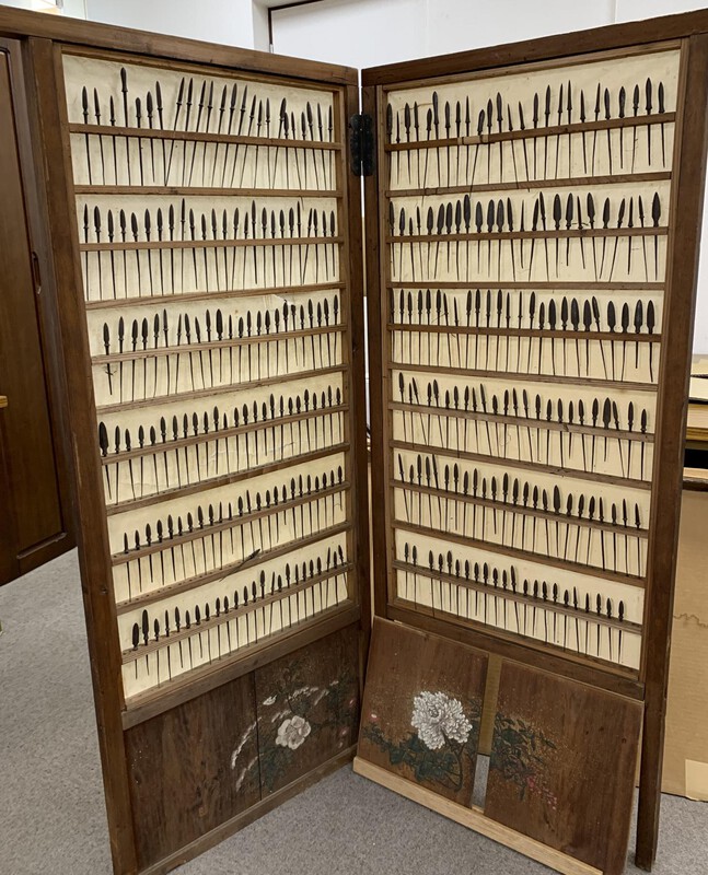

Bugyotsuji Posted June 24, 2019 Author Report Share Posted June 24, 2019 Right Jean, thanks for kicking the ball! 1. How about 300 yajiri displayed in someone’s Shoji? Mostly small, unsigned, of standard shapes, with relatively short Nakago. 7 1 Quote Link to comment Share on other sites More sharing options...

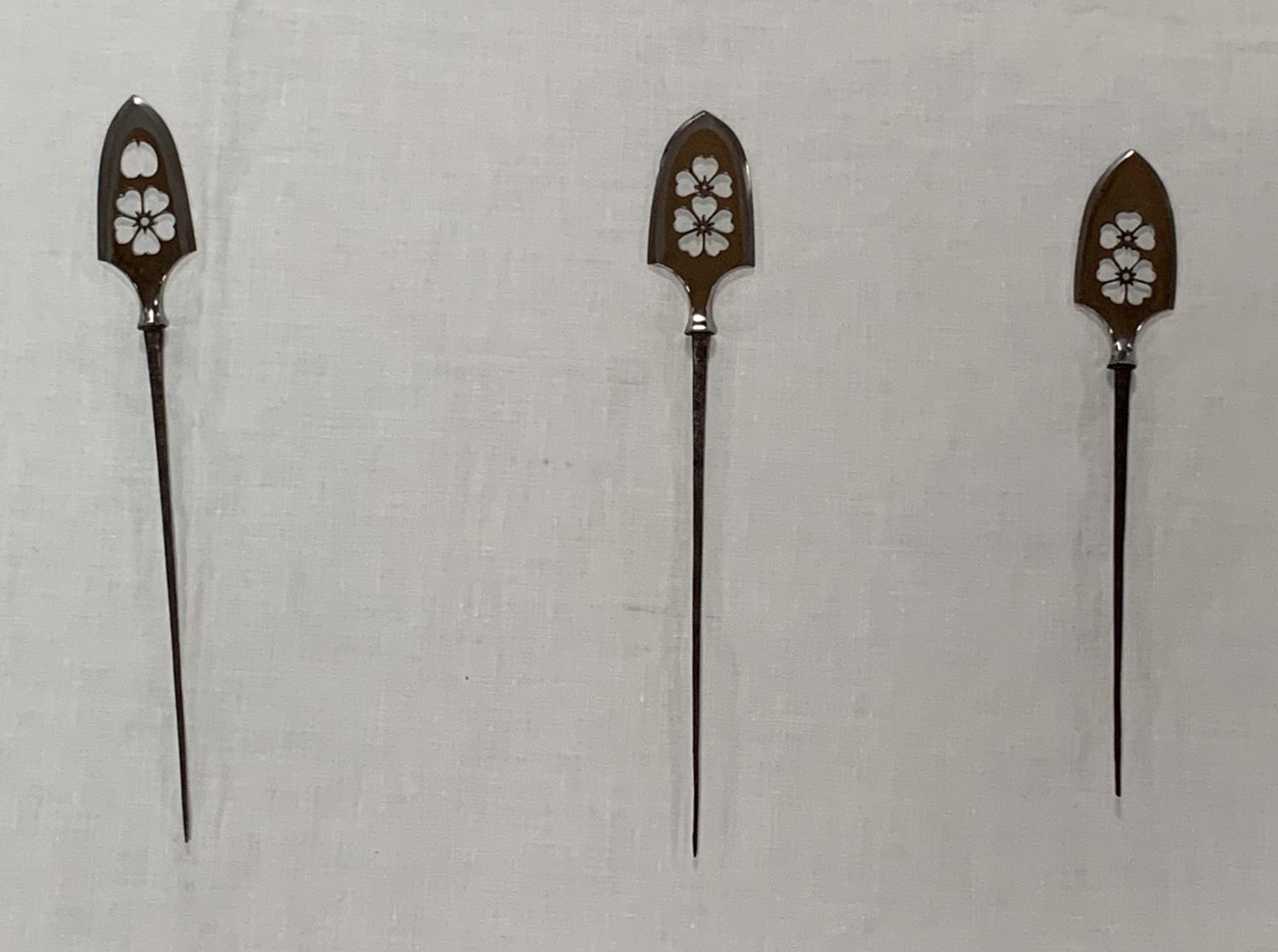

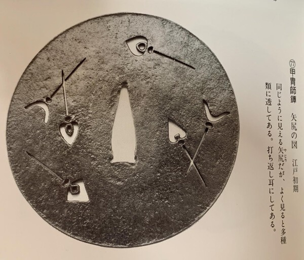

Bugyotsuji Posted June 24, 2019 Author Report Share Posted June 24, 2019 And here we have the other end of things, 2. Now, some might say that these are late Edo, Meiji or even more modern, but the NBTHK member and owner thinks otherwise. Interestingly, I found an early-Edo Tsuba (3) recently showing that these or similar were known some four hundred years ago. 2. 1 Quote Link to comment Share on other sites More sharing options...
Bugyotsuji Posted June 24, 2019 Author Report Share Posted June 24, 2019 As you can see, the Setsumei calls them 矢尻 ‘Yajiri’ and the Katchushi Tsuba is said to be early Edo. 3. 2 Quote Link to comment Share on other sites More sharing options...

Brian Posted June 24, 2019 Report Share Posted June 24, 2019 Piers, no fair!!Aaargh...that picture is killing me. Can't I just have 20 or 30? Wow....impressive. Would love a few of those. The simple "real" ones used in battle etc have an appeal. Love that display. At current market prices he has quite a fortune there too. 1 1 Quote Link to comment Share on other sites More sharing options...
Bugyotsuji Posted June 24, 2019 Author Report Share Posted June 24, 2019 Someone offered him around $3,000 I believe... To be quite clear, this is purely educational; none of the examples above are mine. Quote Link to comment Share on other sites More sharing options...
Brian Posted June 24, 2019 Report Share Posted June 24, 2019 Someone offered him around $3,000 I believe... Umm, yeah. lol. They can fetch $100 each, but even average examples have to be $40 or so each. So that is $12,000. I think someone was taking a chance. Quote Link to comment Share on other sites More sharing options...

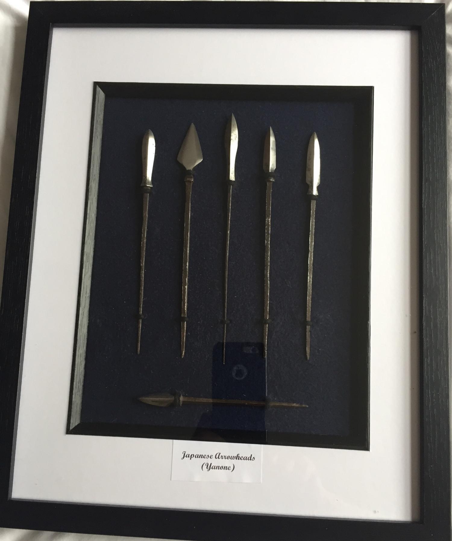

Beater Posted June 25, 2019 Report Share Posted June 25, 2019 And I thought my miniature screen was a novel idea...never mind! I’ve also got some more which I put in a more conventional picture frame. All this talk of fakes has me slightly worried but luckily I was almost gifted these, which were thrown in as a sweetener with a sword purchase. 4 Quote Link to comment Share on other sites More sharing options...

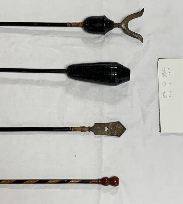

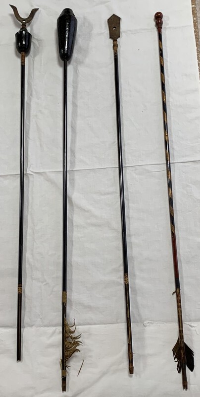

Bugyotsuji Posted June 25, 2019 Author Report Share Posted June 25, 2019 Kevin, are any of yours signed? I had a few, some really nice, but stupidly I sold most of them... In a minute I will upload a photograph of what is said to be a full set of four whistling arrows. All four notes were sounded in order for the start of battle, according to the owner. On the old box are the letters 蟇目箭 (Hikime-sen) which he has kindly transcribed onto paper for the shot. The only other set he has ever seen was in a private collection, gold lacquered and in pristine condition. 4 1 Quote Link to comment Share on other sites More sharing options...
Bugyotsuji Posted June 25, 2019 Author Report Share Posted June 25, 2019 PS Just found six assorted arrows in a box that I had completely forgotten about. Nothing stunning unfortunately. And maybe in the UK I still have two fairly nice biggies with sukashi which came from a fantastic collection in Shikoku that my friend bought. He kindly allowed me to purchase just these two as I was a witness to the transaction! Quote Link to comment Share on other sites More sharing options...

Beater Posted June 25, 2019 Report Share Posted June 25, 2019 Kevin, are any of yours signed? No sir. Quote Link to comment Share on other sites More sharing options...
Beater Posted June 25, 2019 Report Share Posted June 25, 2019 Hi Kevin, where did you get those framed?, looks good Thank you. It’s a very cheap DIY job. I bought the frames in “The Range” for under a fiver, stuck felt to back board and drilled small holes for elasticated thread to hold them in place. 2 Quote Link to comment Share on other sites More sharing options...
Beater Posted June 25, 2019 Report Share Posted June 25, 2019 Kevin; some of yours look to be not Japanese, but I am looking only at photos.... . Ok, thanks for letting me know. I knew absolutely nothing about them but as they were just thrown in to a sword deal, I haven’t lost anything. Can you indicate which ones and I might consider a cull. Regards, Kevin. Quote Link to comment Share on other sites More sharing options...
Bazza Posted June 26, 2019 Report Share Posted June 26, 2019 Kevin; some of yours look to be not Japanese, but I am looking only at photos.... . To my eye they are all Japanese. The variety of shapes in yajiri is amazing. My favourite is the curtain piercer... BaZZa. 1 Quote Link to comment Share on other sites More sharing options...
ROKUJURO Posted June 27, 2019 Report Share Posted June 27, 2019 Kevin,it is not really safe to judge by photos, but I suspect (left photo, from left to right) No. 2 and 3 and the rightmost are late copies. Right photo: No. 2 and the one rightmost do not look genuine to me.I have seen (and had) a number of YAJIRI, and the authentical Japanese ones were almost always finely and carefully crafted. Their tang is quite finely forged and evenly filed down to a level and smooth surface. As Ian wrote correctly, the copies sometimes have no 'neck' between blade and tang, while their Japanese 'models' do show that feature. This round 'neck' with almost the same diameter as the shaft is an important feature in arrows as the YAJIRI can only penetrate armour and bodies properly, if the impact of the arrow-tip is securely supported and transferred to the shaft.In direct comparison, European arrow-tips are visibly less carefully made (while no less lethal) and were mainly disposable items. The common socket arrow-tip model for warfare was forged in 2 to 3 minutes a piece and often used without additional filing and finishing. But I have to confess that I have not seen hundreds of YAJIRI, so it could well be that there are also mass produced ones which were less carefully made.However, the patina of the arrow's NAKAGO might also be a good indicator for its age (and authenticity). 1 Quote Link to comment Share on other sites More sharing options...
Beater Posted June 27, 2019 Report Share Posted June 27, 2019 Hi Jean, I appreciate you taking the time to explain your initial thoughts and concerns about those particular yajiri. I do see the features which you highlight; both the neck and tang finishing. Many thanks for your reply. Regards, Kevin. 1 Quote Link to comment Share on other sites More sharing options...

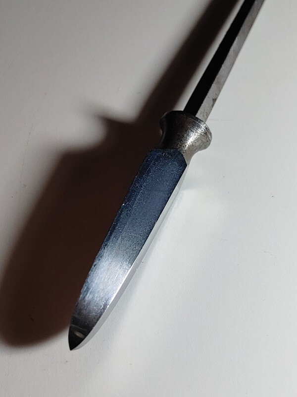

John C Posted April 18 Report Share Posted April 18 Reviving an old thread here: I was wondering what type of arrowhead this is? My guess would be target practice, but possibly togari-ya? It doesn't seem to match the standard styles. It's actually square shaped. John C. 2 Quote Link to comment Share on other sites More sharing options...
ROKUJURO Posted April 18 Report Share Posted April 18 In my opinion, this is one of several types of battle arrow-heads. The cross section can be square, but mostly it is rhombic. The YAJIRI for target practice are round and have no NAKAGO (cap type). 3 1 Quote Link to comment Share on other sites More sharing options...
